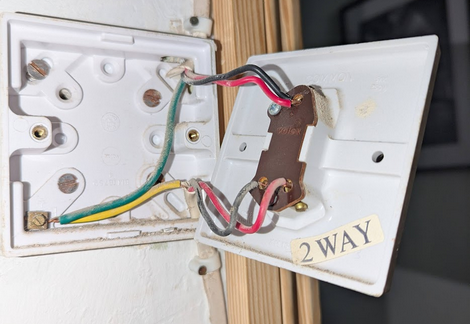

I have a light on the stairs with two switches: one at the top and one at the bottom. The bottom switch is also a double switch that controls the light in the back room, which works fine.
The problem is that while I can turn the stair light on with either switch, I can only turn it off with the same switch I used to turn it on. If I flip the other switch, the light stays on.
I've been going round in circles for hours and any advice would be greatly appreciated. Thanks!
Bottom
do you know where the old white cable joins the grey cable?

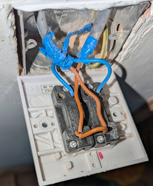

The 2G at the bottom needs 3 core and earth to function as a 2 way switch - so its a bit of a lash up.
Hey, thanks for your reply.
I'm not really sure where it connects, as I bought the house with the wiring already in place, and it just runs under the plaster in the wall.
So, based on what you said, are my only options to leave it as it is or rip it all out to replace the wiring?
Thanks :)
The third wire down, is the permeant line, and years ago it was common to borrow that supply from another switch on the plate, this was OK when we had just one lighting circuit, although fronded on today as it can cause radio interference. However, when we started to split lighting circuits, that method could no longer be used. I am guessing that is the case with you.
I will guess this switch 1741631525662.png should be an intermediate switch, but this switch 1741631601811.png has different colours, so there is clearly more to find.

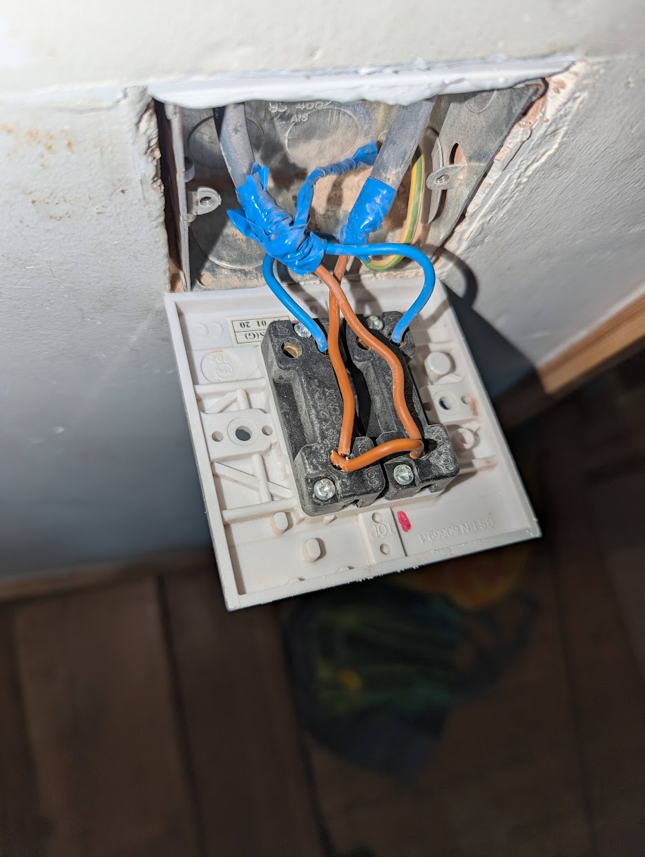

The downstairs switch has to be wired incorrectly, it only has two wires connected, any 2-way setup would need three. Considering how bad the newer wiring looks I wouldn‘t feel confident going wireless without fixing that lash-up. Time to lift some floor boards I‘m afraid.

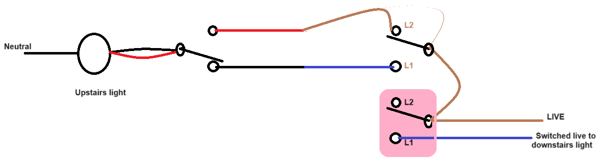

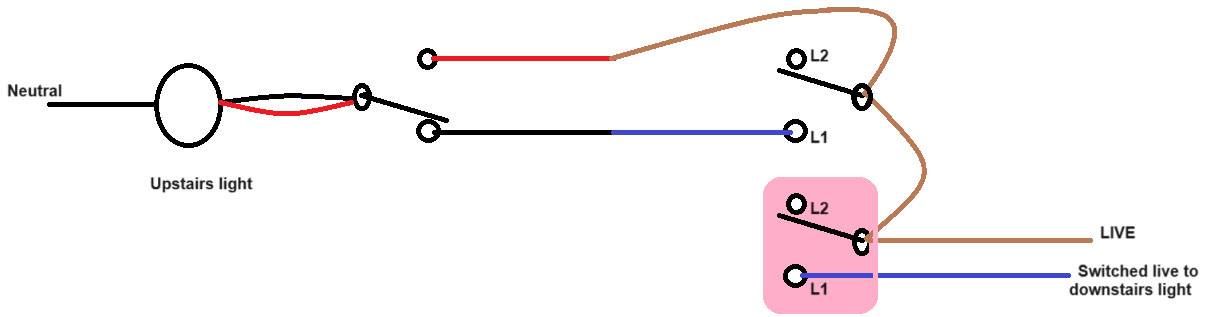

From your pictures and description; I'm making the ASSUMPTION you currently have this situation, I have omitted earth wires for clarity:
I suggest you initially follow Securesparks advice

The switch shown in pink being for your back room and working as desired can be ignored for now.
My guess: Somewhwere there is a joint between the red/black wires and the brown/blue wires, hopefully in the form of a proper junction box (or even an intermediate switch), although seeing the very poor way the downstairs switch has been wired I suspect the joint may be done to a poor standard.
If my assumptions and guess are correct; then I further assume that moving the brown wire from com TO L2 (on the downstairs switch for the upstairs light:
May make the system function as expected.

But the wiring is not the best, to put it politely.
... Considering how bad the newer wiring looks I wouldn‘t feel confident ... without fixing that lash-up. Time to lift some floor boards I‘m afraid.
This really should be investigated properly, potentially you have a "borrowed neutral" situation which could cause problems in the future: Do you have 2 lighting circuit breakers (or fuses) in your consumer unit (a pic showing the circuit breakers would be useful).
