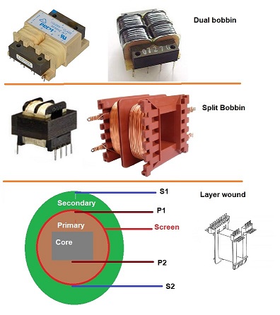

It could still need an Earth depending on how the transformer is constructed.
Failed insulation in the windingd can create a short-crcuit between the LV (230 Volt) and ELV (<50 Volt).
A Dual bobbin is the safest format.
