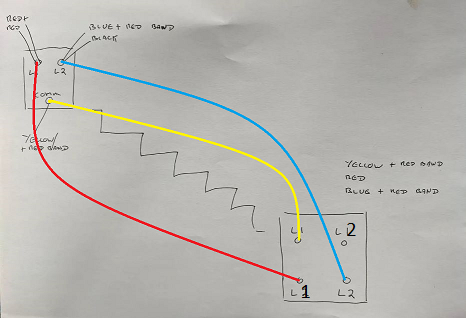

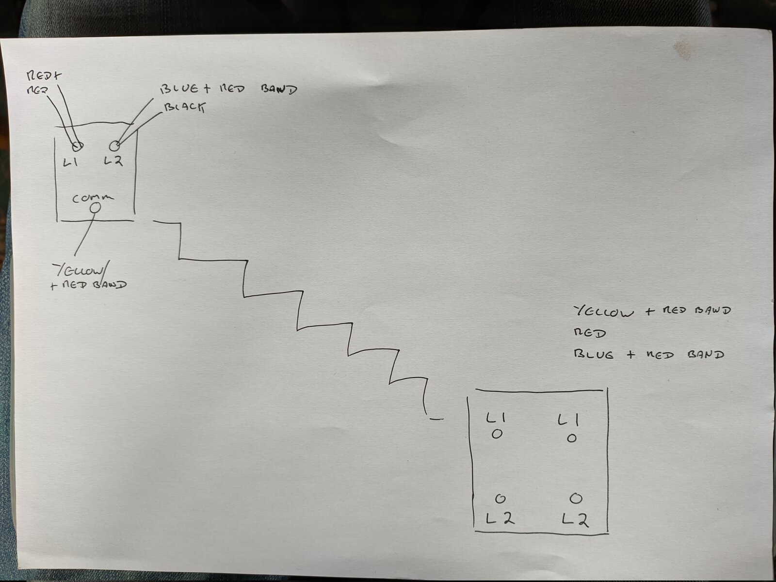

I've been doing a bit of wallpapering, and before removing the light switches, I took photos. Unfortunately the photos of the downstairs switch are corrupt and need a little bit of help if possible! I've wired in the top fine:
Upstairs switch
Comm - 1 x Yellow with red band
L1 - 2 x Red
L2 - 1 x Black with red band + 1 x Blue with red band
Downstairs switch
1 x yellow with red band
1 x red
1 x blue with red band
Inputs
L1
L1
L2
L2
Is it not that the L1s are on one side (left) and the L2s are on the other side (right); not top and bottom?
Just checked, 2 x L1's up the top, 2 x L2's at the bottom, the Mrs bought it from B&Q months ago - it's one of these 'snap on' fronts, it's an Intermediate Switch
Comm - 1 x Yellow with red band must be same with both switches, with an intermediate switch any terminal can be used as comm but the other terminal of the pair is then unused, so if it goes into L11 then L12 is not used, I always use my meter to test switch, the other two wires does not matter which is which.
Thanks Eric

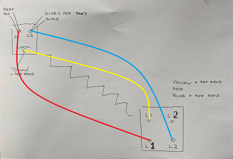

Just getting this wrapped around my room temperature brain, I'll put yellow with red band in bottom left L2
Looking at the top switch, I've got 2 x live going into L1, so I put the downstairs two red's into top left L1 too and blue into corresponding L2 under it?
