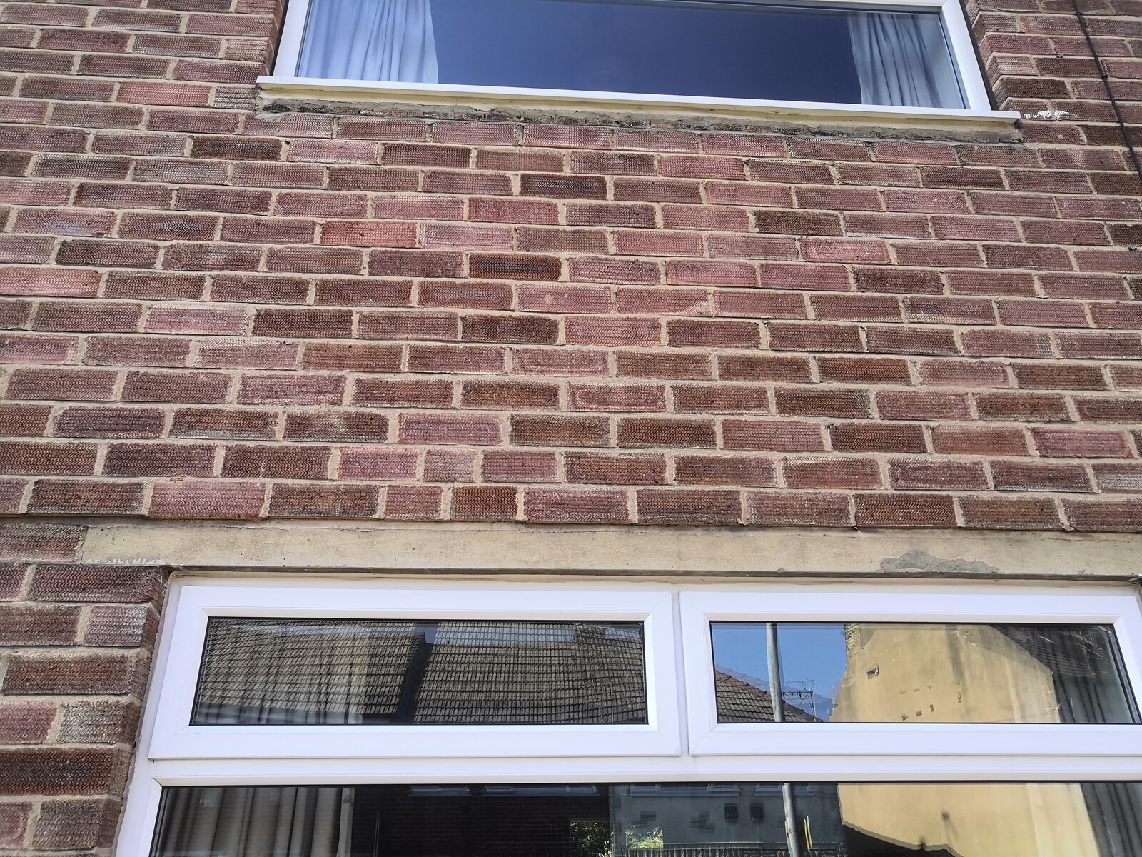

From the outside I can clearly see the concrete lintel above the windows.
I'll take a closer look at the surrounding brick work but looked OK.

Why not post interior & exterior pics of the lintels in question?
Are bays involved?
Have you put a level to the undersides of the lintels?
Hi, thanks for the tip on the level. All looks level on the outside.
It's not bay window in this instance.
I've put a pic of the outside ground floor front window. I haven't got any of the inside yet.
Buy the house.
Cavity walls have internal & external lintelling.
There are cracks in the conc lintel but no signs of sagging or associated cracks in the surrounding brickwork.
FWIW: Why not post the survey pics of the interior "plasterboard cracks"?
These issues are very common and no big deal - if necessary, in your own good time, you could have the lintels of concern replaced. A simple remedial job.

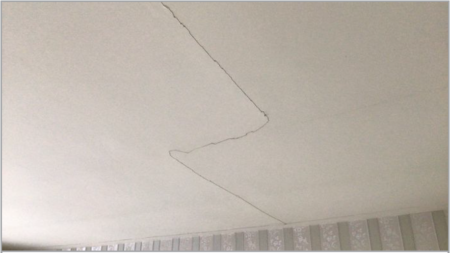

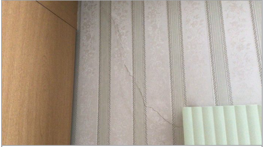

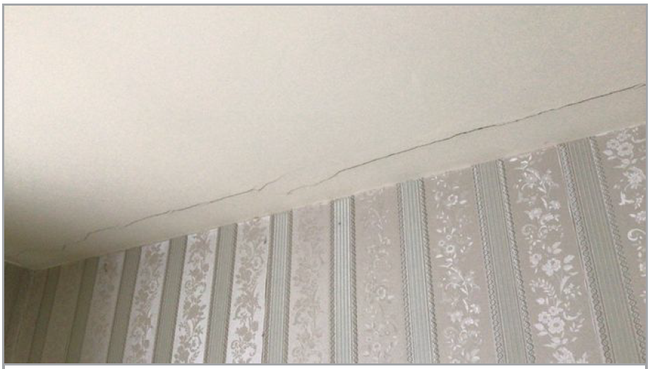

Here are pics of the cracks in the plaster:
Thanks for the pics but where are these cracks in relation to the earlier photos?
What/where is the papered wall - is it above any of the lintels?
The cracks are from the room above the lintel pictured earlier. The papered wall runs perpendicular to the window.
Hope that helps, I don't have loads of photos to hand and they're not great quality.
The points from your survey about lintels may need replacing and cracks on ceiling plasterboard are not connected - as Woody states.
