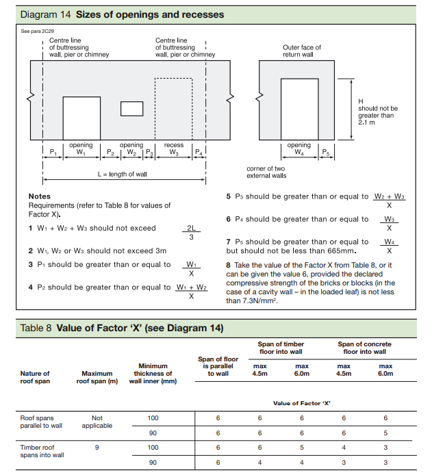

Never ever use a 254x102 UB as a lintel above a doorway. They are useless unless restrained as they are too slender and will buckle long before they reach their full bending resistance.
A 254x102 simply isn't sufficient for the span (my quick check indicates a 254x146x43 as an absolute minimum), but the other issue is torsion (which will mean a 254x146x43 won't work either). The load of the outer leaf on the plate will put torsion into the beam that 254x102s simply can't handle. I guarantee that check hasn't been carried out.
I'd be putting in a large rectangular hollow section (which rarely fail in torsion) and limiting deflection to around 13mm (otherwise there are potential issues with any doors under it).
The plate supporting the outer leaf also looks undersized - I usually either use a 10mm plate or get stiffeners welded in at 600mm centres that protrude the full width of the cavity.
It's also not possible to justify the 900mm returns in relation to Approved Document A, so for spans of that sort of size I always specify a wind post either end of the opening (see below)
Which begs the question "is he a proper engineer?"
Or did he put some figures into a website or pirated programme?
