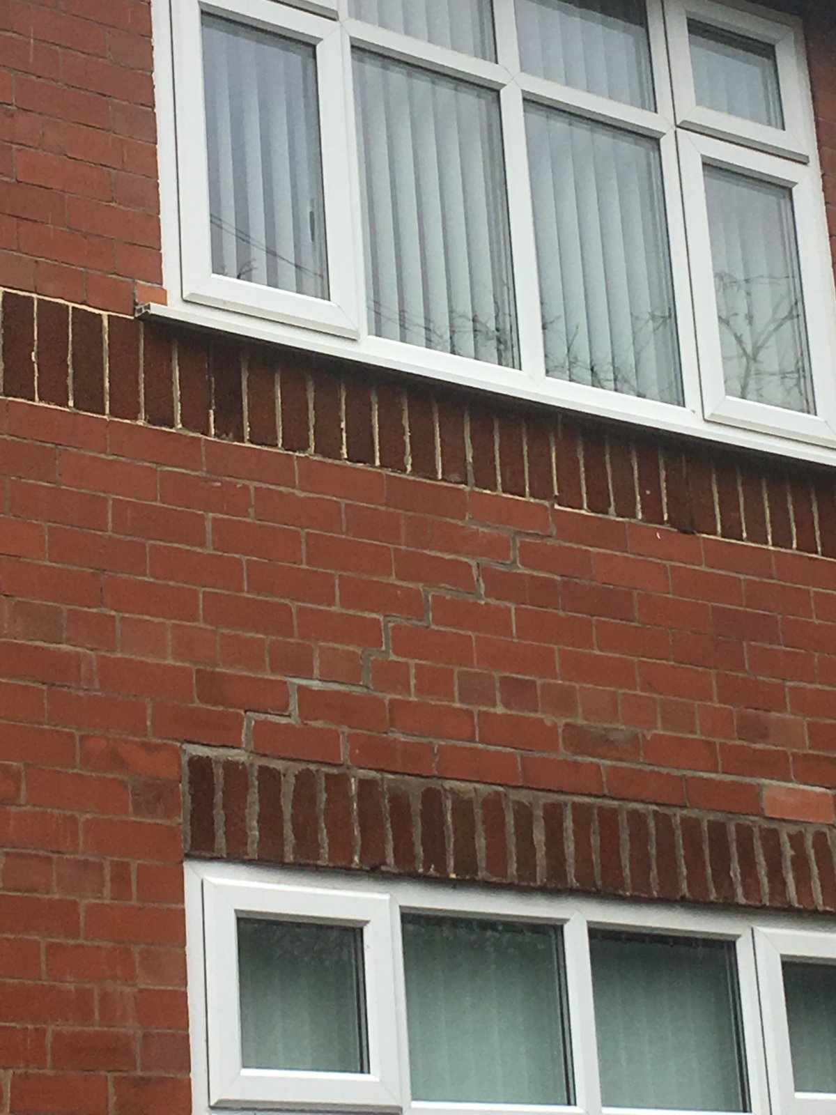

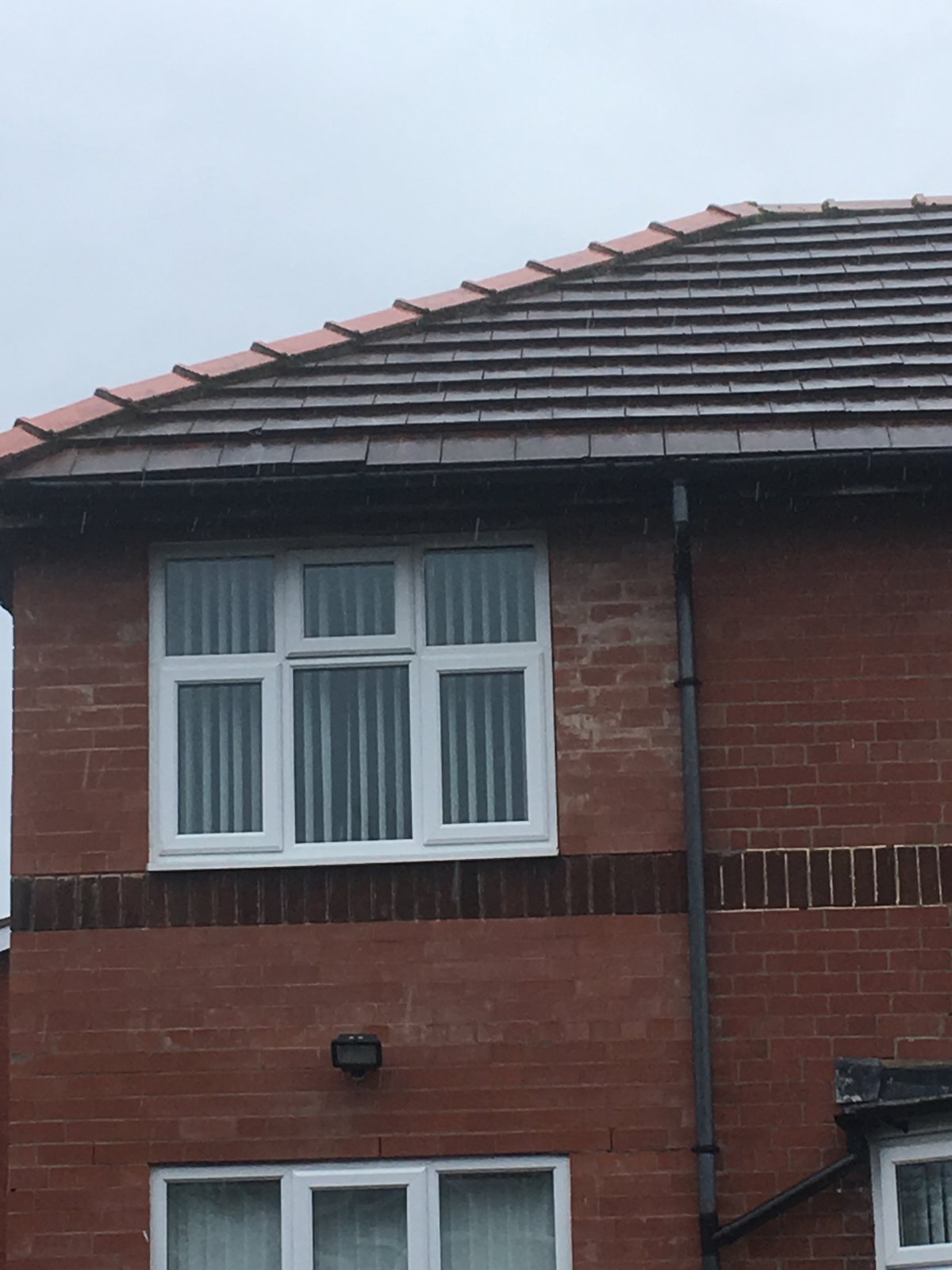

Hi, I’m interested in buying a house but worried about subsidence. There’s stepped cracks above the windows. I’ve uploaded some photos and was hoping someone could advise me before having to payout for a structural engineer. I’ve read that it could be wall ties or subsidence. I also noticed that the 1st row of roof tiles seemed to have dropped.

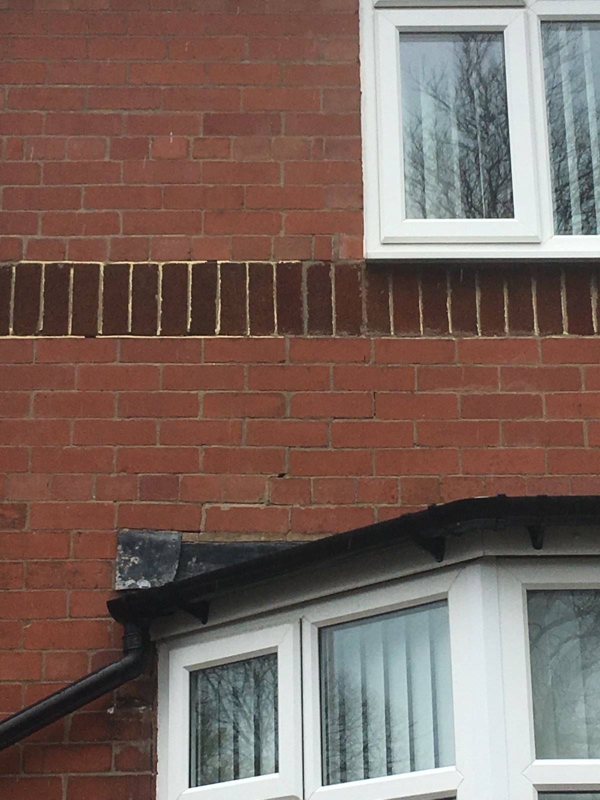

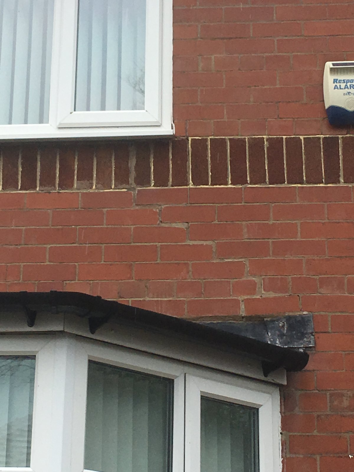

The cracking over the bay is due to slight movement or decay in the timber lintel which will be behind the flashing. The cracks over the other windows are due to the old, substantial timber frames being replaced by pvc, with no outer-skin lintel being added.
The mess at the eaves is due to the re-roofing not being undertaken by a proper roofer.

Is there a side extension? The second picture doesn't appear to have an external lintel going off where the soldier course finishes however the last picture without soldiers works in correctly for there to be a lintel this looks newer though thus thinking it's an extension.
Yes the left side was the garage and they extended the house in 2009 which is the last picture. The 2nd picture is part of the original house.

On the second pic down, where the bricks are 'upright' over the window, (aka 'soldiers') there is no lintel on the outer skin.
Would we need to have a lintel put in and replace the one over the bay? If so any idea how much this would cost?
