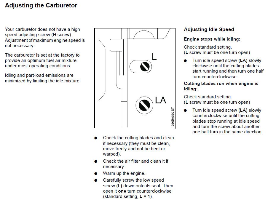

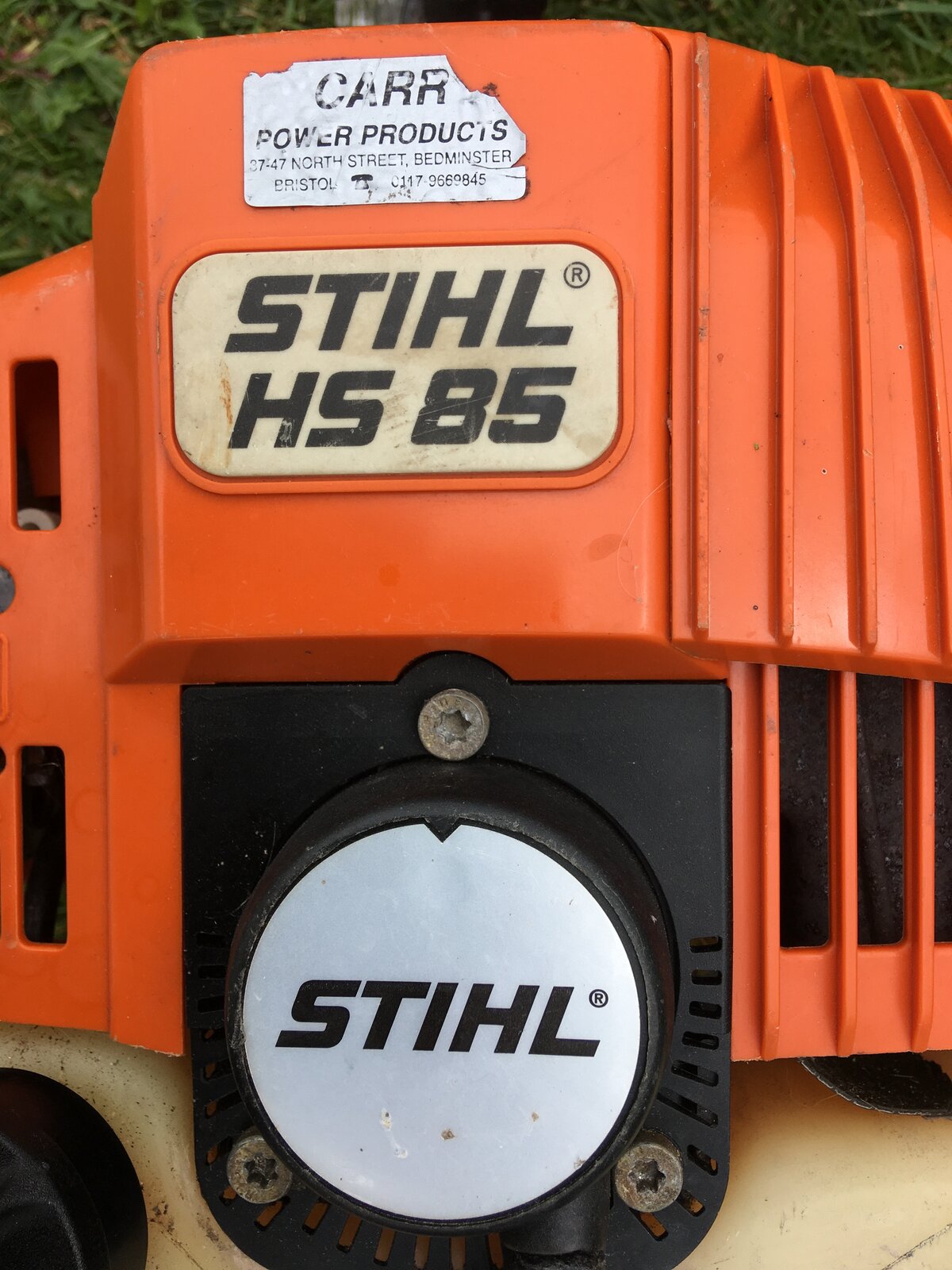

Hi,
I assume the carb is the original so some wear is expected.
I adjusted the carb what I thought was correct a month ago & did a hedge no problem.
Today I started it & waiting a minute or two for it to warm up.
I noticed that when I touched the throttle it was boggy & mostly died.
Playing with the throttle is little until it sounded ok I then gave it nearly full revs & started to cut the hedge. Hedge was only say 30 ft long & trimmer must of stopped / stalled / died say 3 time.
So I’ve adjusted it again like this.
L screw in until seated then 1 turn back out.
At this point I thought it was going to stall so now over to the LA screw of which i turned clockwise until the blades started to move then half a turn anti-clockwise.
I then took this short video clip to show you the result.
A bit boggy I think still so what’s you advise for which screw to now turn & which way.
Blades look fine when running so not bent etc & I’ve also lubricated them with spray oil. Gearbox grease replaced with the proper expensive Stihl stuff.
Video link here.

There isn’t a H screw.
There’s only L and LA
The manual shows L = 1
The adjust LA screw for blades to move them back off half a turn.
OK, so the L screw is the only one that you can juggle with which will alter the mixture......LA is the mechanical throttle stop screw.

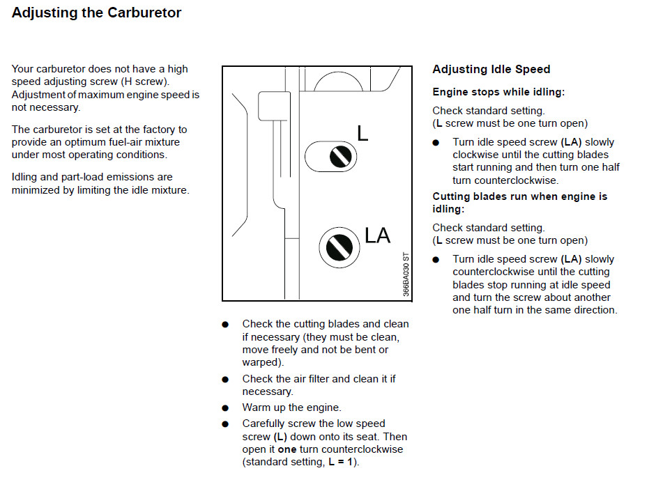

@Burnerman i attach the info from the manual for carb adjustment.
Not being rude but wondering if your advice for the LA screw is from knowledge of other carbs / tools ?

I'm pretty sure that LA is a mechanical adjustment but without a full picture of the carb I can't be sure.....I can't see why there would be two mixture screws for low speed running?
Anyway, the instructions are comprehensive so twiddling screw L is all you can do, but only by a tiny fraction of a turn.....less than 1/8th turn.

OK,
So is my current issue due to the mixture being to weak or to rich ?
Then do i screw in or out ?
The million dollar question, as the symptoms can be remarkably similar!
As the high speed running mixture is fixed, flat out running won't be affected at all.
I'd start by turning the L screw in 1/8th of a turn and see if the machine picks up better - this makes the mixture weaker
Then try turning the same screw out 1/8th of a turn - this makes the mixture richer.
John :)
