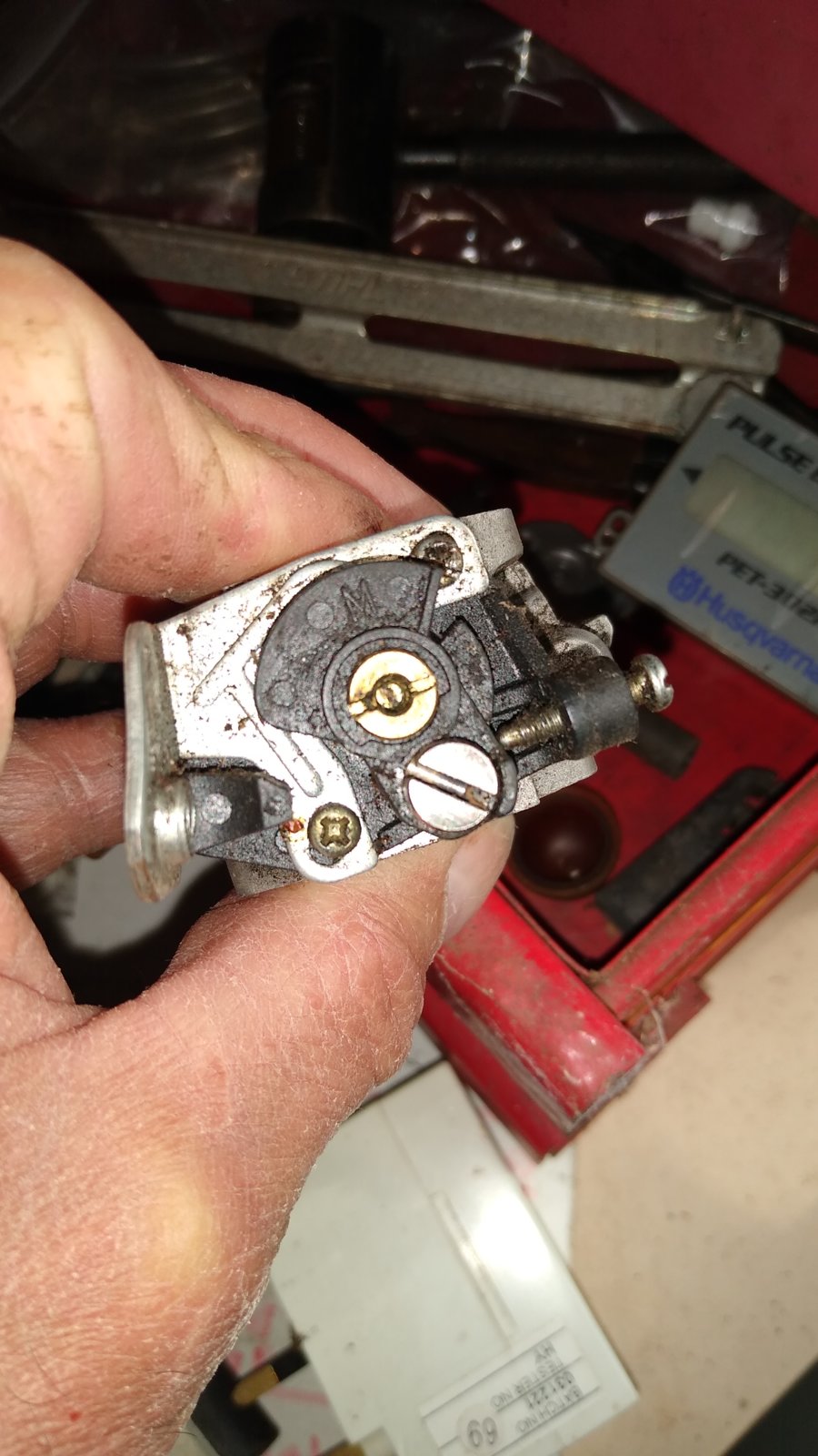

The only screw I might fractionally tweak would be the one on the first photo which should be the low running mixture screw.
There could be main jet adjustment but I’d need a shot of the top of the carb where the throttle quadrant is.
So long as the engine starts and runs well, just leave the original primer bulb in place!

These carburettors usually have a needle which fits into the main jet - they are adjustable to a degree and is usually done by a screw in the dead centre of the throttle quadrant. I may be able to advise further if you can photograph the very top of the carb, once on tickover and again on full throttle.
John :)
Screw right in the middle John is referring to but maybe hidden under a plug which can be a pain to remove
I guess that's one of your spares, LITL......and that's exactly what I mean!
