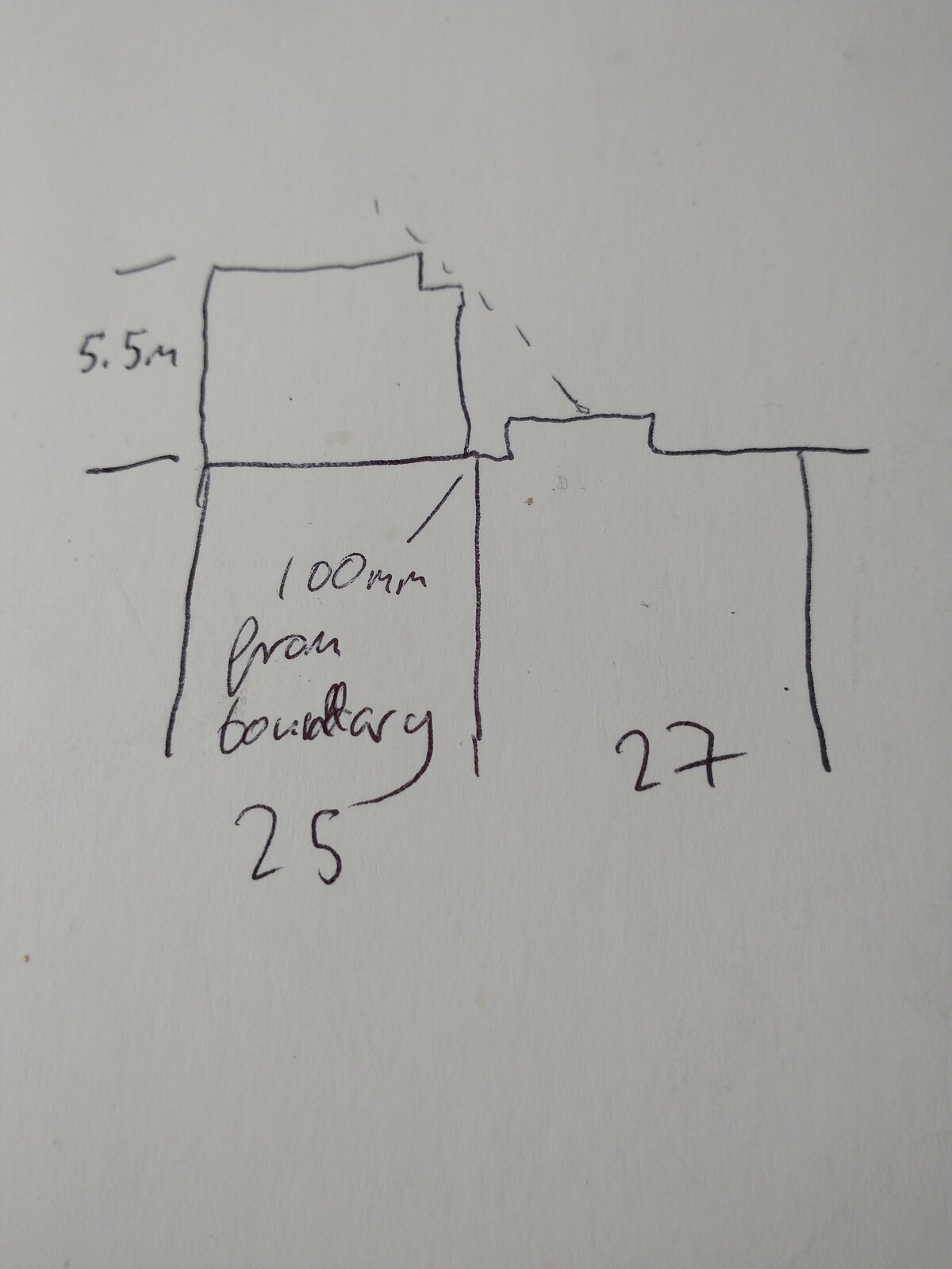

I did this:

Does your council operate a 70° rule? :cautious:

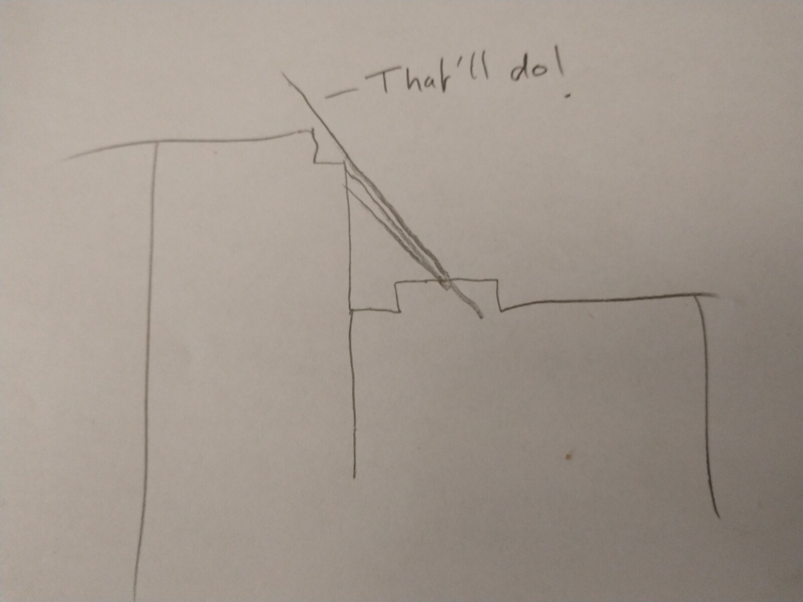

Not quite, but I do think the planning officer warmed to me a bit and not to my neighbour, who objected to everything and gave him the evil eye from his window while he did his site visit, to the extent he told me he felt quite uncomfortable!
At some point in the process I saw a copy of one of my drawings with a series of very faint rubbed out pencil lines drawn on it as if he couldn't work his protractor, a bit like this:
When the council process submitted applications, will they make contact with me to look at the site ? Trying to figure out how they can make their measurements correctly if they don't have access to the properties
Are you submitting accurate plans with dimensions and the 45° line annotated - which is typically part of the validation criteria which means they wont even register the application if the plans are not suitable?
But yes, then do come out.
His plans include dimensions and boundary lines but does not show the other property. I have never seen a plan showing properties on other side of the boundary hence no 45degree annotations
