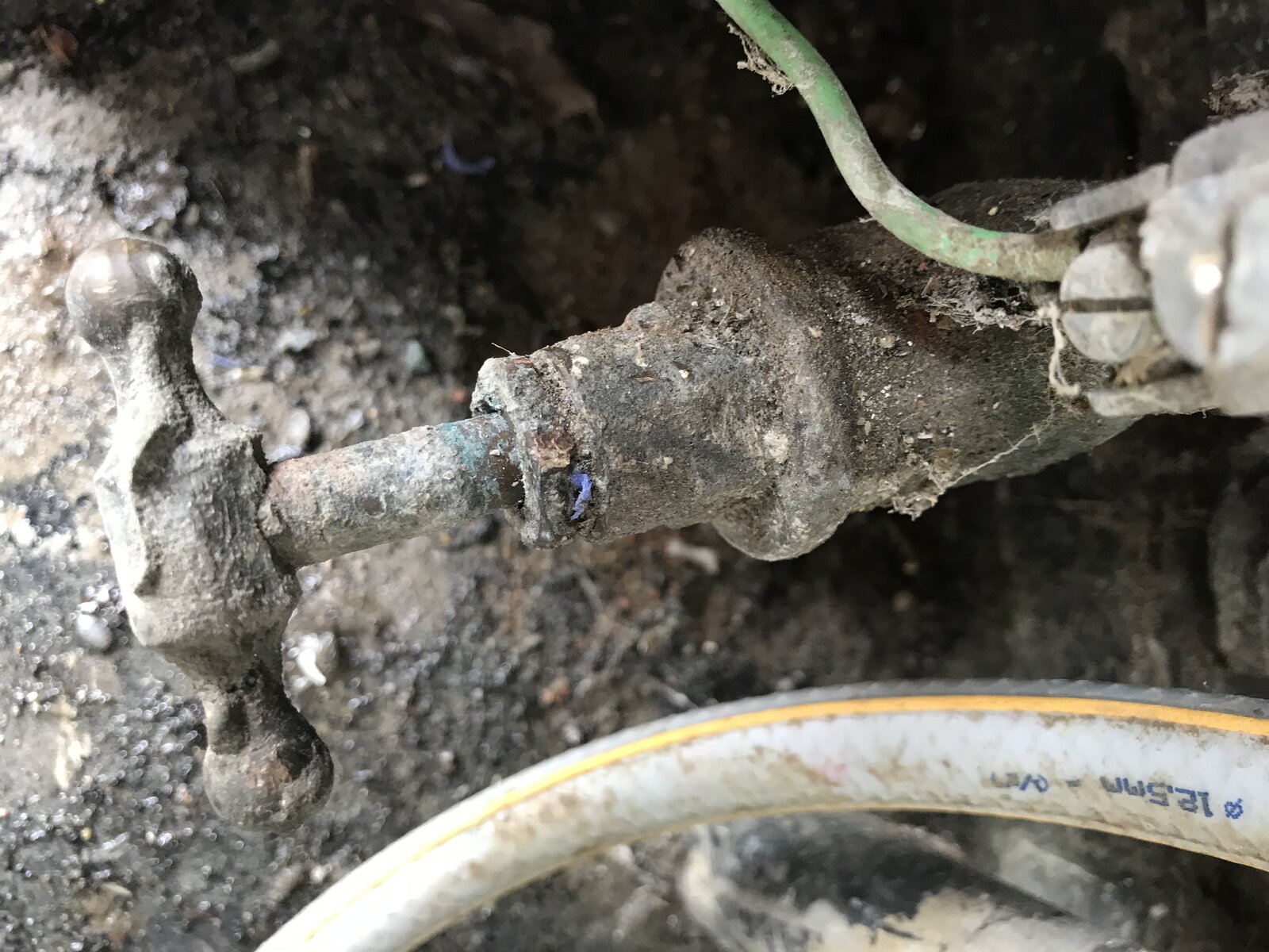

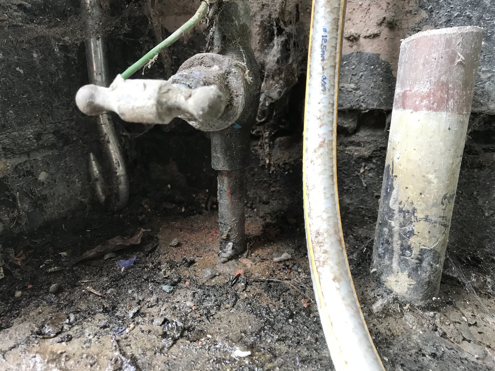

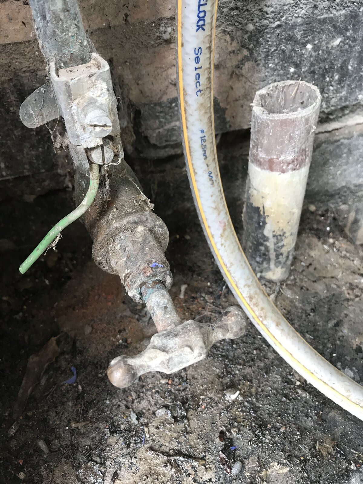

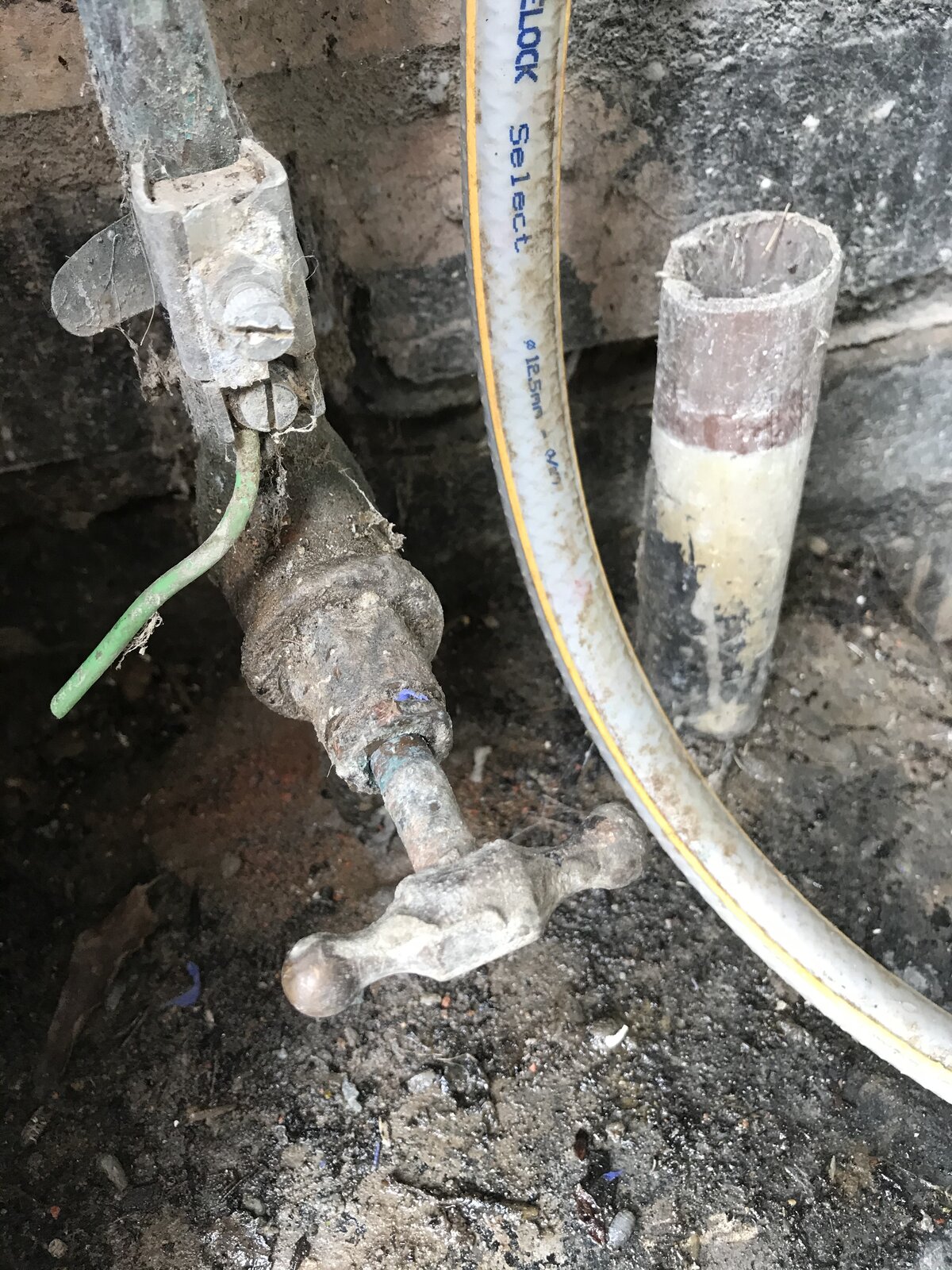

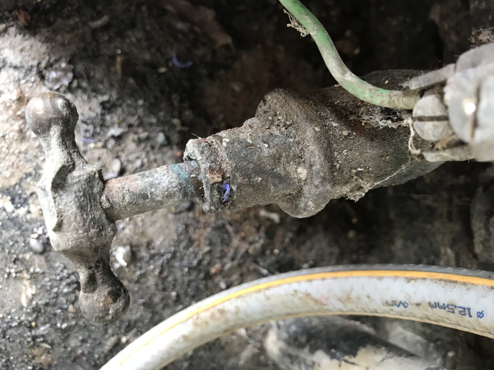

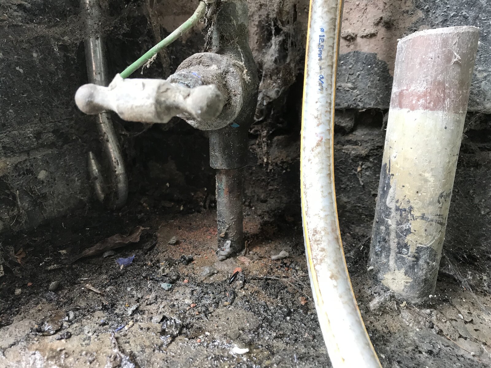

I managed to move the tap back and forth before it was then moving freely. I did apply a tiny drop of 3 in 1 on the thread - prior to reading @Madrab’s point above.
This freed the tap but it then started dripping from the nut near the spindle. I nipped this up slightly and it’s now stopped. My tap seems to be covered in muck. Possibly cement from when we had the extension work done. Notwithstanding the point above, can I apply some sort of solution to clean all this up? It will probably help with the reliability of the stopcock.
I was tempted to replace it but couldn’t get the stopcock on the pavement to work either. Will put a call into Thames Water
