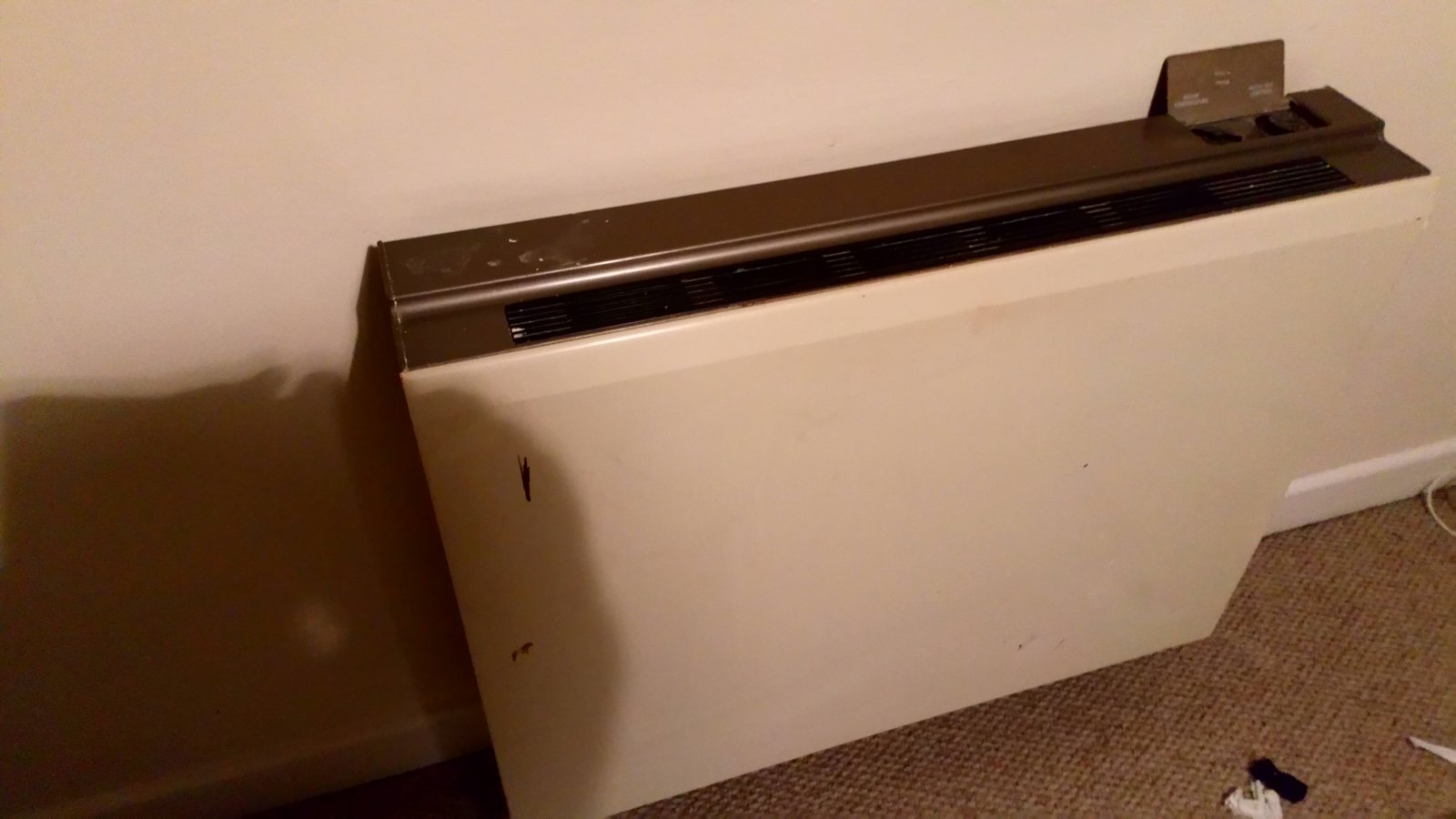

Was previously with British Gas now with Ebico. The heater is a Greda. Model number - 79055B. The smaller heater is a Greda model number 79045B

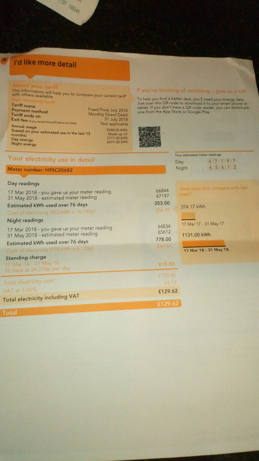

your old bill shows only estimated usage.
Please provide some recent Actual usage, relating to the period when you feel the cost is excessive.

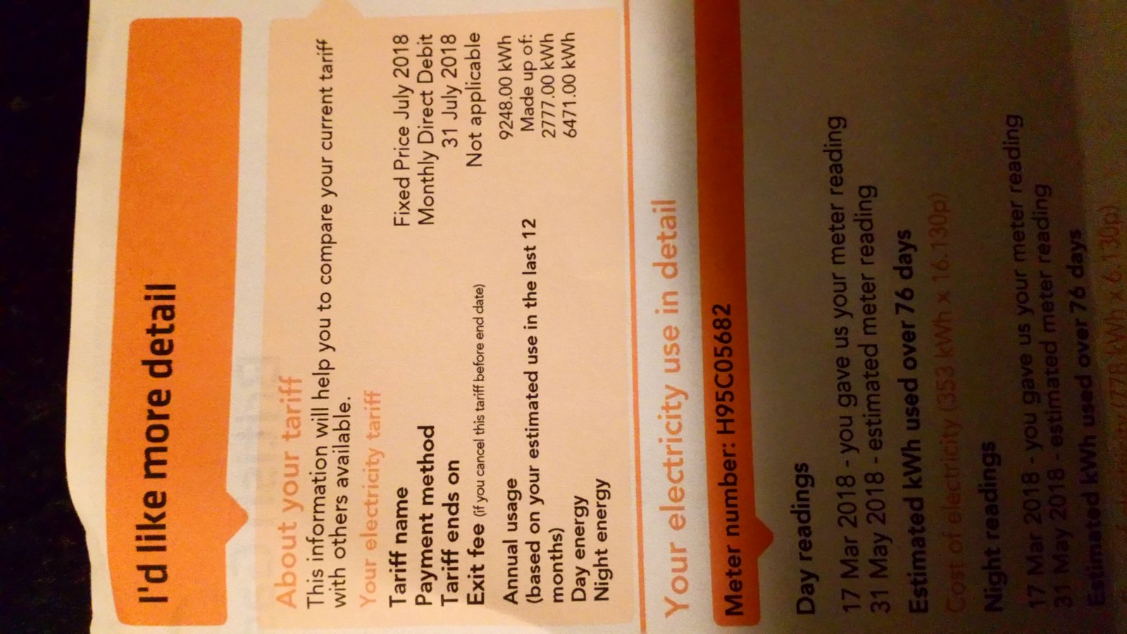

That bill is only an estimated one, so is of little value - but, even as it is, I'm not totally sure how it fits in with what you've been saying previously. IF the storage heaters are only taking power at night (cheap) rate, then that estimated bill says that they cost (at most, if nothing else was using electricity at night) £47.69+VAT for 76 days - which is about £19.09+VAT per month. That's about £20.04 per month (including VAT), which is very different from the £100/month you mentioned.
Even the entire bill for estimated electricity use during that period is only £104.63+VAT for 76 days, which equates to about £43.97 (including VAT) per month.
Are bills you've had based on real (rather than estimated) readings similar in size to this one?
