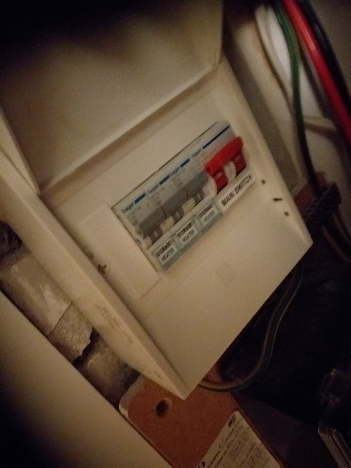

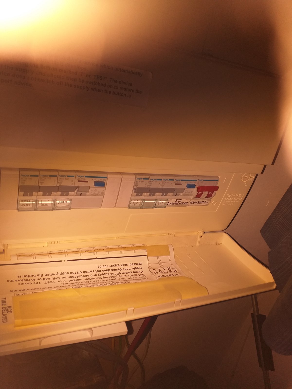

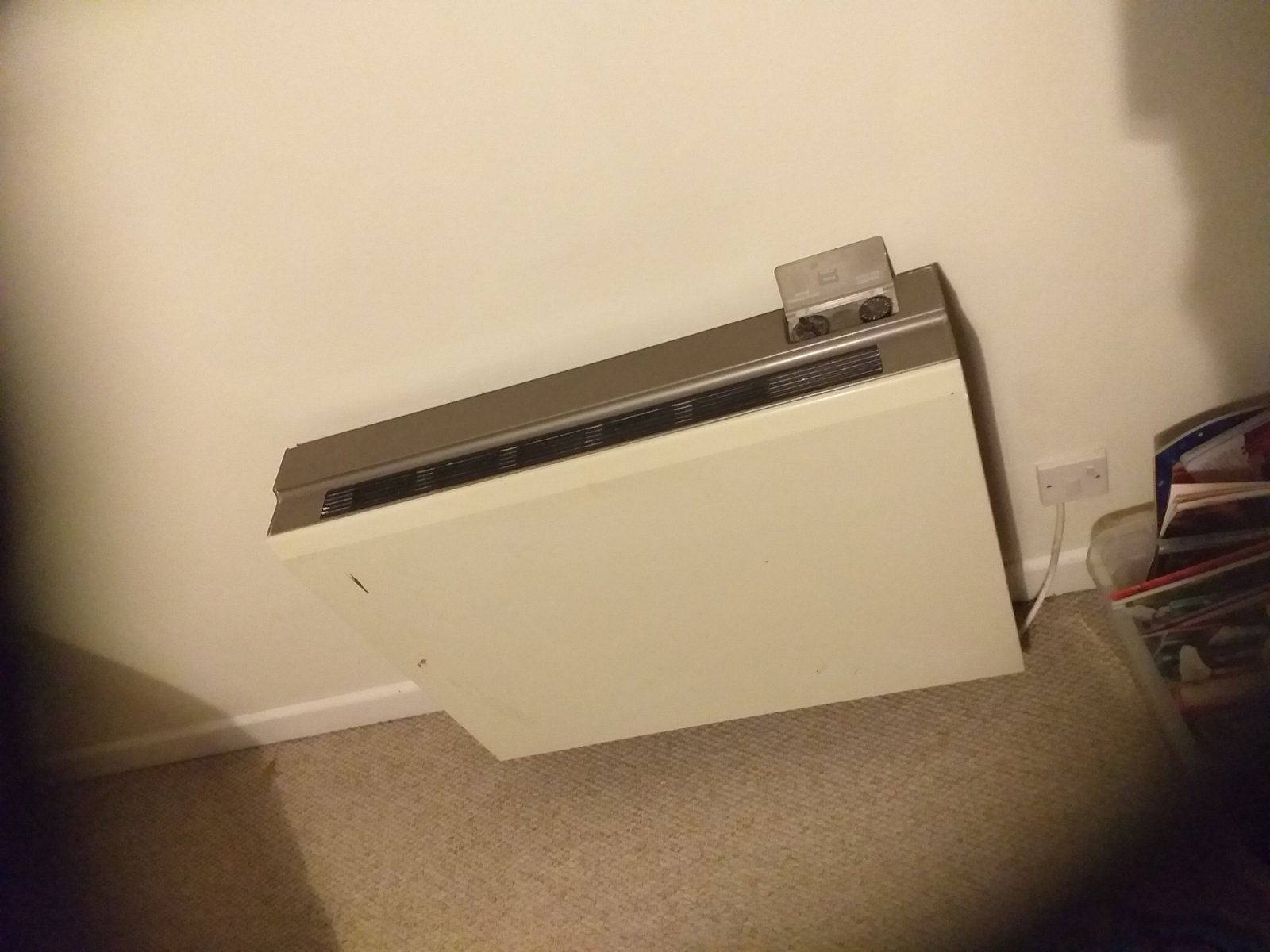

I've got two storage heaters in my flat. They dont seem to be working properly. The switch next to it wont switch off (in picture).
It was pushing out lots of heat at midnight teo days ago but very little next morning.
It isn't giving off heat in the morning (when it should be).
My kid did squirt water with a water pistol down it a week ago.
Any ideas?

Well this morning one was working fine while the other wasn't pumping out enough heat like it should
Start with the simplest, as you say the switch will not switch off it may have failed internally, which is not uncommon on heavy loads such SHs, after that the thermal trip/fuse may have operated, do you have any test equipment?

I took out fuse in switch , it's 13A it wasn't blown but wouldn't push back in place hook on back is broken. Also, on /off switch doesn't work. Decided to replace whole fuse spur thing. I guess if this doesn't work I'll have to replace heater.
When wiring it up I put mains into IN and heater's wires into out. Switched whole flat's electrics off to be on the safe side.
Keep wondering if this was caused by my kid squirting water with a water pistol down the top a few days before.
Time will tell

Yeah it did. I guess it was the spur plug thing.

The fused connection unit could be changed for a single socket outlet without any chasing. But the supply to the origin of the cable would need moving from the 'off peak' distribution board (DB) to the '24 hour' supply DB.
If you were to change the supply to the 'off peak' DB so that it becomes a '24 hour' supply, then everything else connected to it would also change to the '24 hour' supply. Which you shouldn't do if you intend to keep the other storage heater/s.
