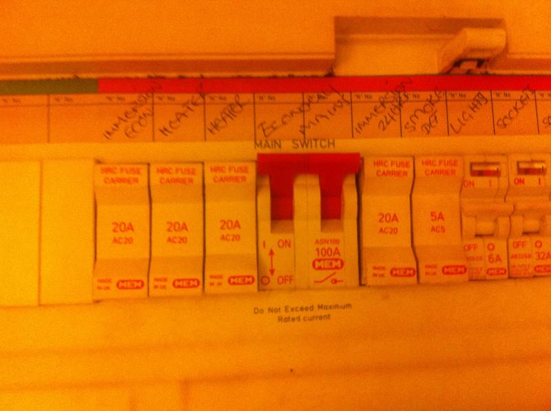

Hi!
I was wondering if anyone could help. I've just bought my first flat and having a bit of a nightmare with the storage heaters!
I've turned them on at the wall so they work with the Eco 7 however nothing seems to be happening during the night. The input is up high and output low until I want to turn them on but no heat whatsoever. The automatic heating is working but obviously costing me a fortune!
The Eco 7 switch IS working on the immersion heater so must be something wrong with the heaters
Any ideas?
I am a bit clueless when it comes to DIY/electrics etc so answers in plain English please! :)
Thank you all in advance!
Seldom more than 1 heater fails at the same time, Is storage heating consumer/fuse board switched on?.
Can you upload a pic of meter & consumer/fuseboard layout.
It does seem weird that both are broken at the same time, I'm fully expecting it to be something I'm doing wrong!
Images of the fuse box should be below, there are 2x bits for heating but 3 heaters (one of these is just an automatic heater with no input/output
Apologies for the bad quality - balancing on a chair with low light!
Can you upload pic of meter layout.
How would that help?
They say they have two storage heaters and immersion. Immersion works. Immersion and two heater fuses can be seen on the off peak side of dual rate CU.
Either both fuses are blown in the CU (the two on the right saying heater), which would be unusual, or more than likely, the thermal trips inside the heater have operated. It's not that unusual to find two tripped.

There are clearly TWO circuits for the immersion, one labelled "Immersion Econ", right next to the two that are labelled "Heaters". These MEM Dual Tarrif boards have two main switches - The left hand one here is supplying the off peak circuits. It's pretty clear.
The OP also clearly states "The Eco 7 switch IS working on the immersion heater".

There are clearly two circuits from that CU, one labelled "immersion" and one labelled "immersion econ", and that one being on the OFF PEAK main switch side of the CU. It is so clear.
Thanks for your responses although they might as well be in different language to me!
Are you able to suggest what I do to amend the problem? Perhaps replacing the fuses to see if that helps? If it doesn't do I just need to get an electrician in or is there anything else I could try myself?
Thanks!
Photo of storage heaters? Perhaps with cover removed, and a photo of the top left controls under the cover?
