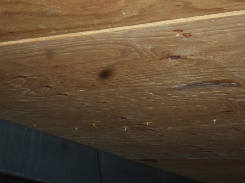

You may a good point there, the next problem is, we now have a leaking roof which is made up of plywood with Silka EPDM and have a 40 warranty. I've got a feeling the roofing company won't repair the roof because they've broken the Silka EPDM BBA specification, "you can only use light foot traffic and concentrated load on top of their membrane" and we have got 640 heavy concrete slabs on it!
Also I have noticed on their structural engineer report, 40mm plywood is recommended but it's 18mm plywood hence why the defection of the roof

If you look at the rough drawing, we will have no way of knowing if there's any roof leak because the rain will soak onto the ceiling tiles insulation at the pitch level, over time the plywood could rot away and the slabs come crashing through the ceiling?
http://www.docdroid.net/krzg/img-new.pdf.html
We do have a leaking roof and the only reason we know because there's a missing ceiling tiles and insulation above because of the pipework.

You can see the plywood is bending with no noggins
Surely the problem with those ply panels is to do with poor detailing and fixing. I would have thought the edges ought to be fully supported.
