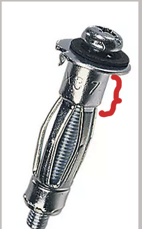

If you need a hollow wall achor these
are fine.
Note the picture is WRONG - the description tells you the "plain" thickness. You have 9mm + glue? + 9-12 for pb so 6-13mm won't do. They've used a file picture, the bit marked red will be longer for 16-32mm ones:
You don't need the inserting tool to "pull them up" if you use a leccy screwdriver.
I'd say that depends on how good your plasterboard is. There are a number of tales on this forum of "umbrella" fastenings spinning round and round and not biting. My next door neighbour even had it a couple of months back - until I loaned him my pull-up tool, then it was problem solved. I've had success most of the time in the past just using a screwdriver, but not always, so I just use the pull-up tool because it takes one of the potential "gotchas" out of the equation
