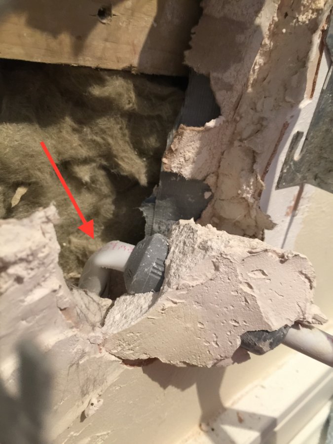

Here are a couple of pictures of the 'professional' installation. The kink is what I found behind a rad that was not working. We've only been in the house about a year and a half. I realise the service is overdue and will book it in tomorrow.

Just to reiterate - at this point all I have done is drain all the radiators, repair the leaking radiator valves, pump up the existing expansion vessel to 1.0 bar (whilst system empty) and refill it via the filling loop and added 1 litre of Fernox F3 via one of the radiators (and bled them).
I ran it for an hour last night and again this morning and it seems a lot better. The pressure is a lot more stable, the radiators are all working and no longer leaking.
