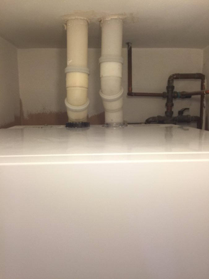

A big problem with Powermax and similar models is the flueing.
That needs to be inspectable along its length at the joints.
Anyone owning one should look up "flues in voids" so they understand what is involved.
Tony
Thanks Tony,
I've phoned a Gas Safe engineer today and told him what I did. He's said without seeing it's hard to say but SHOULD be OK until Baxi come out next month. (He can't get here any sooner himself).
I did read something about a problem with flues in voids. I think it said it was particularly troublesome on horizontal voids / ducts - I assume that's because it's easier for CO to get trapped - just guessing though!)
Ours goes straight out of the top of the boiler into the attic and then from the attic to the roof.

GS85, can you tell of that has had the updated part from the pic?
I wouldn't be able to tell tbh as I never work on them it's about the only boiler I always shift onto Baxi, they made the death trap let them fix it.
