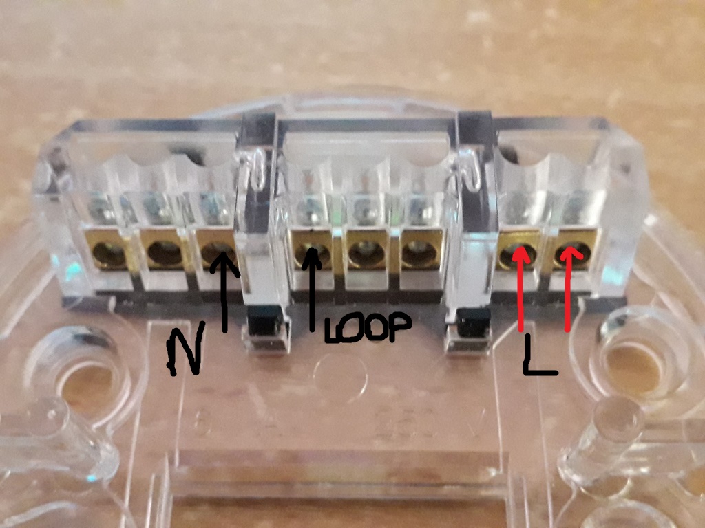

Stuck trying to replace a bulb holder

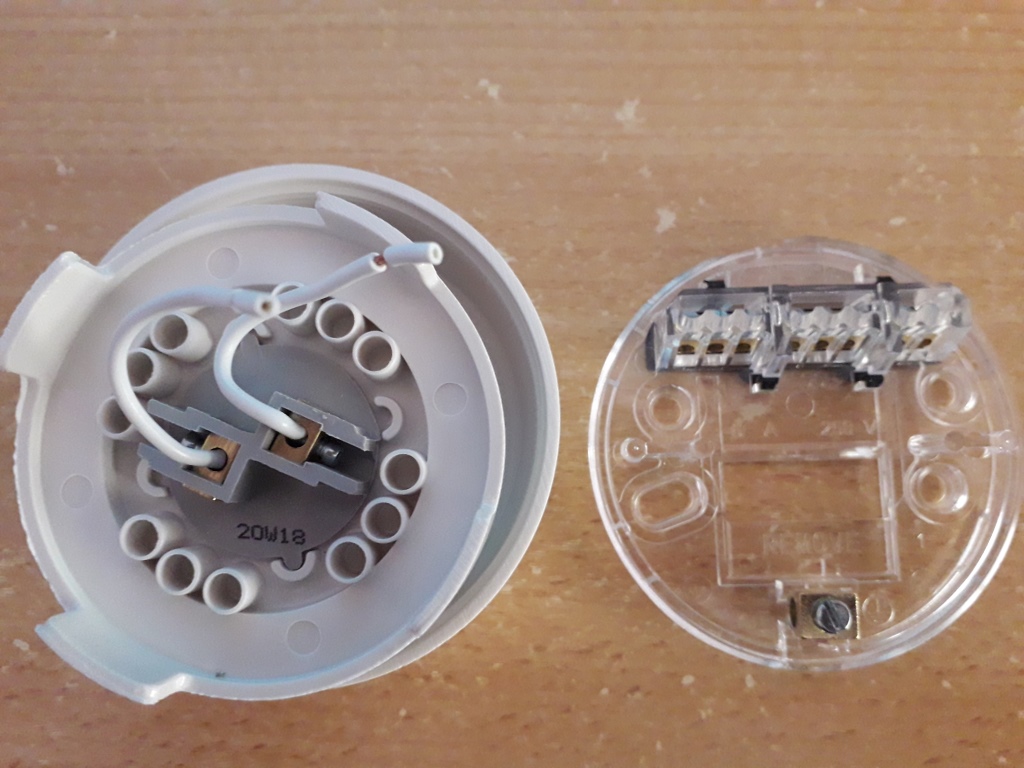

This is what the new holder looks like with two white wires of it's won.

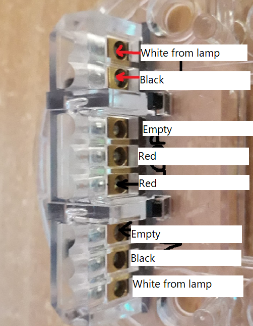

I am presuming this is how I am going to wire it. ( The instructions included was useless ) But, where do the white cables go ?
Sir Bernard, this hasn't quite worked.

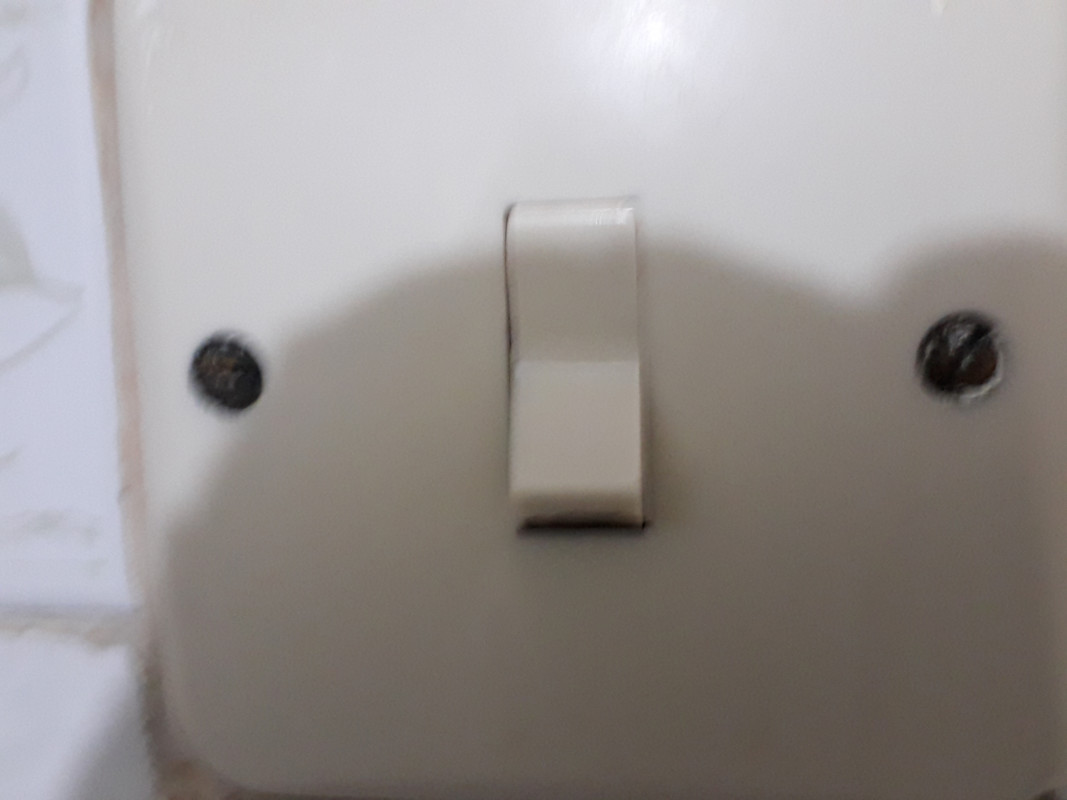

The light stays on now regardless of the switch being ON or OFF.

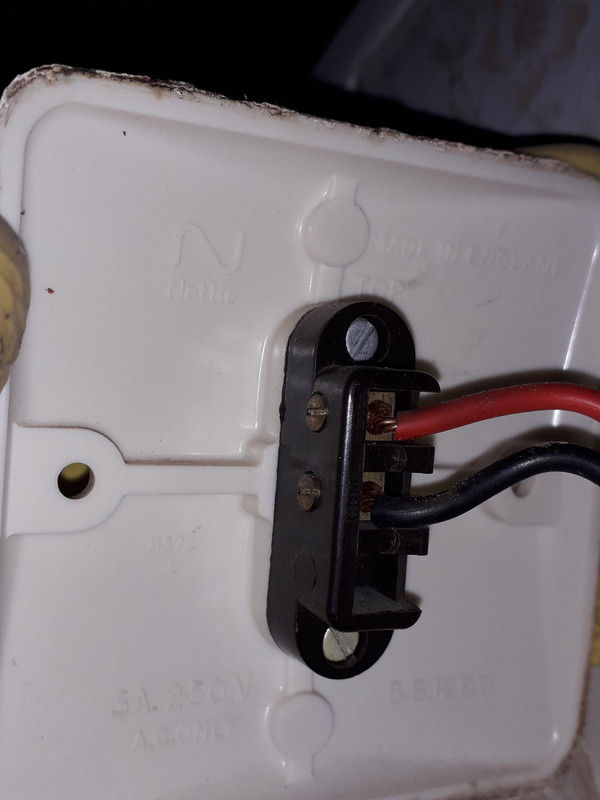

You may have fried the switch , earlier, when you caused a dead short when you tripped the breaker.
check the power in the switch,
if it is 'off' only 1 of the wires should be live
if both are live and the switch is in the off position the switch is faulty
Well, I unscrewed the faceplate and screwed it back and it's now working as expected.
