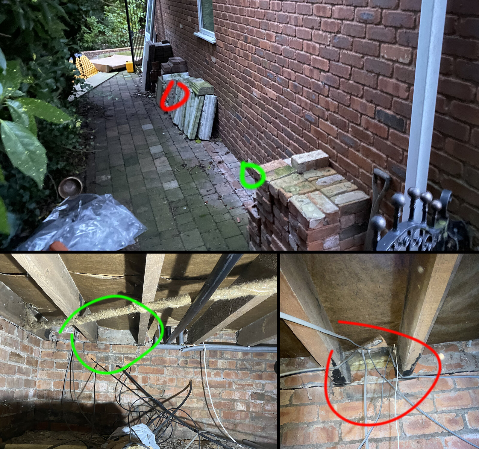

For ease of reference i've tried to show the positions of the air bricks on the birds eye plan below, along with the rough layout of the walls/honeycomb walls down in the crawl space. I'll show each one (and it's issues) below in numerical order.

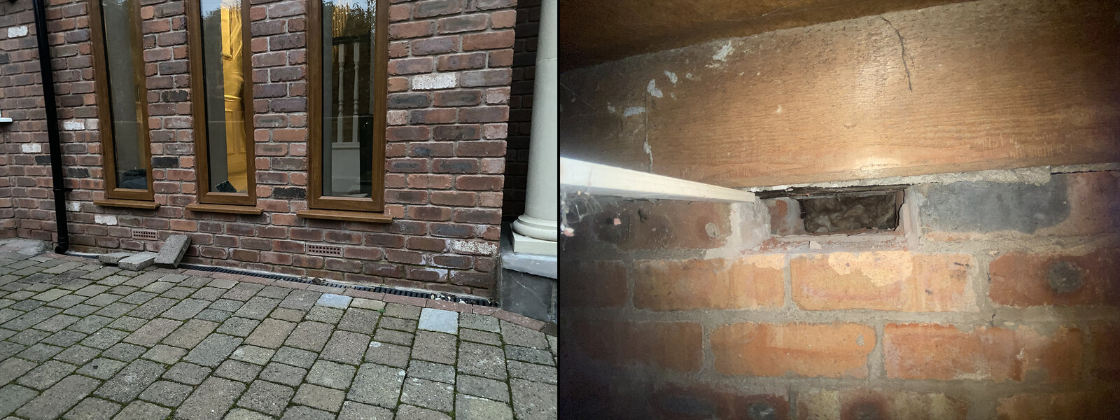

AirBrick 1
This one looks as if a front extension was done but no ducting was added, the new extended suspended floor is full of insulation meaning airbrick 1 is never allowing air into the property. I think the solution for this is obvious, needs some ducting, right?

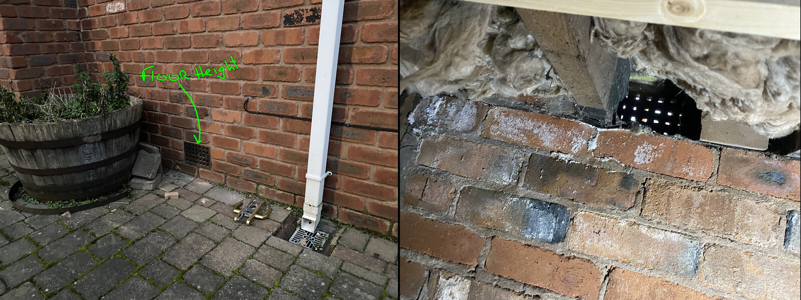

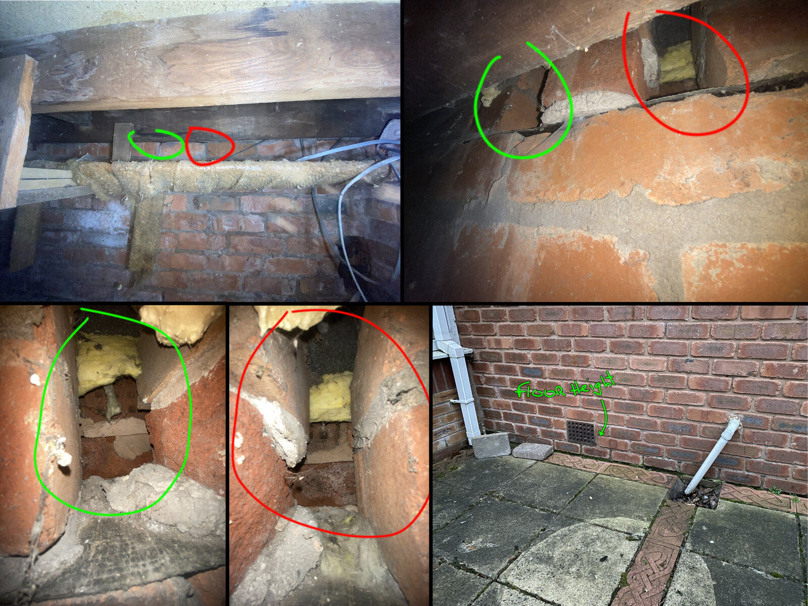

AirBrick 2
This one seemed fine, it's the only airbrick where I could feel a breeze coming through it....and see daylight.... it served as a good barometer for how I expected (and hoped) all the others to be (no such luck)

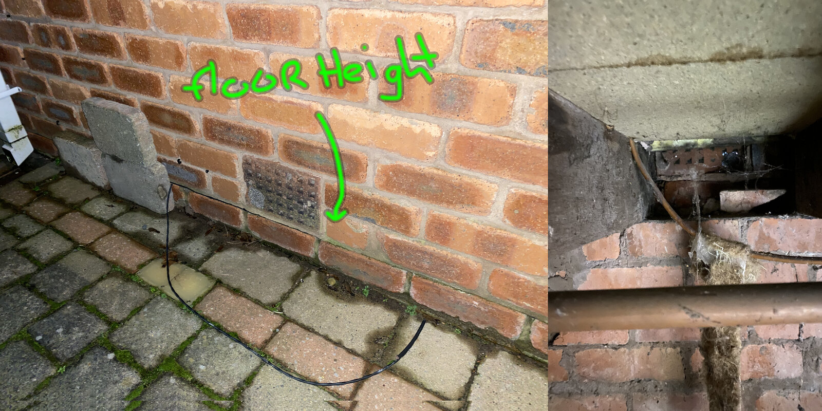

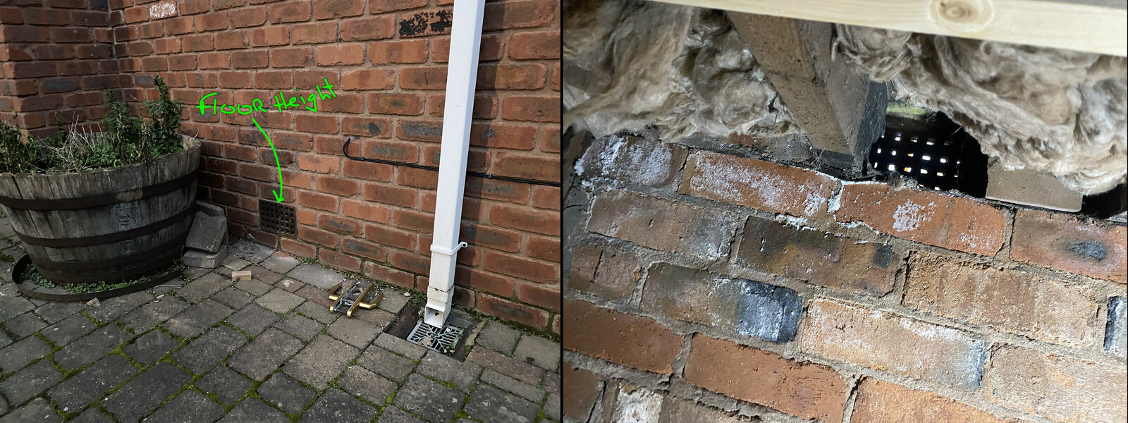

AirBrick 3
As the block paving slopes up towards the rear of the property this one looks like its been mounted too high? from inside you can see it's only partially visible to the sub floor, also we noticed the way it had been mounted the vents sloped up rather than down. Could it have been mounted upside down? or does this just need a Z vent due to its height? or should we just lower it by a course of brick?

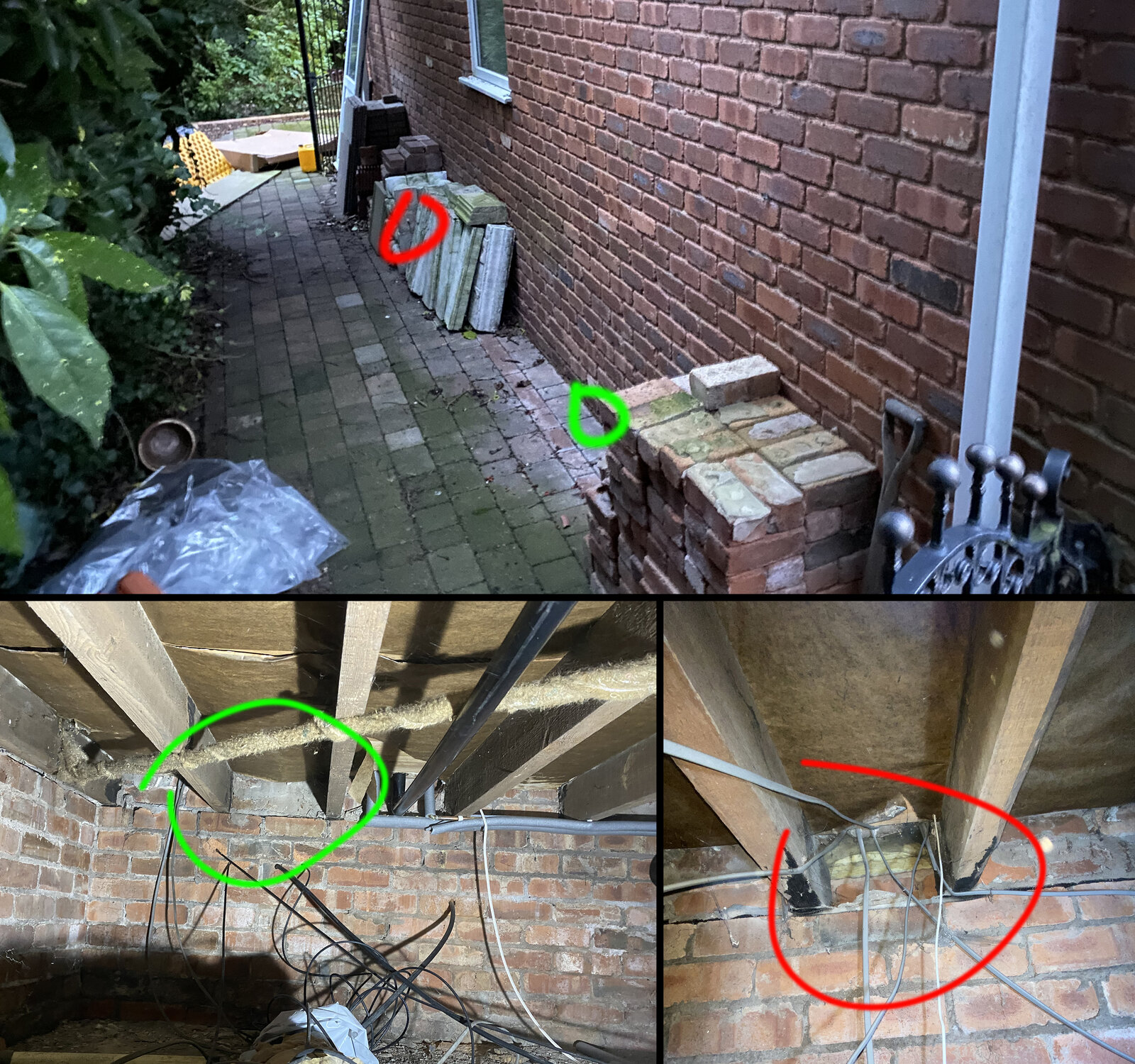

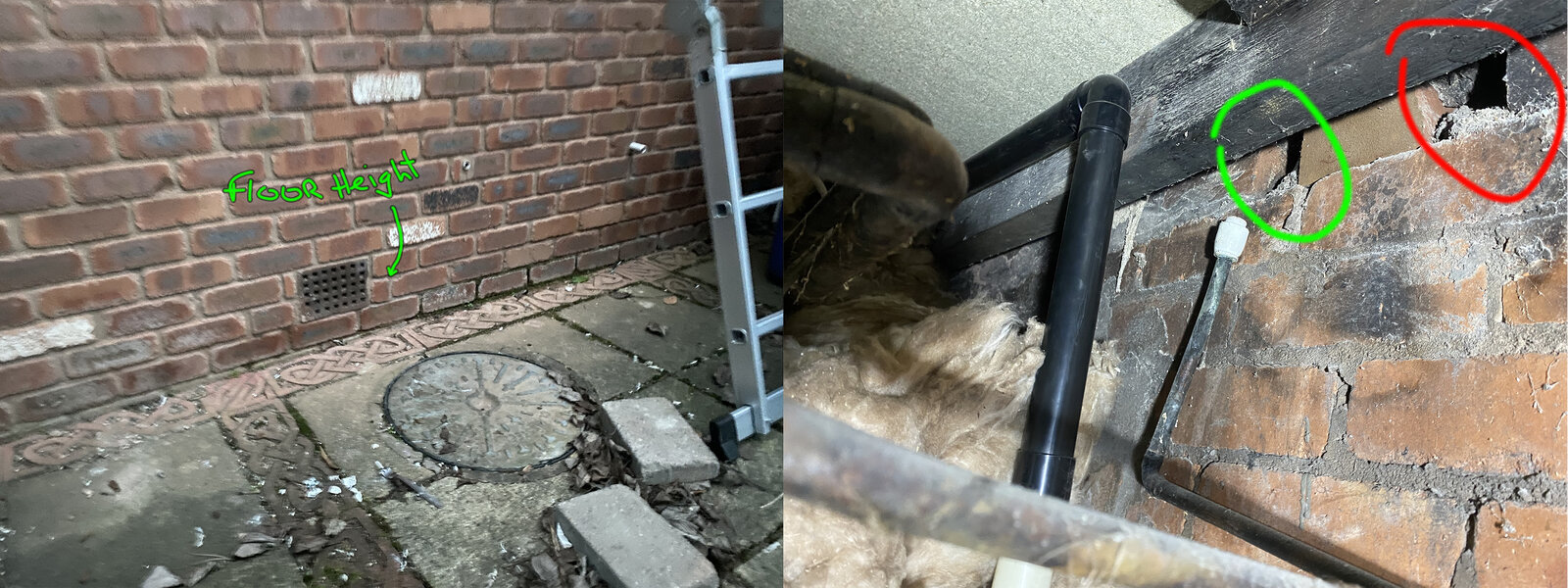

AirBrick 4
The two at the rear of the property (4 and 5) have left me quite concerned. The floor joists run parallel to their openings meaning they're quite obscured, and if that wasn't bad enough, on closer inspection its also obscured by a half brick leaving just 2 small openings for it to vent through.... To fix, shall we remove that half brick and add a Z vent so its vent position will be lower than the floor joist?

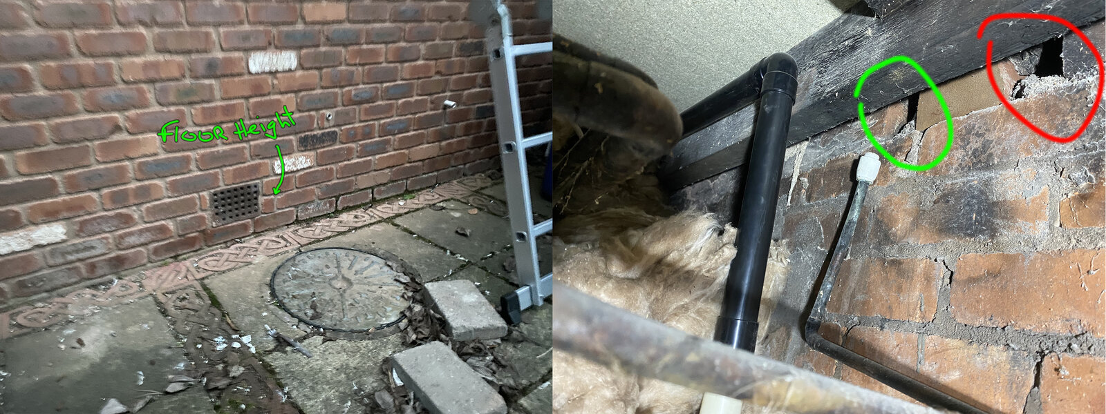

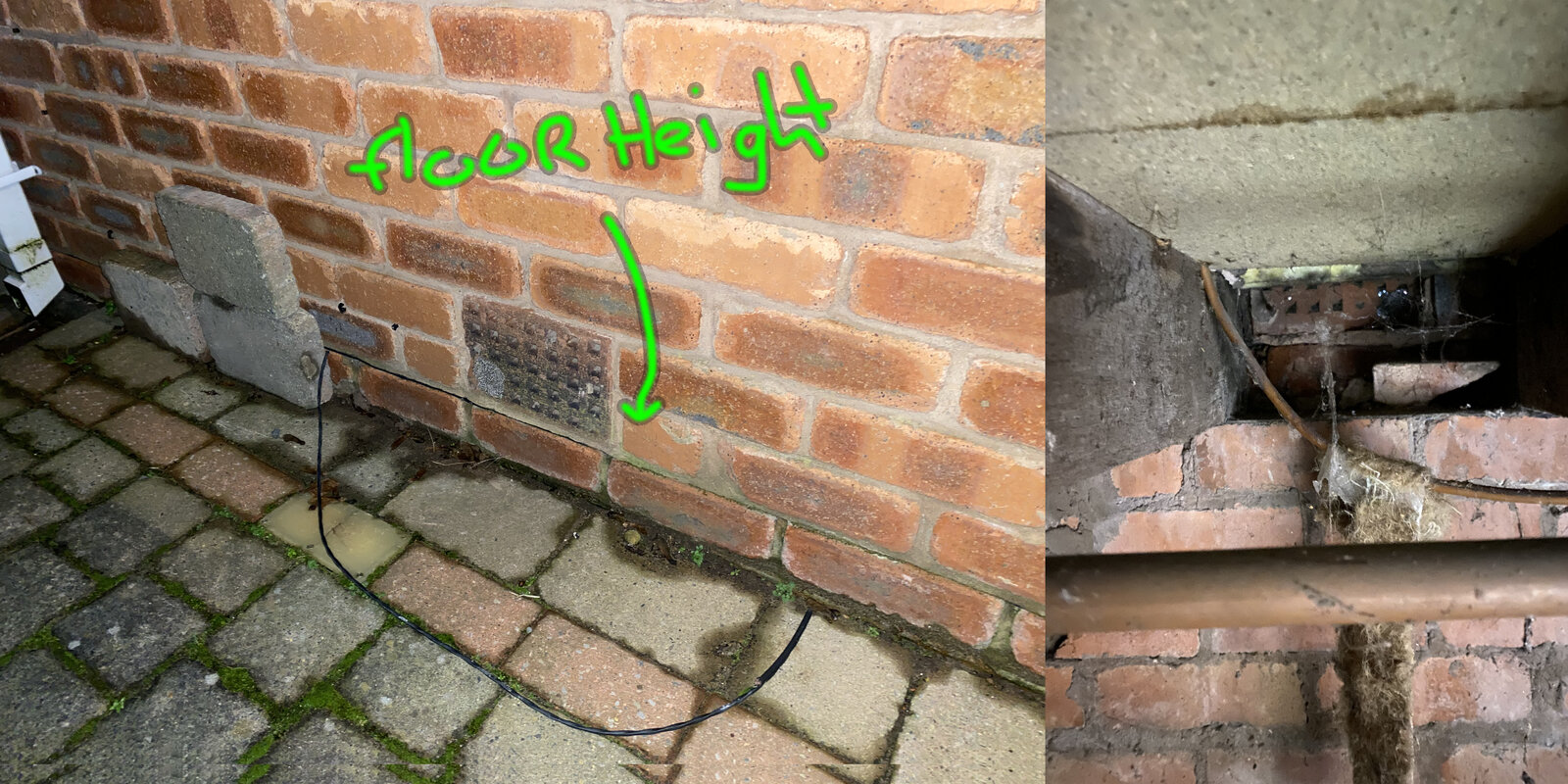

Airbrick 5
Same as airbrick 4, couldnt get any closer to get better photos of this one. But the setup looks pretty much the same.

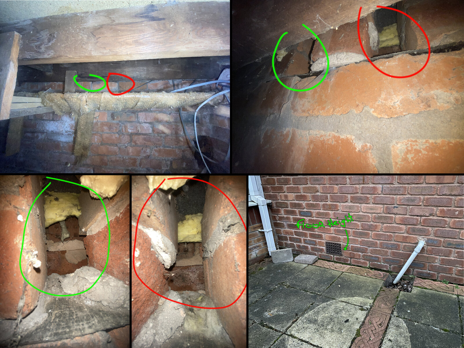

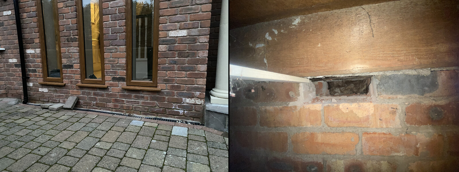

Airbrick 6 & 7
Im assuming the house originally had 2 airbricks down the side here too, as I found what looked like recesses in the inner skin, im wondering if they've just been bricked over by the previous owner..... given the footprint of the property should these be added back in?

At airbrick 3, there is clearly wet at the junction of wall and paving. Take up some of those stones and see if the drain is blocked or leaking.
The internal pic seems to show water marks on the floor and joist
At vent 5, the joist is a very strange colour, there may have been a long-term leak, probably from the plumbing or something in the room above.
At vent 2, there is efflorescence on the inside wall, or possibly soap deposits as happens when a washing machine waste has been leaking
At vent 1, there is efflorescence on the outside wall near the pillar corner, probably a drain leak.
At vent 4, there is efflorescence by the downpipe, suggesting a drain fault.

The paving looks high / too close to the dpc so consider lifting the ones against the walls.

For the existing air bricks I'd clear what's in place and add new vents in addition. Wrt 6&7 they were clearly blocked intentionally (one for wiring?! And one possibly to stop cold air freezing the nearby pipes) and need replacing

In the meantime, re: joist colour at vent 5, those are all burnt and charred by what looks like an old welding mishap. As alot of the disused copper pipes down there are blackened by fire too.

Yes, thanks, I thought as much re: clearing the airbricks and getting 6 and 7 reinstated. For the partially visible ones (3,4,5) that are mounted so high, they'll need the periscope Z vent things so they can vent properly right? Especially for 4 and 5 due to that big parallel running joist obscuring them.

Also regarding the height and location of 4 and 5, should I be getting Z ducts put on them? the periscope type. As it stands even with the extension and the long 100mm ducting theyd add on, they're still badly obscured under the sub floor. So im thinking that needs be addressed too at this stage?

Lowering the ground level would be better, but if you need periscopes to clear obstructions, yes. As you already have a damp problem, the more ventilation, the better. One every two metres is not too many.
