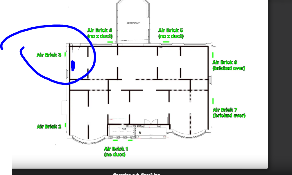

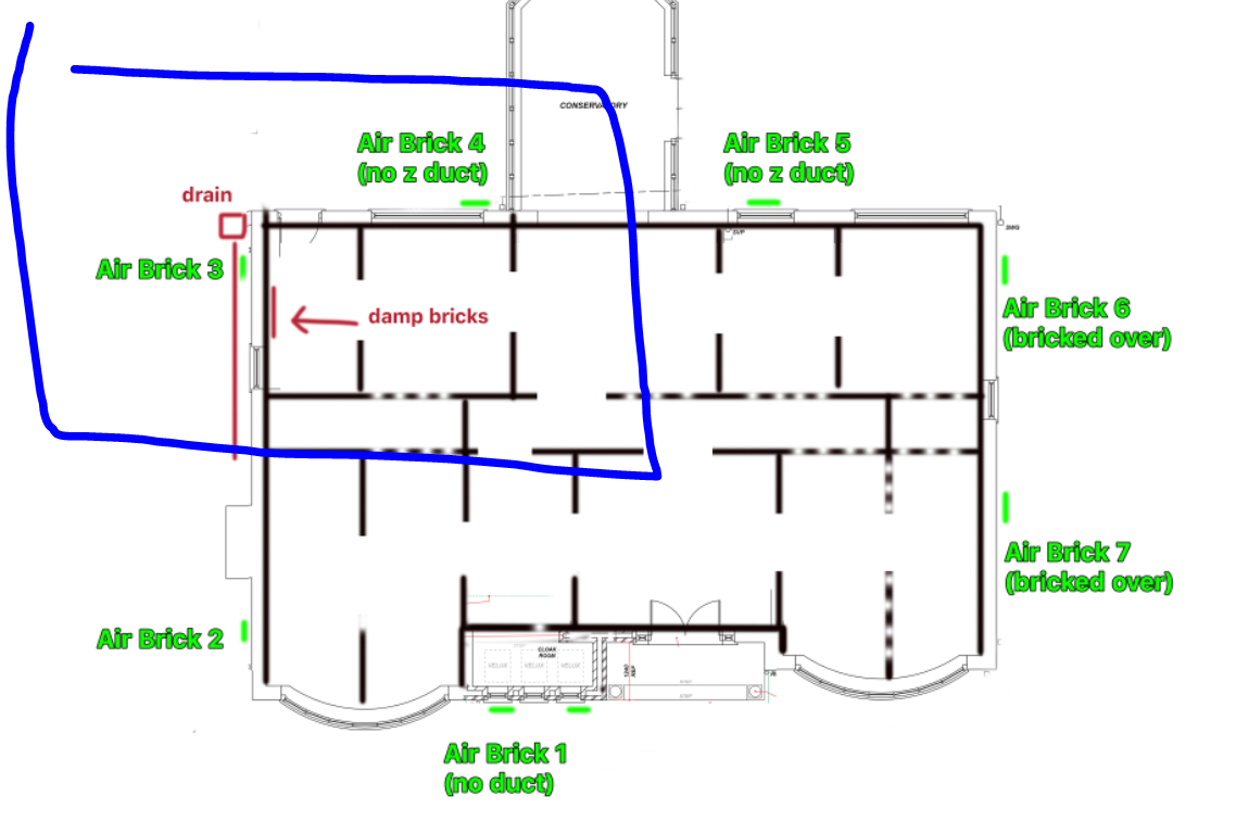

Bit of an update on this one. Had dyno-rod out to have a look at the drains. They couldnt get cameras down them but did unblock the drain by vent 3. (on photo below for refrerence)
They also put some illuminous green dye down each of the drains to see if that was seeping through to the subfloor. So back down the subfloor crawl-space again, I didn't notice any green dye but did notice this time the bricks lowdown in the sub floor by vent 3 do look damp. Video link below (apologies if the speaking is mumbled, had a mask on as it's fairly horrid down there)
Video - Sub-floor Damp bricks
As that drain was blocked.... if indeed it had been blocked for ages and had sitting water in there for a long time, could that be the cause of the dampness on the subfloor bricks in the video?
As if it was a cracked pipe / leaky drain, id have expected to see the green dye in the subfloor too?

The gullies are all salt-glazed clay. As is usual, they are all cracked and broken and leaking, and have been for years. The cavity is caused by the water turning the soil to mud and washing it away.
No point having them rodded, they all need to be dug up and replaced. You may find the underground drainpipes are also bad.
When digging, you may find the mortar has been eroded between the bricks (this is more common in old houses with lime mortar) and the cavities might have undermined the wall.
While you have your spade out, reduce the ground height against the wall. Finished height, including paving, should be at least two bricks below DPC.
