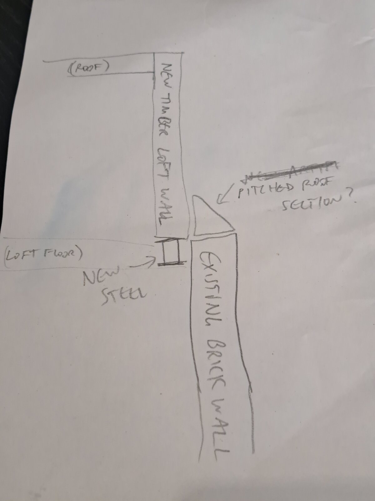

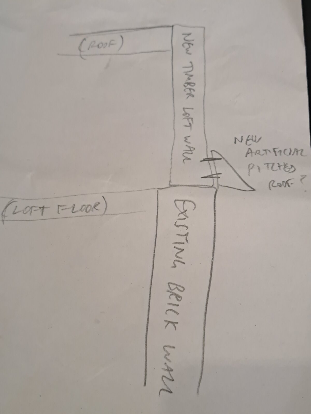

We're working with an architect and structural engineer to design a loft conversion. Suburban semi and pretty standard - keep front roof and dormer to rear. We are going for full planning application rather than permitted development.
Surprise was that architect says new loft walls need to be set back 200mm from roof edge so dormer is "subservient" to roof shape (this is part of permitted development regs). Structural engineer now wants 3 or 4 big steels under loft conversion to support new walls just 200mm from existing brick walls up to top of first floor.
This seems a bit crazy, seeing as all the new walls are basically in same place as existing, solid brick walls. In London area so a builder is going to want many thousands to put four big steels in at second floor height.
Has anyone run into this before? Do you just have to shell out for the steel? Or are there other cheaper ways round it?
One idea I had was to put new walls over the existing walls and save the steel then make a little 200mm wide timber and tile construction off them to mimic being in a roof. Could that work?
