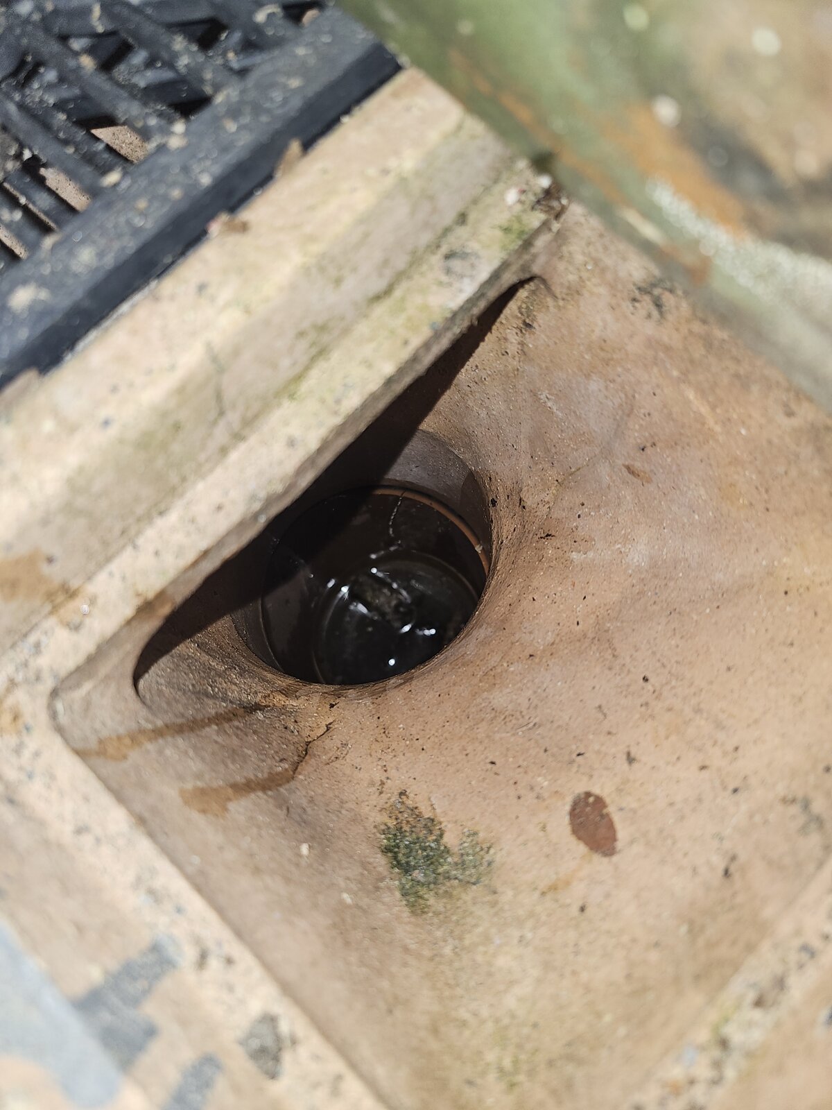

Does the hopper head go into a trap?
Why not lift the manhole cover, and any other covers in the yard.
Observe down the manhole when the WC is flushed - and when the sink is emptied?

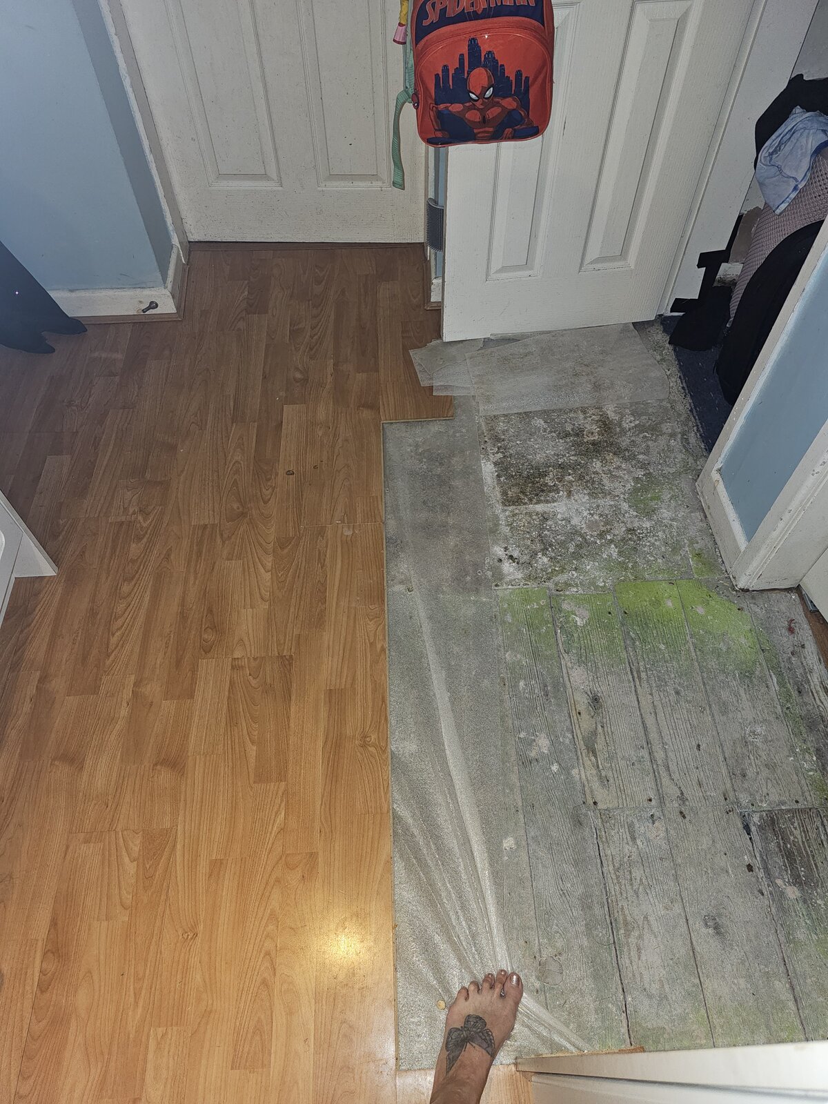

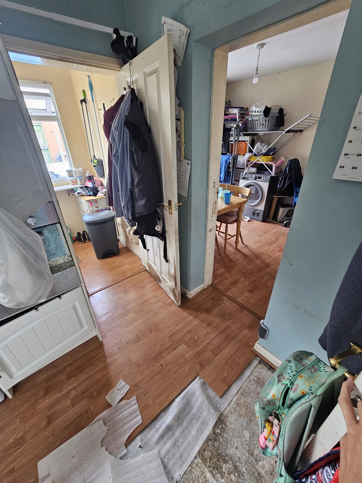

The kitchen floor is floorboards and concrete? It's mostly floorboards, and then concrete near the back door I think. I haven't took all the laminate up yet but you can see here how it's a mix of both. I don't think the laminate did have gaps. It's been down since before I moved here nearly 8 years ago.

I have no idea about the hopper head, when I look down in to it I just see a pipe? Here's a pic down it. And the other holes I meant are the actual air brick holes.
Will be getting my partner to lift up the manhole and check it, he works for united utilities so he does that a lot a as part of his job anyway.
Is that green patch near the back door? Or where the sink used to be?
Nope, that's the living room door next to the green bit. Open door is under the stairs and the back door is to the left where the bit of black curtain is (straight on is the dining room extension).

Your partner should get his rubber gauntlet hand down the hopper head to determine if it has a trap - and to
remove any debris.
Seeing water is usually a good sign of a trap but it might be because of a blockage?

Before lifting kitchen floor boards why not show/post the whole floor as best as possible?
Does any other GF area have concrete?

These 2 rooms off the kitchen are both part of an extention so not sure if that's why the bit of floor in the kitchen between the 2 rooms is concrete. I'm assuming those rooms are concrete flooring too.

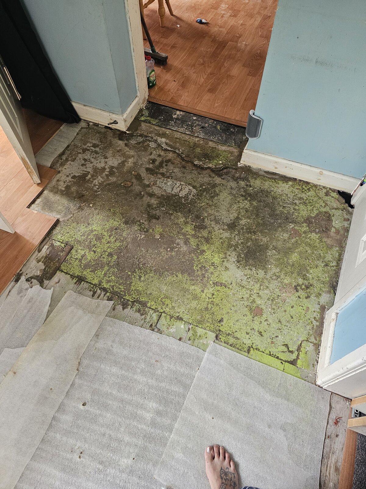

Well it looks like the whole kitchen floor is green, this is after cleaning the concrete with a bit of soapy water. The floorboards are green too, I just haven't pulled all the laminate up or cleaned them yet.

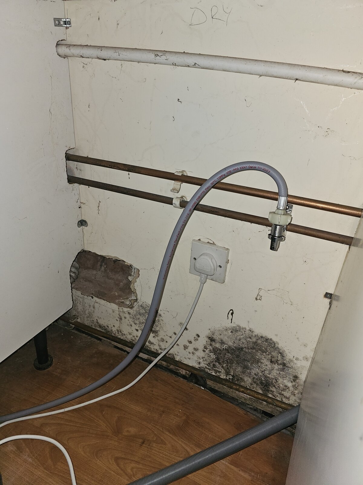

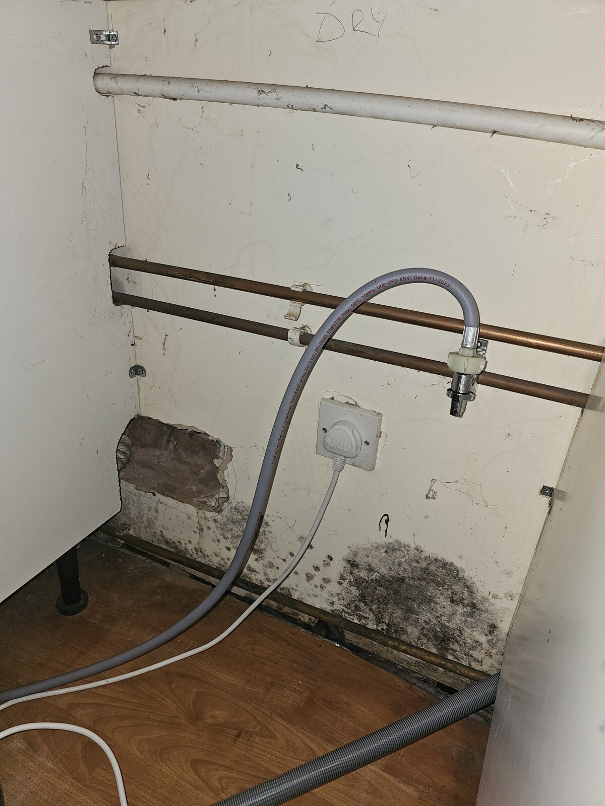

Oh and this is what it looks like behind the dishwasher. The mould/damp patches are dry. Washing machine is too heavy for me to get out.
What would my next steps be? If I just wanted to get someone in to sort it all out, what sort of tradesperson would I get?

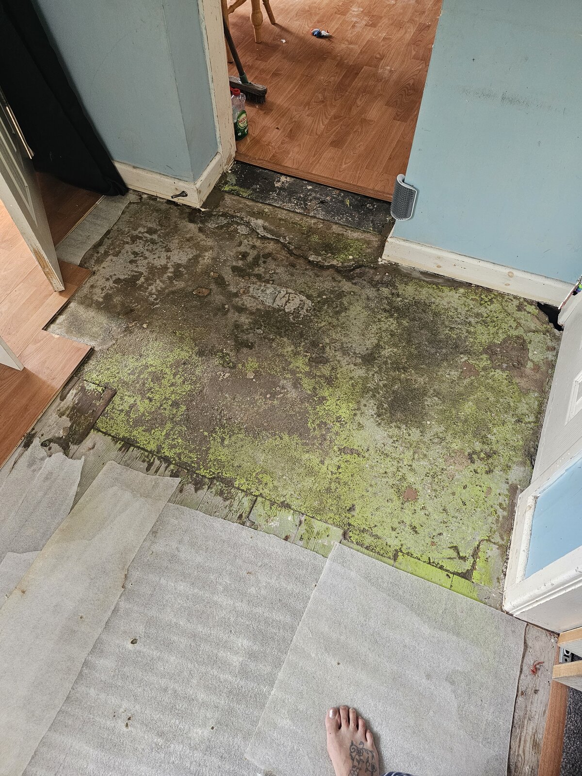

Expose it and look for the wettest patch. Now that it is exposed it will start to dry out and you may be able to identify the source.
It does seem to be particularly damp under those pipes, especially the appliance hose connector, suggesting a leak.
Wrap some dry kitchen roll round it and see if it gets wet.

Looks to be a clamp on washing machine connection , they often leak.
