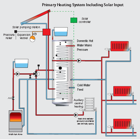

There are four types of storage tank, those where DHW drawn from tank, and heated heated normally in a back boiler, with no built in heat exchangers (hot coils) those where the central heating water is sent through a hot so water does not mix, both result with lot pressure DHW unless a pump is used, then where like previous central heating trough hot coil, but whole tank at cold water pressure, but they need an annual test, and those where there are multi heat exchangers so the DHW and central heating both use a hot coil. Latter normally used where there are multi methods to heat water like solar power and back boilers.
It is in theroy easy, the last method is best, however that is without looking at price, once one looks at price the electric shower starts to look better, but the load is high, at typically 9 kW (40 amp) where often the whole house only has a 60 amp supply, clearly can only have one, however saying that I have two on a 60 amp supply, and DNO fuse has not ruptured, but then we continue I also have solar panels and a battery, so the 9 kW (assuming only one in use at any one time) is often only drawing 6 kW from the DNO.
You can't pump from the mains supply, you can from a storage tank, so once a cylinder and header tank is fitted, you can use a power shower, but there is so much involved, the forum can only tell you the systems exist.
My brother-in-law has this Torrent pipe example.PNG although one tank shown in real life twin 80 gallon tanks, which are heavy, so the new build had special floors upstairs to take the weight, the system worked very well, he went to visit daughters a lot in Germany, and from the airport could turn up his central heating, and solar kept the house above freezing while away and reheated on return, it was really good, so when he moved wanted it in his next house, the quote was over £25k to fit it, same age as me, so he would never get his money back, just not worth fitting, and this is the problem, loads of systems can be fitted, but the question is at what price, and that price may include reinforcing the floor.
So all we can do is tell you the system exists, we can't work out a price to fit in your house, I like the ability to store energy, and storing as hot water is a cheap method, and I was surprised at cost electric v oil, I had always assumed oil cheaper than electric, and on paper it is, but when it came down to actual measuring how much used to heat DHW I found losses using the boiler were way over what I had expected, I have no tank thermostat connected to central heating, so by experiment found I needed to run the boiler 4 times a week, and it ran for approx 20 minutes each time it ran. So boiler 20 kW so that was around 25 kWh to keep DHW hot. When solar panels were fitted I fitted an iboost+ to use the solar energy, it records how much energy used, and last 7 days, just looked, I used 2.74 kWh to keep DHW hot. Not quite one tenth, but neither oil or gas are cheap enough to match a simple immersion heater.

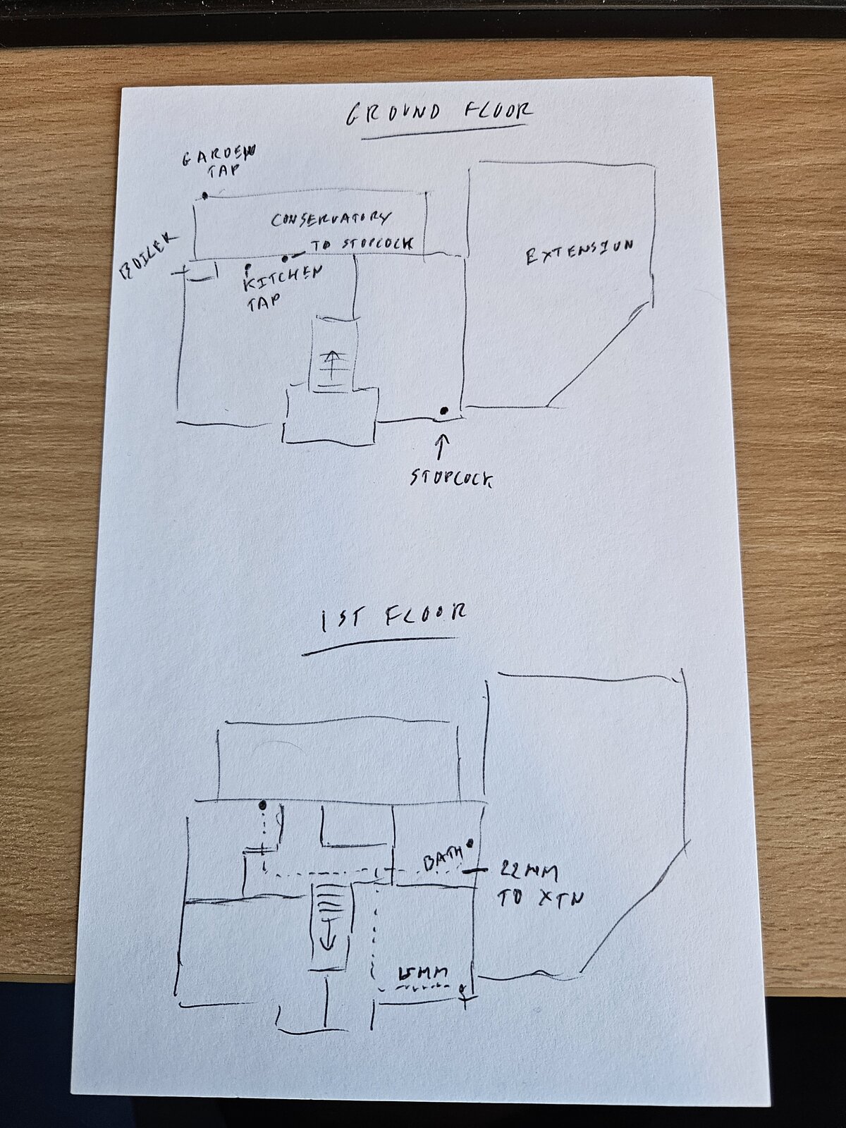

3.6L/Min @ the kitchen could be due to a flow limiting nozzle/aerator on it but even then that's quite a drop, are there ISO valves to the kitchen tap and are they fully open? The differences in mains dynamic pressure could be where the district pressure is better maintained at peak times, basically they bring more pumps online.
You may be getting the max flow to the bath taps as they have the least restricted pipework running to them, is the bath cold 22mm pipe?

I did a quick test running the bathroom tap and garden tap together. That gives me 15.9l/min combined, 8.7 from the garden plus 7.2 from the bath.
Madrab, to answer your question, the whole house is fed off 15mm. There's a stopcock in the lounge with 22mm coming up from the floor, but it comes out of that as 15mm, and goes straight up to the first floor, under the bedroom floor, and splits out from there.
The bathroom comes straight from that, so gets the best flow rates overall, the garden tap and kitchen sink are effectively off the same branch so any restrictions there are almost certainly due to the kitchen tap. The new extension does have 22mm plumbing, but again that connects to the 15mm supply under our bath.
