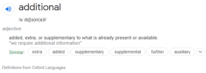

Dictionary definitions of words and what they mean in certain standards are generally unrelated.
The meaning of words in one standard are often completely different to the same words in another standard.
One standard directly conflicting with another is a regular event.
Colossal mistakes and obvious blunders are commonplace.
Given the mess that was added in BS7288:2016 which made the whole point of the devices entirely irrelevant, those who amend BS7671 had no other choice but to remove any reference to it.

That's basically it - the standard now states that upstream RCD protection is required when using an RCD socket outlet, and that such things are only useful for 'supplementary protection' with the additional protection being provided by an RCD for the circuit. ... There is more about them not being suitable for isolation purposes either.
We've discussed this before and I still don't really see the purpose for having a Standard for an item of equipment (or, indeed, the item of equipment itself) which essentially appears to have no useful purpose.
It's also a bit worrying. Goodness knows what 'supplementary protection' means, but even if it merely means 'redundancy' ('belt and braces'), if I felt the need for such 'extra protection', I don't think I would be very comfortable with a device which, for whatever reason, the Standard said could not be relied upon to give 'additional' protection.
'Additional protection' surely only requires a device which will operate in response to a residual current ≥30mA. If an SRCD cannot be relied upon to do that, then what (if anything) can it be relied upon to do?
