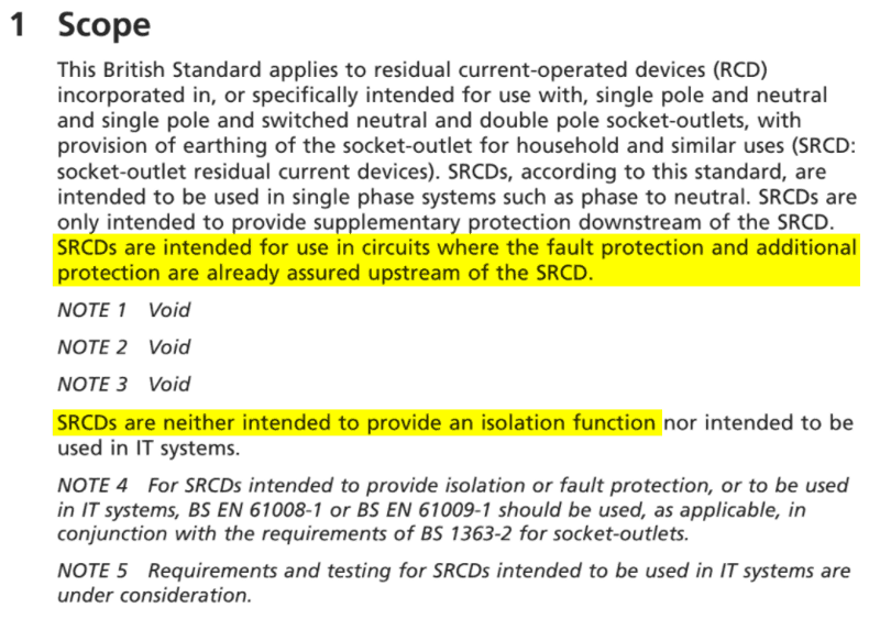

'Additional protection' surely only requires a device which will operate in response to a residual current ≥30mA. If an SRCD cannot be relied upon to do that, then what (if anything) can it be relied upon to do?

That would make sense, and it's something that I've often seen suggested here and elsewhere (and long after that regulatory requirement appeared) - but not if the Standard says that RCD sockets (and FCUs) are not suitable for that purpose (and BS7671 doesn't say that they are).
I'm still mystified. What is the point or sense in a residual current device which can only be 'relied upon' if there is another residual current device upstream of it?!
Kind Regards, John
For BS7288, it's implied that:
Fault protection - fuse or circuit breaker
Additional protection - from a 30mA RCD to 61008 or 61009 (as in section 415 in BS7671)
Supplementary protection - the undefined purpose that a socket outlet RCD provides.

SRCD. (Socket-Outlet incorporating a Residual Current Device). according to several websites
Which is EXACTLY my expectation, also confirmed in JW's posted document:
however from the same document:
My first interpretation when read from the full text:
was
and assumed a typo as the operation performed by any RCD device is so clearcut I wouldn't have imagined it needed to be stated in a document of this type.
Yes.
411.3.3 states that "additional protection by means of an RCD in accordance with regulation 415.1 shall be provided for" amongst other things socket outlets.
415.1 states a maximum 30mA and the required trip time.
Particular RCD devices are not mentioned therefore not required.
People are talking as if "additional protection" is a particular thing in itself - as they do for "supplementary bonding" - rather than just meaning 'extra'.
Saying a a BS61008/9 RCD can only be used as additional protection does not mean only a BS61008/9 RCD can be used as additional protection.

As described in BS7671, 'additional protection' is either 'the use of RCDs with a rated residual operating current not exceeding 30 mA' or 'supplementary protective equipotential bonding'.
Section 415.
One of which limits the duration of a shock, the other limits the voltage.
There are situations where neither are required (such as the heater circuit in steel conduit), but those are the exceptions and certainly not the majority of installations, particularly for socket outlets in domestic and smaller commercial environments.
Interestingly, IEC 62640:2011 (from which BS 7288: 2016 was developed) has the sales pitch:
IEC 62640:2011+A1:2015 applies to residual current-operated devices (RCD) incorporated in, or specifically intended for use with two pole socket-outlets, with or without earthing contact for household and similar uses (SRCD: socket-outlet residual current devices). SRCDs, according to this standard, are intended to be used in single phase systems such as phase to neutral or phase to phase or phase to earthed middle conductor. SRCDs are only intended to provide additional protection downstream of the SRCD. SRCDs are intended for use in circuits where the fault protection (indirect contact protection) is already assured upstream of the SRCD.

It looks like the pitch to BS 7288: 2016 had the bit about additional protection added. Possibly by an over-zealous editor.
That makes sense - and is rather obvious.
There is nothing to say that the indirect contact protection has to be another RCD therefore the socket will be the additional protection.
