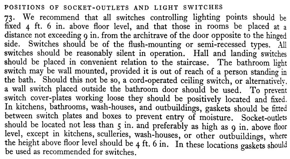

1944 - 40 years before the OPs supposed 'ok' house with sockets in the skirting boards.
Thanks. Mind you, given some of the skirting in my house which I described (some of it ~12" high, and about 3" deep), "... not less than 5 in. and preferably as high as 9 in. above floor level" would/could be on my skirting!
