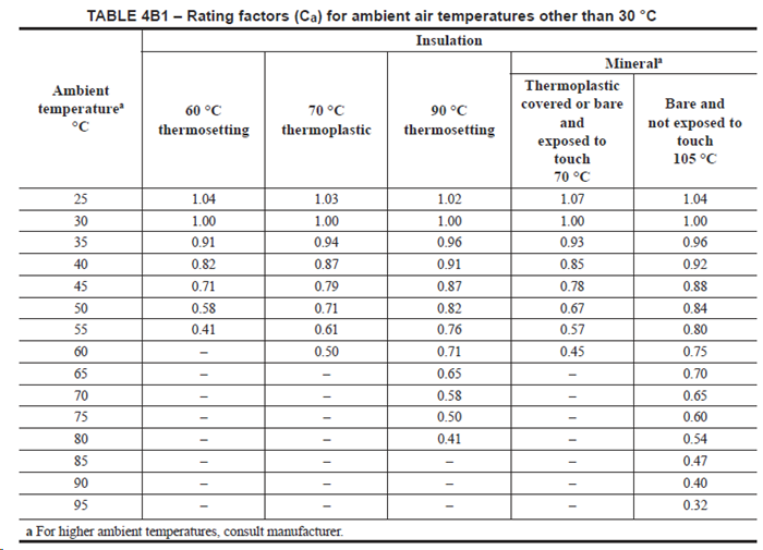

What would be an appropriate de-rating factor for the cable when inside a black conduit that was being heated by solar radiation ?
Good question. About the nearest the regs get to that are the de-rating factors for ambient temp (see below). However, they obviously assume that ambient temp will not be higher than the maximum conductor operating temp (hence the tabulated values 'stop' above that temp), although I don't think there can be any guarantee that the ambient temp experience by the cable won't rise to above that 'maximum'.
White (rather than black) would obviously help to some extent but, in the case of protracted periods of intense sunlight, I'm not sure that would necessarily do more than slow down the heating (rather than restricting the max temp achieved).
Kind Regards, John
Enclosed in insulation?
I don't think that would be 'enough'. With "enclosed in insulation", the only temperature rise of the cable (to above ambient temp) would be that due to current flowing in it - i.e. if there were no current, the cable would be AT ambient temp.
However, today being a prize example, it would not surprise me if the something inside of black conduit in my garden could easily be be 40-50 degrees with no current in the cable (the air temp is currently 33 degrees), and any additional heat due to current flowing in the cable would raise the temp even further.
Indeed, on a day like today, it's not impossible that cable within black conduit exposed to the sun could actually rise to (or above) the "maximum conductor temp" of the cable - in which case the de-rating factor would theoretically become 'zero' (i.e. the cable could not safely carry any current at all).

That doesn't surprise me. As I said, I would think that the temp inside black conduit in sunlight today could, in my garden, probably easily exceed 50°C+, particularly given that even the air temp is around 32-33°C.
However, in terms of this discussion, de-rating factors for high ambient temp are going to be essentially the same for any type of cable - and SWA (almost always black) would probably get at least as hot as some other cable within black conduit.
