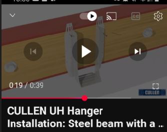

Ok if I were to redo I may aswell lower the ceiling even further to below the steel beams (parallel but underneath) overall ceiling height 2.3m. Basically span a 3x2" from load bearing wall to load bearing wall. So this way could I just use 2 x timber to masonry joist hangers ( one either end) with no need to fix the timber to the steel beam (which is above)? Would this work?
