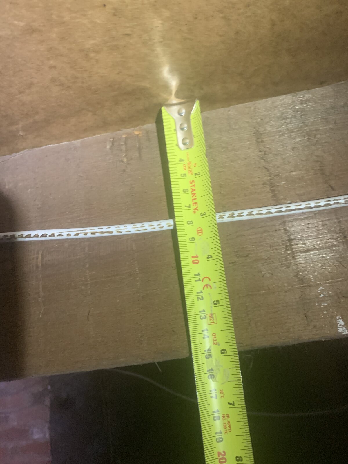

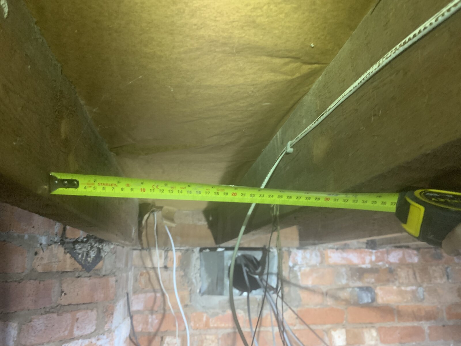

Joist depths 150mm, Joist widths inconsistent (300mm -370mm)
Width - The Combi roll I bought (1140mm width) can be split into 3 lots of 380mm so i think that will be fine, presuming I can squish the 380mm into a 300mm wide gap without any issues?
Depth - With the depths at 150mm, assuming vertically compressing the 200mm roll a little bit here is also fine? Or better to let it bulge a bit if I use bird netting rather than chicken wire for example?

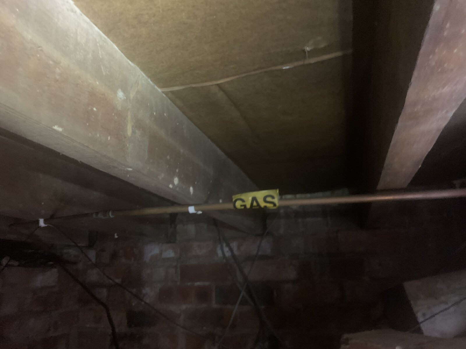

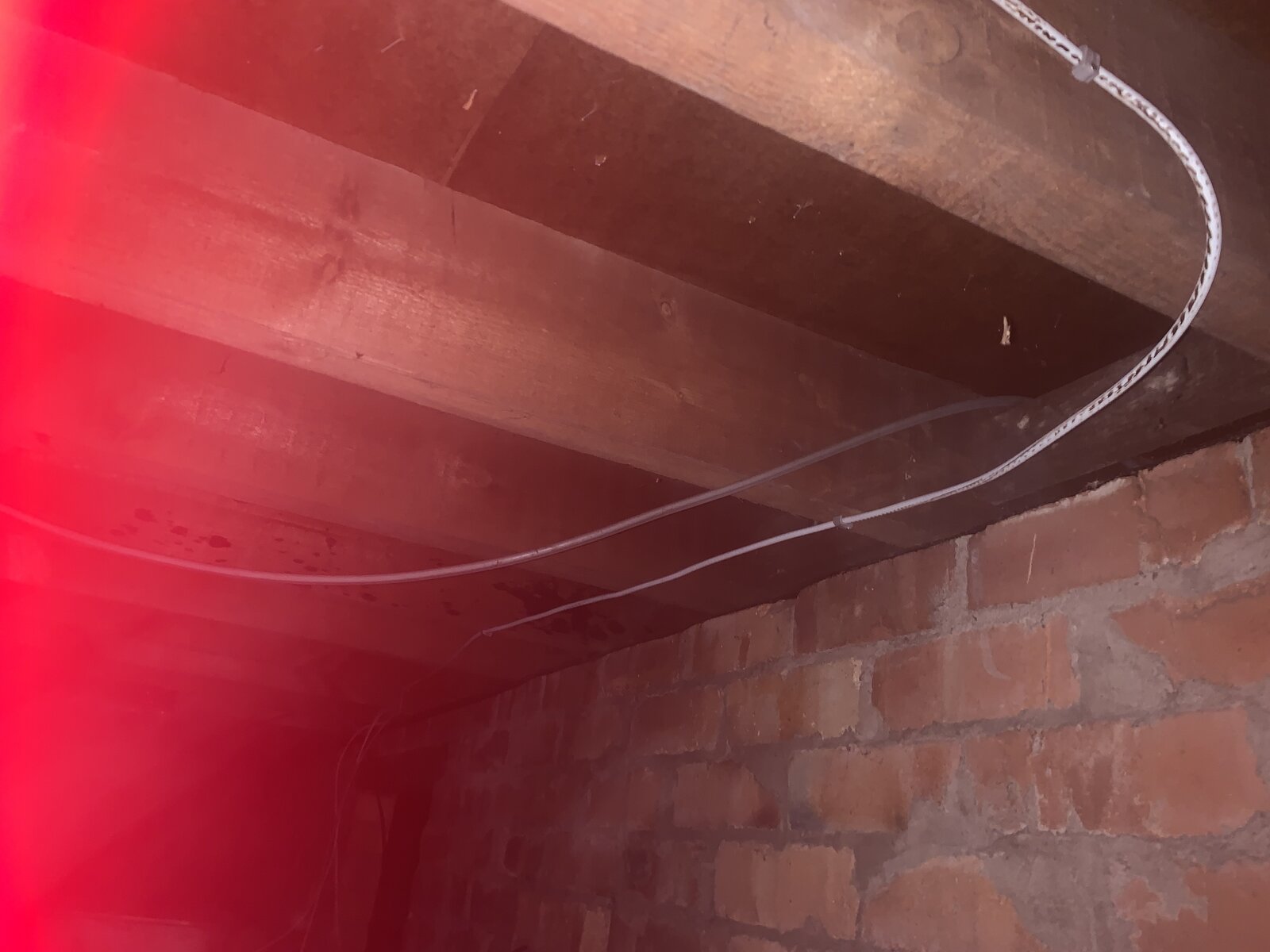

Location of Electrical Wires
I saw there's loads of electrical cables sagging here, there and everywhere, some were clipped to the side faces of the joists too (images below).... Again, assuming its fine to just crack on with the insulation here? or will I have to unclip these and allow them to sag beneath the insulated voids?
Also when I come across the same situation with plumbing pipes in other rooms, will the same as above apply? or different?
thanks again
Cables can rest on top of the insulation
(Or hang beneath it)
But must not be buried in it
Looking at your pics, I think I would clip them to the underside of the joists.
If it was on top of the insulation you might put a nail tbrough it
You can clip a short bit to the side of the joist to come up through the floor.
Pipes between joists can be buried in insulation, but just push it up from underneath
If the pipes are under the insulation you will have to lag them.
It does not matter if the wool is slightly compressed
You can easily stuff quilt into a slightly narrower gap

The insulation gap is so they don't overheat due to current passing through them
Does not apply to comms cables.
The gas pipe does not need to be insulated, and it should exposed. I paint mine yellow, but I'm barmy.
I believe it's disused that now anyway, was for an old gas fire that's since been removed / capped.
IF it has been disconnected at both ends, you can remove it.
width: before you unroll the roll, put a saw through the whole thing at the width you want plus a little. Let your wool expand back to its normal size on the floor befor picking it up and pushing it between joists and dont over compress it - it doesn't take much to stop it expanding back and you want it fluffed up as deep as possible
Depth: I'd let it bulge(but you can also get 170mm top up roll too. Any reasonably strong netting will be fine, doesn't have to be wire - you can get eg netting that scaffolders use to stop debris falling off scaffold fairly cheap. You might even find some scaffolding locally being taken down where the netting is being binned; they don't always reuse it.
