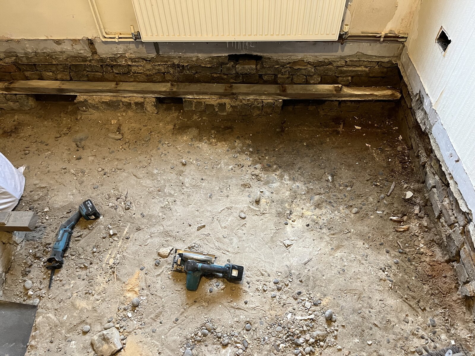

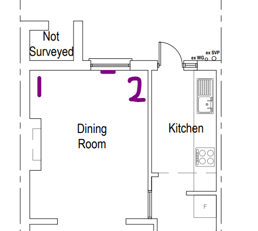

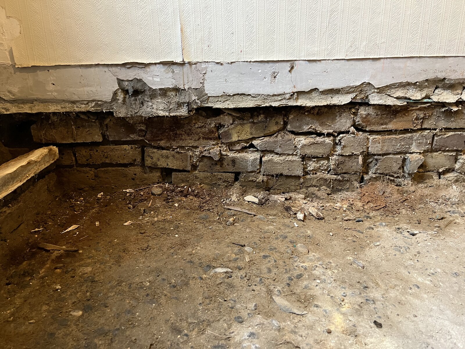

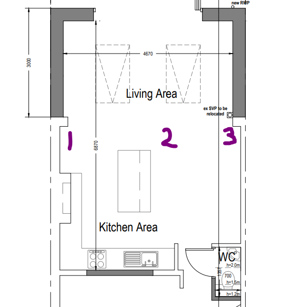

Here is another floorplan. Corner 1 is the area that was damaged, but shows no signs of damp since I cleared out the mess that was down there. Corner 2 continues to have a damp issue, though I think I have figured out why. More on this later.
There is only one air brick, which I have marked on the floor plan with the purple dash under the dining room window. You can just about make this out from the outside, under the window.

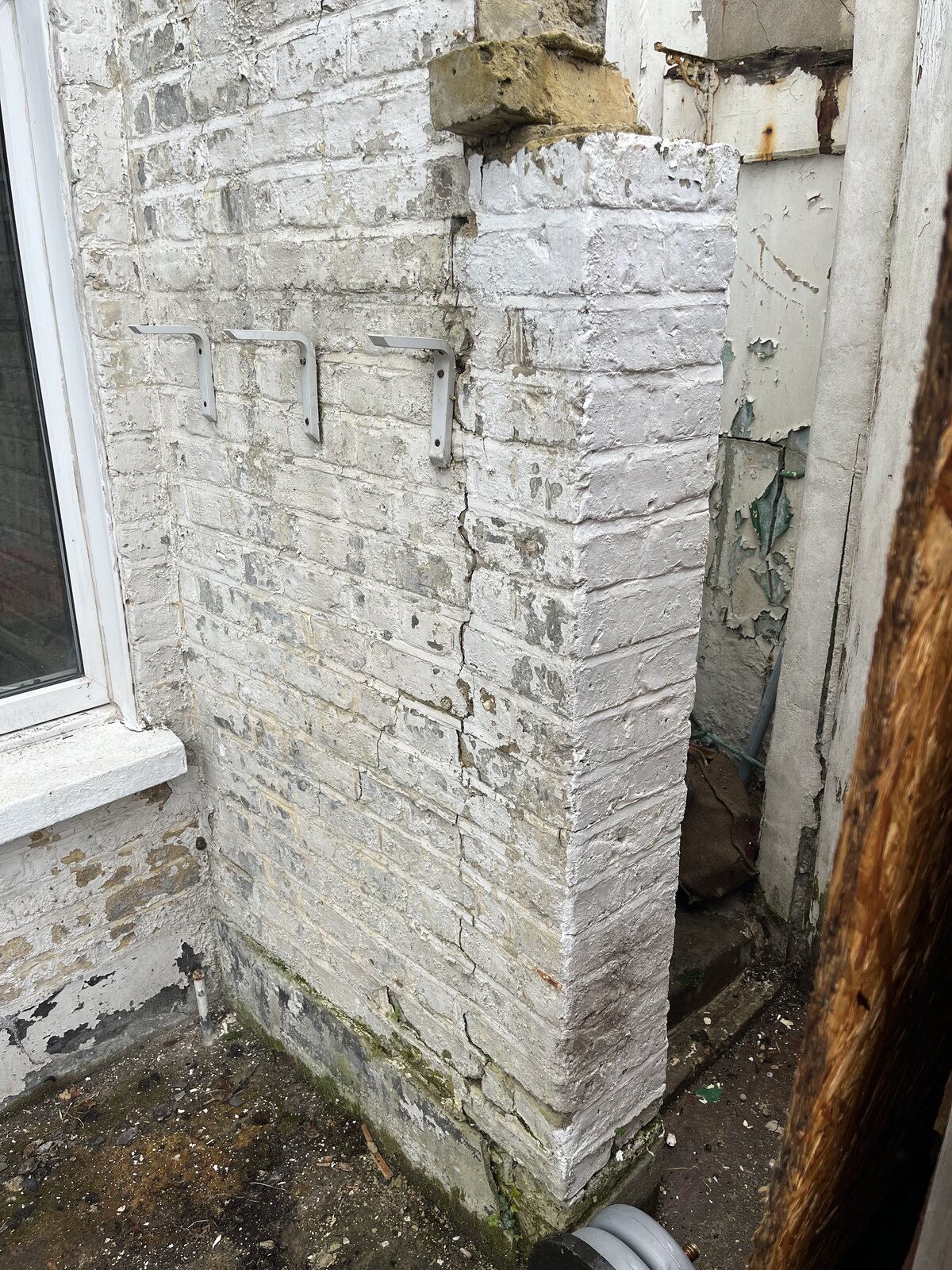

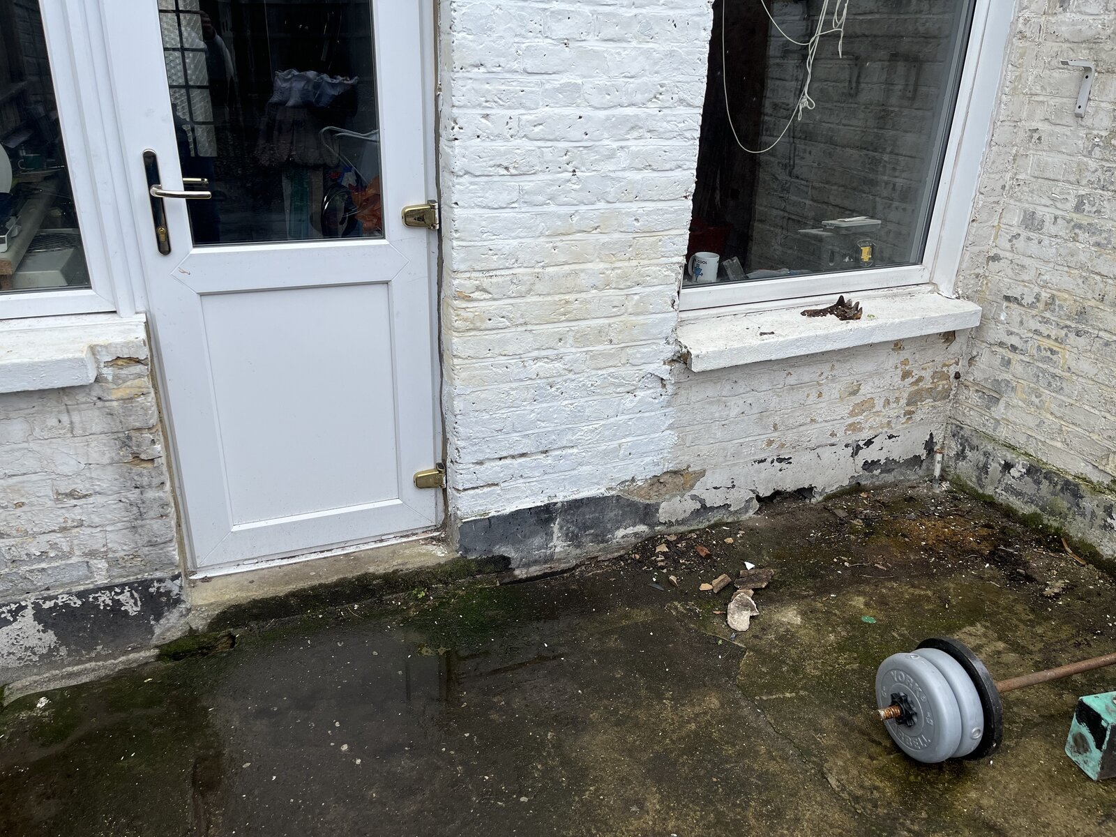

Here are some more pictures from the outside, with the "Not Surveyed" being the original outside WC (which has no roof or door, so is pretty much 'outside'). The exposed WC is raised as can be seen in these pictures.
The above image of the outside WC backs on to corner 1 of the floorplan - despite there being a lot of rot in the joists there, I think this was down the rubble/concrete/general crap build up and resulting poor air circulation - and now I have taken this all out, there doesn't seem to be much damp in the floor area (there is some, but it doesn't seem to spread across the dirt floor, its just a bit damp up to DPC level and on the soil behind the dwarf wall).
This is not the case in corner 2, where the inside is visibly damp these last few weeks with the rain. You will see in the below image, I have now removed the joists - it looks like that dwarf/sleeper wall (can somebody put me out of my misery and let me know what I should call it please?) will need rebuilding as when I removed the timber from the top, the bricks were very loose. In fact, most of the area has a serious lack of cement between the bricks... 100 years of damp perhaps caused it to crumble out?

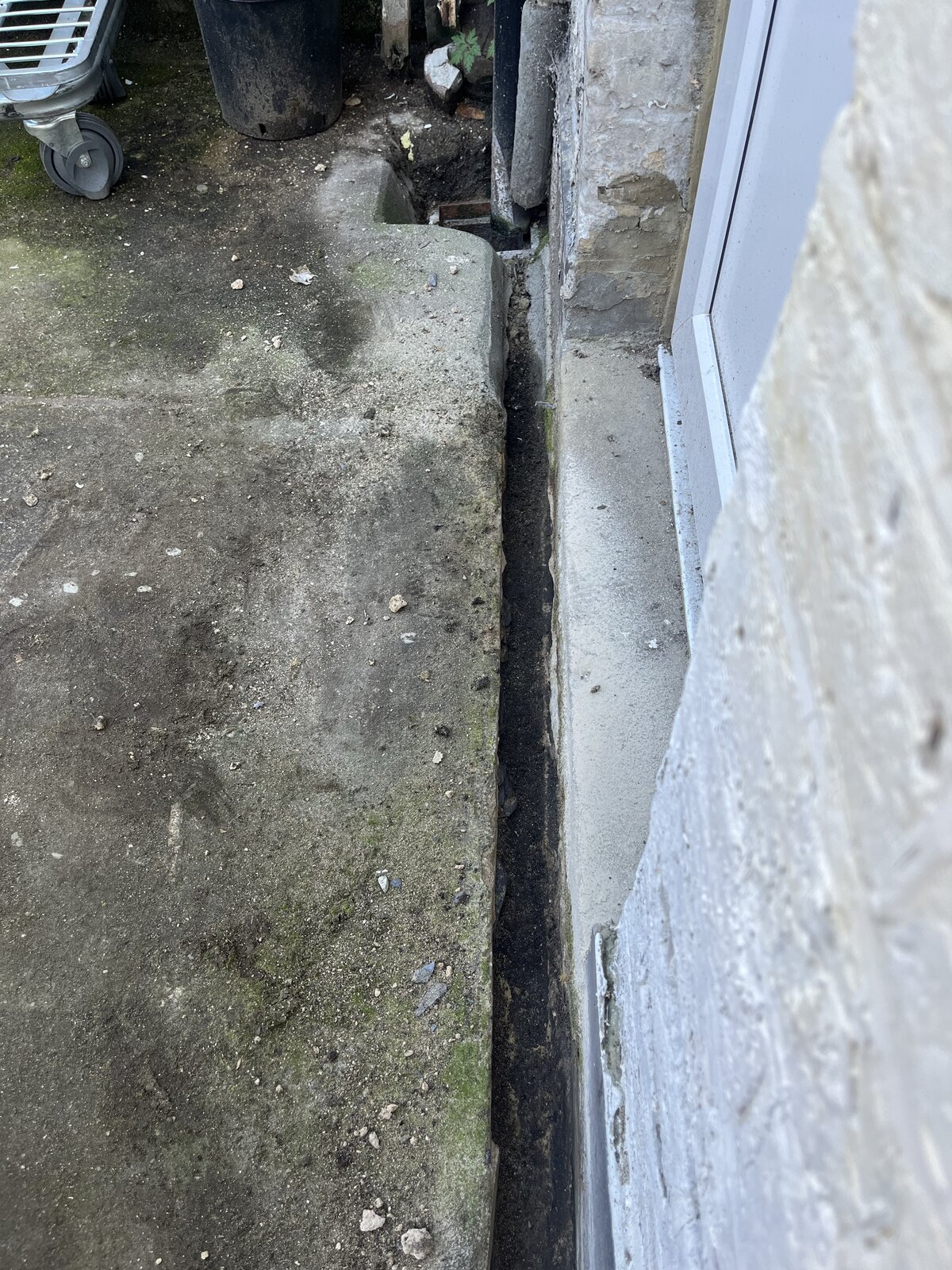

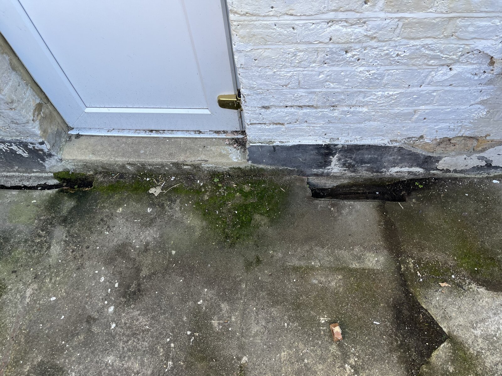

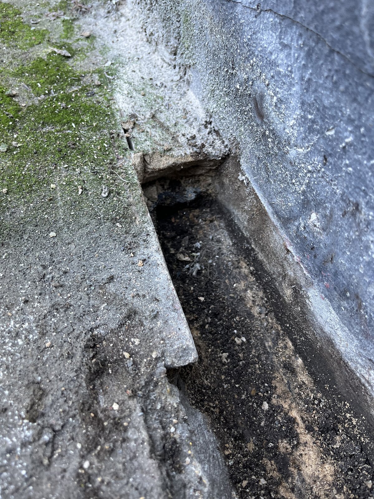

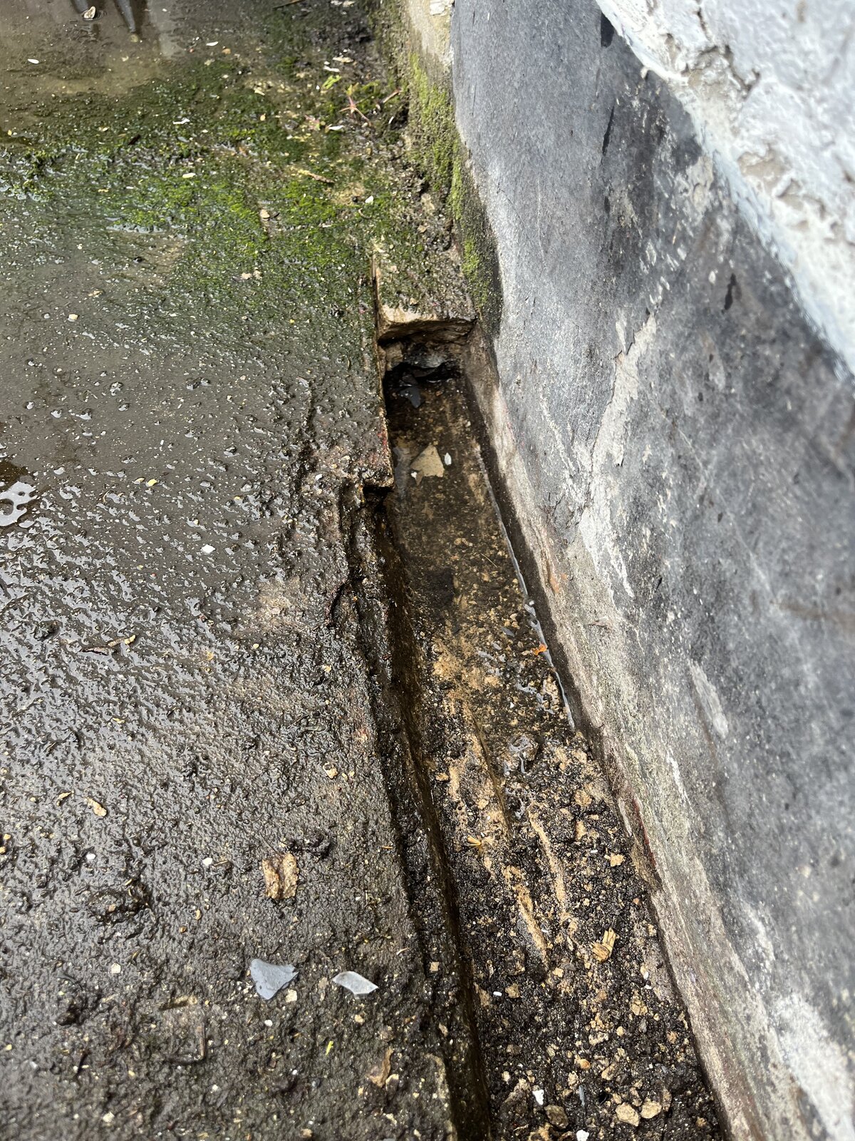

In terms of what is causing this damp.. you will have seen the puddle on the concrete slab in my first picture of the previous post - there is also some kind of drainage that is open to the right of the back door, runs under concrete for a short while, then open again and is supposed to drain into the soil/waste drain.
The covered bit is definitely blocked..
I tried to push the dirt through but it wasn't moving, so got the angle grinder out and can see that under the cement there is a slate layer, with compacted soil underneath it.
It is raining now, and as you can see, that trough is full of water - which is surely soaking through into the kitchen (which has a cement floor), up the adjoining wall into the dining room and troublesome corner 2? I am thinking I should continue cutting away the cement parallel with to door to create an open gutter and see if this reduces the damp in corner 2?
Incidentally, the wall separating the kitchen and dining room at corner 2 is in a bad way.
Which probably explains the big cracks in that wall, and the in the room above it.
Somewhere in there there I found the rotted remains of an upright piece of timber that looks like it goes up through the wall- around about where those bricks are collapsed.
I should probably also mention that the soil pipe collar is also cracked which is causing a leak, which I also think is soaking through into the other corner of the kitchen (Corner 3 if you will) AND that all of this will be addressed - the plan is for the entire rear of the house to come off, as well as the wall separating the kitchen and dining room, as per the below.

You’ve got a few things going on, all of which I’ve had in a previous old house.
Firstly, think your new floor, will need a deeper timber size than the 100mm you are proposing. You can stop some of the bounce by putting spurs/posts down, similar to decking and or building a honeycombed sleeper wall to make the spans shorter and reduce bounce.
Maybe putting in solid floors might be an option (are you doing all downstairs?)
The shonky brickwork can be expected in older properties, something could have dropped, but it just looks like they couldn’t be bothered!
Outside, the concrete patio wants either chopping back from the house, or removing entirely, as it’s probably above the recommended 150mm from DPC to ground level. You may have leaking drains, not costly to redo yourself.
There’s a lot to look at, and it’s easy to get ‘down’ about it all, this happened to me on my last renovation, but keep chipping away, you can turn this around.

It sounds like you agree with my theories about where the damp is coming from. I will cut a strip between the ‘patio’ and the house and see if we see some improvement on corner 2.
Patio will eventually come out when extension goes in, likewise drain repaired when it is moved.

I cut a channel to separate the concrete slab from the side of the house earlier today so will see what this does to the dampness in corner 2 over the next few days.
