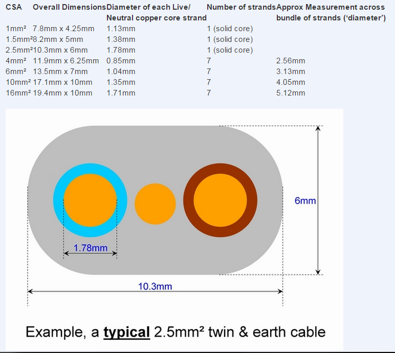

Each core when stripped of its insulation fits snuggly into a Yellow Lugg.
Yellow will take 6mm².
The measure the CSA of each 7 stranded core is approx. 3/16" / 4.5mm Each strand of copper wire is just less than 1mm.
CSA stands for Cross-Sectional Area.
Your figures do not match.
Your figures do not match. ....
That table of mine you've pasted in relates to T+E, and may not necessarily be the same for cores of SWA (although I can't see why not!). However, if the OP's 4.5mm core diameter included the insulation, his figures would be pretty close to 6mm² in that table.
Of course it's the same. Xmm² = Xmm² and Xmm²/7 = Xmm²/7
Except for the <1mm² strand.

yes i forgot to mention that the 4,5mm diam included the insulation! I do know what glands and how to terminate to terminate with. It is not a NEW installation but I am replacing an older cable with this much bigger and amoured cable,and updating the safety arrangements ie fixing an RCD etc. Earthing will be carried out at the main fuse box with the appropriate size earthing cable. If needed I can also fit an earthing rod into the ground at the cabin end. And NO the cable did not have any other marking on it, 2C 4.00mm or anything similar on it. 6mm is about right , i agree, so it will be ample for the current required.
It was the final of my columns (approx overall diameter) I was thinking/talking about, and that could differ a little between cable types according to how the strands were twisted.
I reckon that "less than 1mm" and "1.03mm" are in about the same ballpark, given measurement errors, particularly if what the OP measured was 'a bit squashed'!
