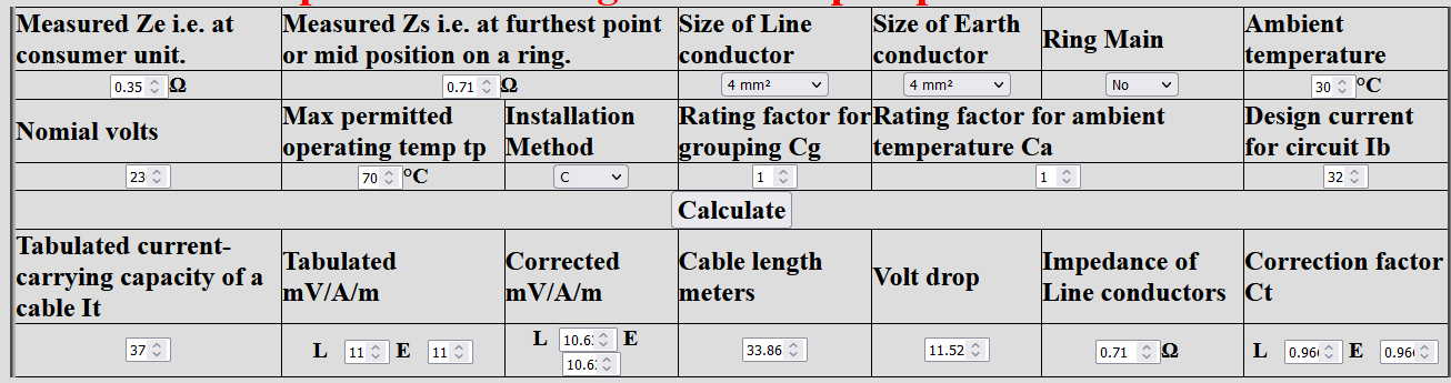

So with a B32 MCB for example the magnetic part needs 5 times the current to trip to the thermal part of the trip, plus 5% allowance for volt drop, so (230/(32 x 5)) x 95% = 1.365625Ω the supply also has some loop impedance typical 0.35Ω so around one ohm for the cable.
As electricians we tend to estimate what the impedance will be, and only actually calculate when we realise we are getting close to the limit. I find the calculations are a bit of a pain, and so made myself a program to calculate it for me, which means less likely to make an error.
