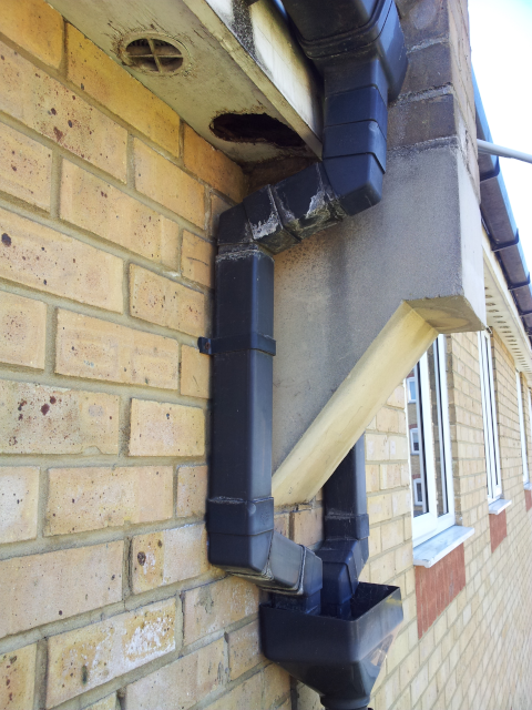

I think there is restriction in a piece of swan neck. This is evidenced by over flow of the gutter in heavy rain resulting in water spilling out from the gutter sides. The gutter is shared by two town houses. It remains possible that the over flow could be to do with insufficient capacity.
From the exterior look of the swan neck, would you say there is restriction in it? What is the normal procedure for diagnosing it and clearing it? The feed into the swan neck is clean.
I am thinking of taking off the bracket and removing the swan neck for inspection and cleaning. I don't want any potential debris to go below the swan neck into the funnel for the down pipe that is shared with a neighbour. How are the swan neck pieces fitted together, is it by friction?

Check the fall of the guttering is correct (or at least running towards the outlet).
Usually friction and gravity holds them in place, don't be too rough if you do try to dismantle, the plastic gets brittle with age.
A short length of electrical cable pushed down through that neck will reveal any gross blockages.
You could maybe try something like this before having to resort to removing sections?
Sometimes glued.
Try running a hose into it

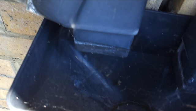

What I have tried that failed: put an inspection camera in there. It hasn't auto focus so all I know is that the swam neck down to the first bend is all clear.
What I have tried that might succeed: I dropped a steel chain into the swam neck. If it comes out the other end then I know it has a reasonable path for the water. But I don't have enough hands to manipulate the chain and hold a phone cam on a stick to check the other end. Currently waiting for a helping hand. The swam neck is not currently within my touching distance and I have to deal with it remotely.

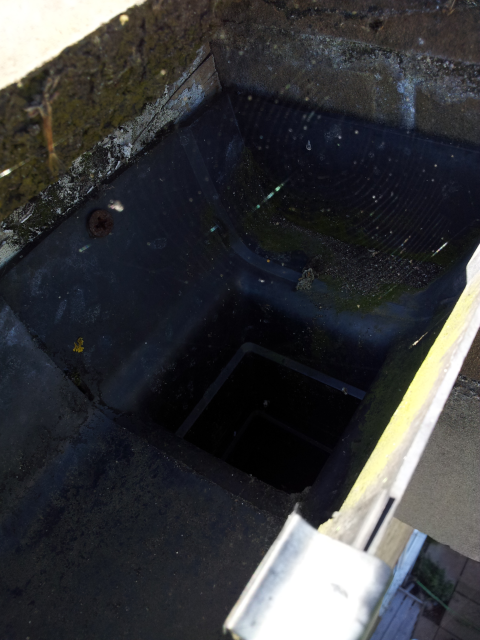

I have proper access, just not at the moment. I won't need access if I can confirm it now nothing is blocked. Cam on stick is adequate for now. The exit end of the swam neck looks clear.

I don't quite understand. You're asking people to comment on whether or not we think the section in question might be blocked. How can we tell simply by looking at a pic? Once you have access again, I'd try using a flexible drain unblocker. If this goes from opening to exit without any restriction, that would indicate the section in question isn't blocked. Another thing you can try assuming you can reach and carry the water safely, is to pour water down the gutter opening and listen to the flow. If it's blocked to any extent you'll hear a change in tone to the running water.
I'd be trying these things before resorting to taking it apart.

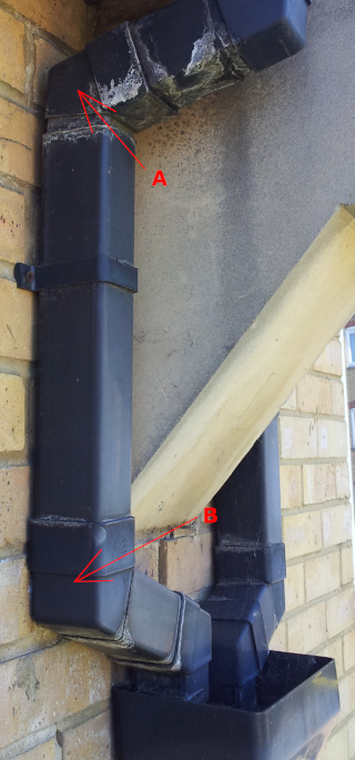

From the water marks, I estimate the blockage to be in area A. What is the likelihood of the piece at B is glued on? This piece looks a bit anti-gravity to me to be able to hold on purely by friction. If I am able to pull off the B piece, I can then poke a stick up the straight piece above to free the blockage at the estimated location.
The outer dimension of the straight piece is 65x65mm. Wickes does this. I will go there to have a play with the pieces to see how they hang together.

I don't want debris to go down into the shared down pipe with the neighbour. The down pipe is on their side of the fence. Even when I have access to the swam neck, it's likely the bottom end of the swam neck is beyond my reach. I won't know until I try. But I am not going to plan for something that has higher risk of not working. Pulling off the B piece is the least risky if it can be done. The swam neck will have no risk of disconnecting into pieces because of the bracket is still holding most of it in place. Any debris poked out will have a greater chance of falling on my side of the fence.
Blocking the shared down pipe could be quite a disaster because the house builder f*ers placed a trap there. You can see the funnel is next to an opening in the wall. A blocked down pipe means injection of water into the properties. The water would be a flood because it comes from the roofs of 4 houses
