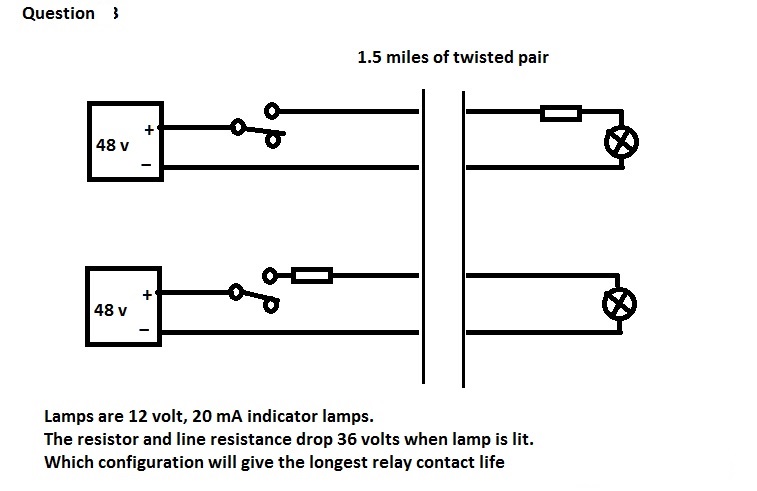

A question from the past.

That's a bit of a random diversion :whistle:
My answer would be that there's very little in it, but the lower option will have a very very slight edge.
At switch on, the resistor will limit the current pulse as the capacitance of the cable charges up. As a secondary effect, if the combination of source resistance and cable capacitance reduces the initial current, it will also very very very slightly reduce the current drawn by the lamp when it first turns on. Once capacitance charged and lamp hot, location of the resistor makes no difference.
As to what happens at switch off, well that very much depends on the characteristics of the cable and value of resistance. If there is any voltage spike due to interrupting the current (due to inductance of the cable), then the resistor will limit the current flowing through an arc as the relay contacts open.
And if someone sticks a nail through the cable, then the resistor will control the fault current - and if suitably rated would make the circuit safe from faults. Suitable rating and locations of local indicator lamps could differentiate between off, on and no fault, on and short circuit cable, on and open circuit. A single indicator lamp replacing the resistor could differentiate 3 states but would not differentiate between off and open circuit.
