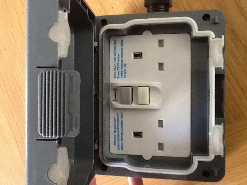

The reason that i have just asked these questions is because I was going to get an outside socket fitted (us doing the prep work and the professional to do the final wire) we got some basic advise from then local diy shop and because i thought we had a switch to cut off the electric to the sockets we were going to wire the outside RCD protected socket direct to the socket in the conservatory (i wanted to be able to cut the power outside from inside when not in use) until i noticed i could not cut the power to my sockets i then thought best to check as the wiring is not as i first thought.

With regard to my outside socket, this originally seemed like an ok basic/ish job.
When i googled it and spoke to my local shop the idea was to buy a socket that had the rcd plug already attached to it so just drilling a hole in the wall and plugging it in is what most were doing.
But i was given for free a socket with rcd protection the type with no plug attached. After speaking to others they said it would ok to just wire it up like an extension with a normal plug instead of an rcd plug.
That way sounded good and simple, the outside socket will be used for outside lights and lawnmower.
From what you have said about fitting a two pole isolator or a switched fcu for my socket is now sounding more in depth than i first thought.
Is what the others advised about putting a plug on the end not advisable or dangerous in this case?
It would be "better" to not have a flex going to your outdoor socket with a plug on the end, post a photo of what you were given but it seems you need a sparky on site.
Picture of my socket.
Shame its not going to be simple, what if i had bought on the sockets with the flex and rcd plug already attached would this be any easier to fit i.e drill hole through wall and plug it in
That way sounded good and simple, the outside socket will be used for outside lights and lawnmower. ... From what you have said about fitting a two pole isolator or a switched fcu for my socket is now sounding more in depth than i first thought.
Perhaps, but an almost trivial job for an electrician.
Having a plug on the end certainly isn't very nice, although it would be quite hard to find a reason for caling it dangerous. I would add that having outdoor lighting plugged into an outdoor socket is not very 'nice', either - it would be far better to have it properly 'wired in' (probably from the oudoor socket). One thing to be said for involving an electrician is that (s)he could check and (hopefully) confirm that your conservatory sockets are part of a ring. If, by any chance, they are not, then that probably ought to be investigated and addressed, regardless of the matter of the outside socket.
