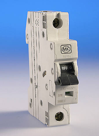

even with Method C, the largest standard-size MCB one could protect it with would be 10A.
,lots of pics of B16 MCBs)
Ah - I always forget about Table 4D5 :oops:. That's another anomaly of the regs - Table 4D2A says that the Method C CCC of 1mm² cable is 15A - but, as I presume your pictures are meant to remind me, Table 4D5 says 16A!
Whatever, as I said, I don't think that (in view of the assumed intent of Table 52.3) many people would contemplate using 1mm² cable for a circuit that required a 16A OPD. Are you suggesting that, just as a "matter of principle", we should start wiring, say, immersion circuits in 1mm² cable, given that most people would regard it as 'fairly obvious' that the intent of the regs was to forbid that?
