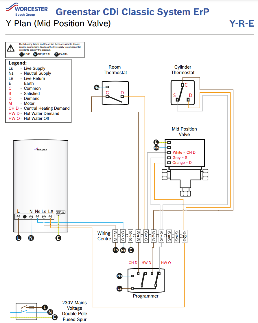

I've got a traditional central heating system with a 3 port valve, Y plan wiring, room stat, tank stat, and a Bosch Greenstar cdi classic boiler. I've noticed the boiler seems to be running a lot of the time, We've also got a frost stat setup(room and return pipe stat fitting into an outhouse with the boiler) to prevent freezing. I've just popped open the front cover of the boiler and noticed there are lots of connection to the boiler, not just live, neutral and earth, and a switch live. I was always under the impression you linked out the live and switch live on the boiler and let the external controls handle switching the boiler on and off, but with more modern boilers do they need some control of the system components and feed back from the temperature sensors so alter flow and return temps. Does the boiler just measure the return temp and switch off when the returning water gets to hot? or when the external controls say there is no call for heating?

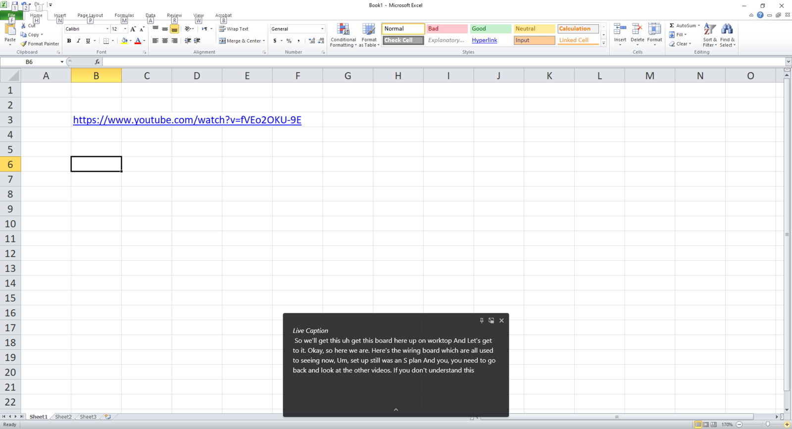

can't attach links from youtube. search for heatgeek Y plan wiring; there is a series of 4 vidoes on youtube; 3 are for S plan but part 3 is for Y plan. Watch it.
If you did that the boiler would constantly run with no external control, the switched live is controlled by the mid position valve and the MPV is controlled by the external controls
No.
There are no temperature sensors.
Thermostats are just on/off switches. So is the programmer.
It's the same basic on/off controls that have been used for decades.
That boiler can supply power to the rest of the controls, which means 2 extra wires as shown below.
However it's controlled with a single wire, Lr in the diagram.

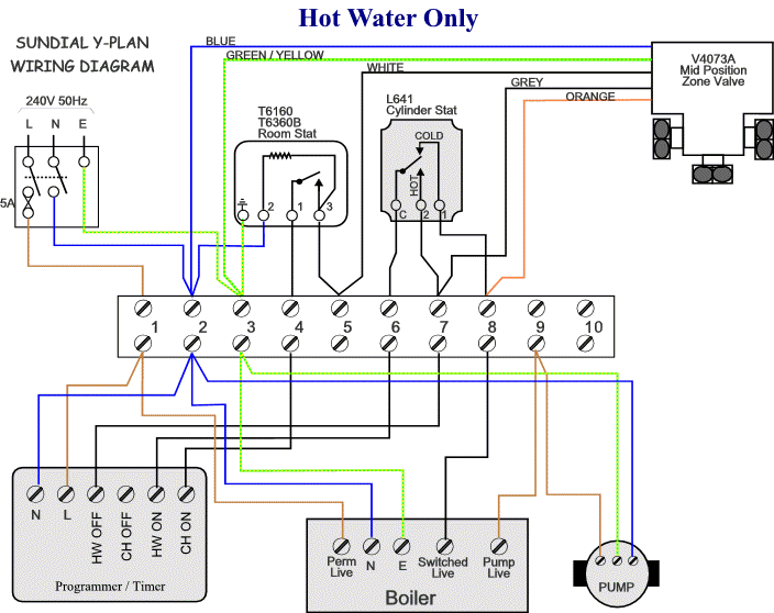

take a detailed pic of the "lots" of connections you can see in the boiler, As suggested the boiler would normally received a switched live (SL/Lr) from the 3 port valve, the live may be supplied via the boiler as above (may explain the extra wire) or the fused spur, via a wiring centre, depending on how it was wired on install.
I've been reading a lot online about boiler modulation and OpenTherm compatible, is that something my Worcester Bosch Greenstar 40CDi classic regular supports? Can't find anything in the manual or online, but it seems to have several spare connection inside the boiler wiring centre?
This is how it's wired up currently. To quote a well know Dr "Sorry for the crudity of the drawing I've not had time to do in properly!"

Yup, if anything I'd say there's an extra L (Ls) from the boiler that isn't really needed as the whole system is getting it's live from the FCU but it wouldn't do any harm.
