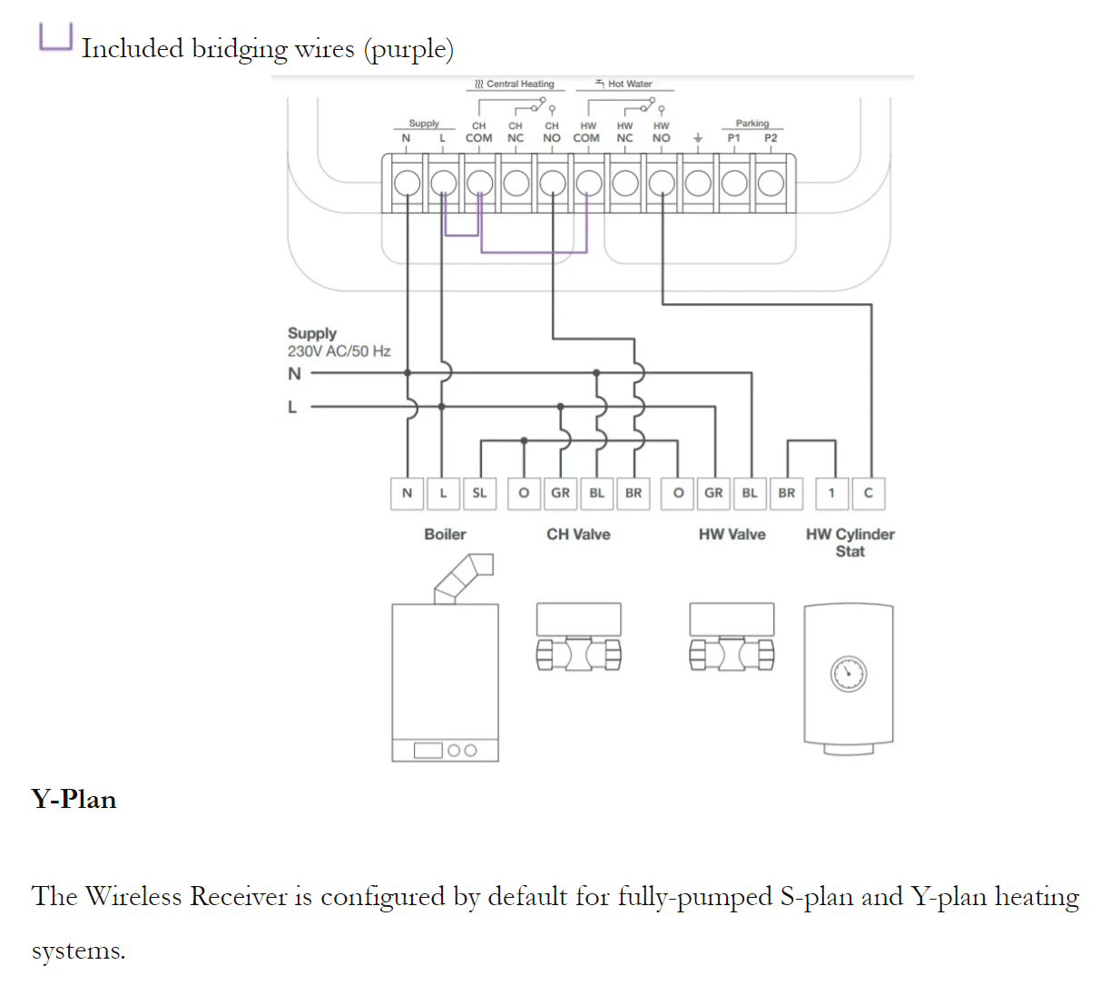

After much debate I opted for the Tado Wireless Smart Thermostat V3+ as it was compatible with my boiler and I liked the features. However, after asking for a configuration of my wiring from their support desk they informed me they couldn't provide instructions on wiring as I didn't have a separate thermostat. They told me it can be done but were not able to tell me how.

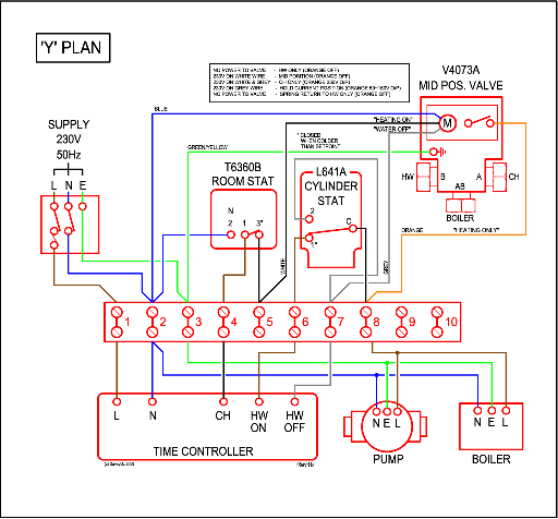

I purchased the Tado as I wanted to control both my heating and hot water which I can't do with my current Horstmann Centaurstat 7 controller. This acts as a room thermostat and programmer only. I know my system is a 'Y' plan and know that if I remove the Horstmann controller I will have to bridge between 4 and 5 terminals. What I am cautious about is the connection of the Tado Wireless Receiver to the 'Y' plan wiring hub. I have added the Tado wiring plan for reference. Any help would be very much appreciated

Thank you for your help but still uncertain about of exact wiring from the Tado Wireless Receiver to the ‘Y’ plan diagram. For example, the Tado diagram requires a live feed to the boiler but on the ‘Y’ plan diagram there is only a switched live connection.
If you’re unsure, might be best getting someone in. Y plan shows switched live. What is displayed is L and N, earth is omitted, whereas on the Honeywell it shows the earth connected.

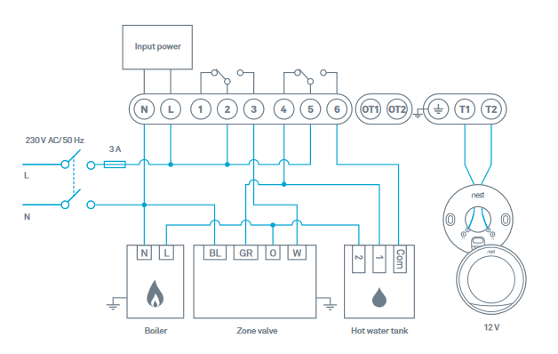

Nest Gen 3 show a Y Plan
I would have thought any other smart thermostat would work in the same way? However you need a N/C contact, with some multi-channel thermostats there is no N/C contact.
I know EPH does allow you to use OpenTherm and motorised valves, but most do not recommend OpenTherm when using motorised valves, I have read that it will work with Drayton Wiser, but Drayton say OpenTherm should only be used on a single channel thermostat, not sure about Honeywell Evohome, I note no connections shown for OpenTherm with Nest when using two channels, since my boiler is not OpenTherm enabled I am not really worried.
Of corse the boiler requires a permanent live, this has nothing to do with Tado, Tado is an external control and only sends power to the switched live

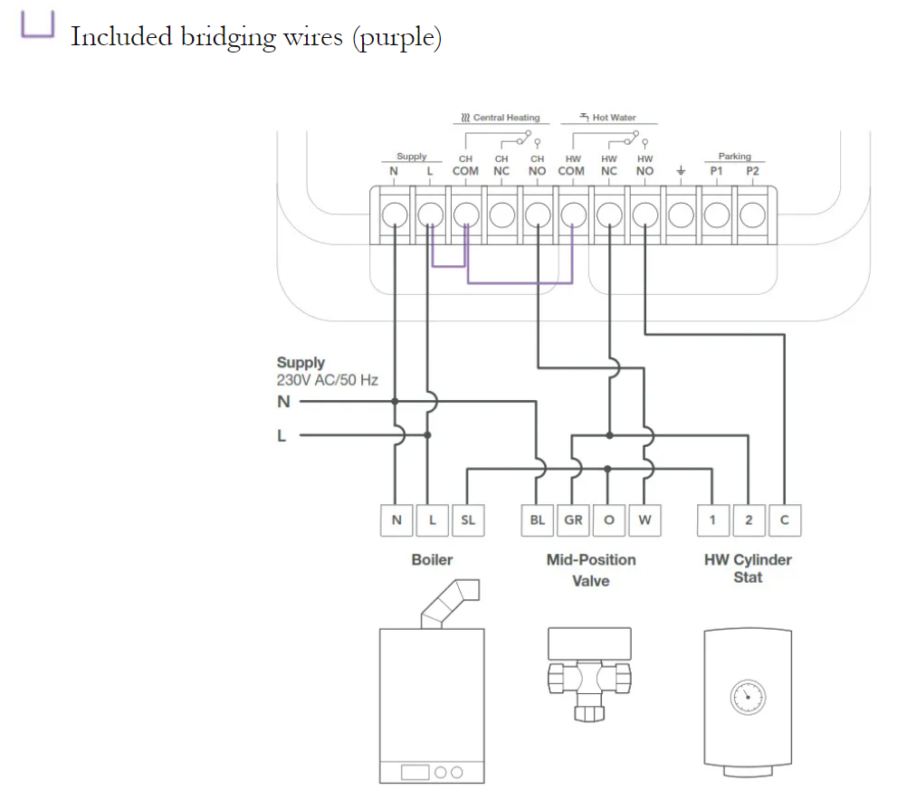

So after looking at the tado Wireless Receiver connections for a 'Y' plan heating system I have drafted this wiring diagram. Does this look correct?
NO it is very wrong , not saying this again, wire as per your post #3 and it will work just put a permanent live to the boiler Live and everything else will work , stop making things complicated just for the sake of it
the boiler needs a permanent live to control its functions , the tado is simply a coplicated switch that tells the mid poition valve where it wants it to be, the MPV then tells the boiler when to come on , nothing more complicated than that
You make it sound so simple, thank you. Can I just ask that when you refer to post 3 you are talking about the Tado wiring diagram and not the Y plan example. If so the Tado receiver also has a wireless thermostat which talks to the receiver and just wondering how that will show on the Y plan wiring diagram. Thanks for your wonderful help, it is very much appreciated
