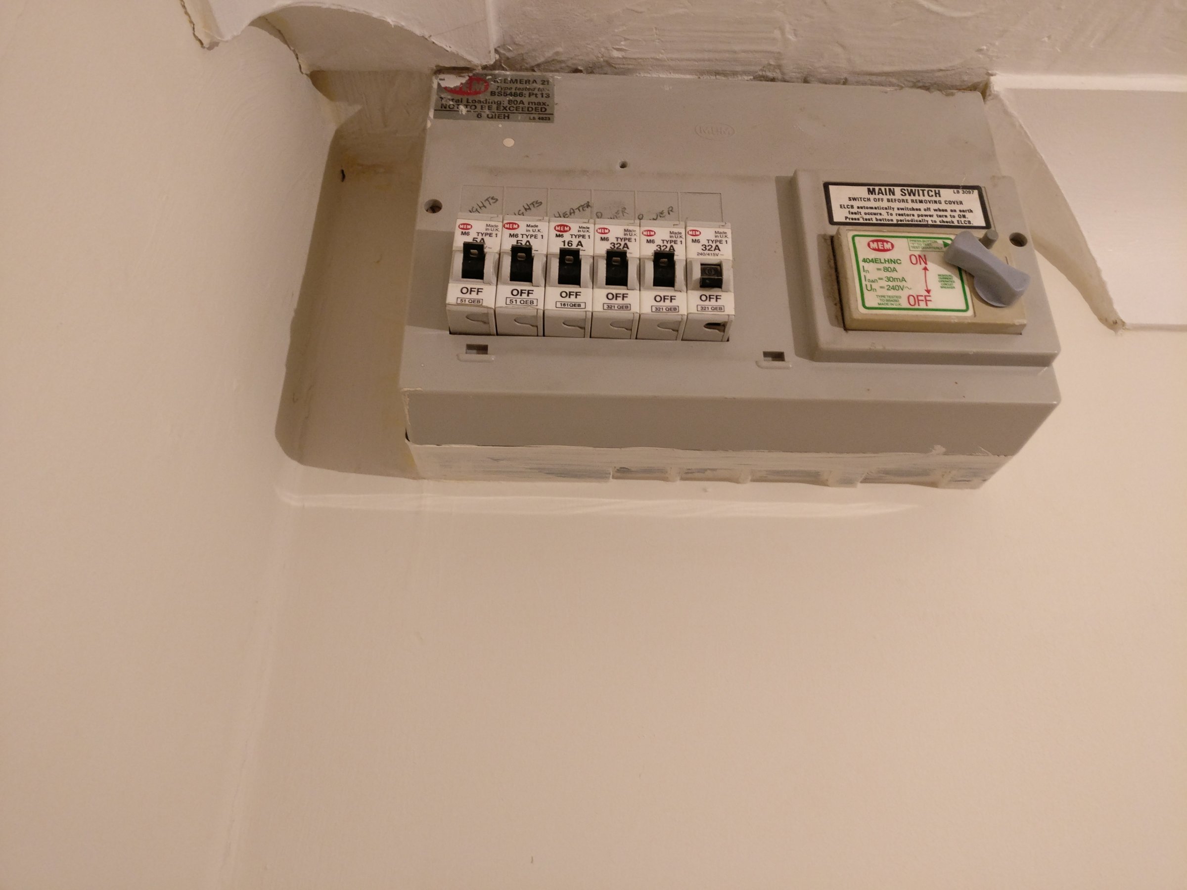

Terminate SWA armour outside and take just internal wires into house/CU?
Yes to the first, subject to running in safe zones as per other's suggestions.
Now that new domestic CUs are metalclad, it seems to me simpler to run SWA into the CU rather than interpose an adaptable box.
with regards to changing over to T&E, would you be happy doing this in an external junction box or should I attempt to bring the SWA into the house and terminate in a junction box inside? I fell like this would look messier inside so unless there is a strong reason to terminating outside to T&E would be preferable.
If it were fairly easily and aesthetically acceptably, I would personally prefer to have the junction box inside, and in the dry, rather than outside and exposed to the elements.
I would be very surprised if problems due to water ingress into external accessories (including JBs) was not far far more common than problems due to an additional 'unnecessary' joint in the cable!

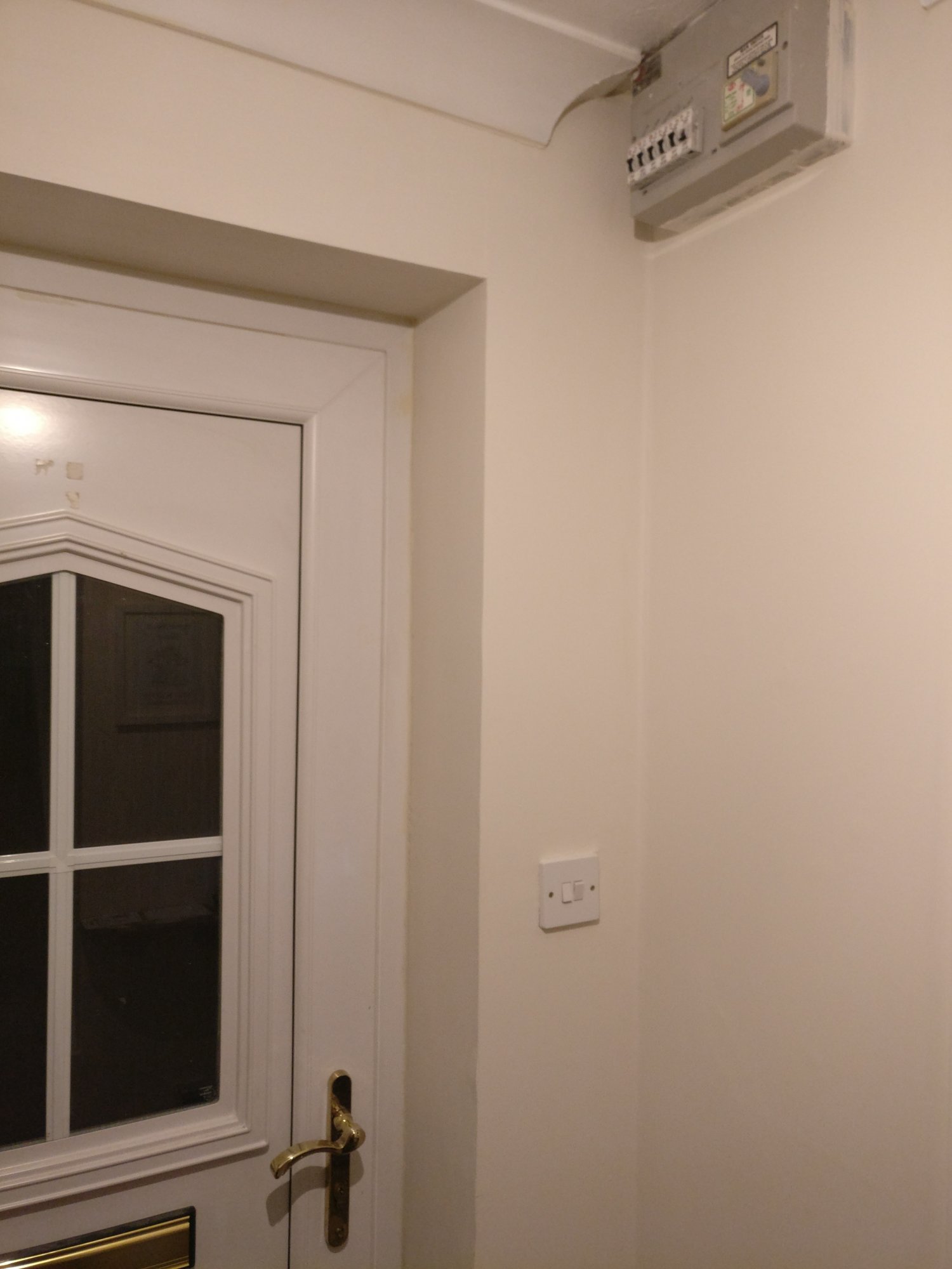

Any advice on how to hide the junction box inside? It is a masonry cavity wall construction house with dot & dabbed plasterboard on top. I plan to bring the SWA (OR T&E) in at ground level to avoid having an ugly black cable coming up the wall by the front door and then need to bring it up about 6ft to the CU at ceiling height preferably hidden out of sight behind the plasterboard.
If I understand correctly, if the CU is that close to the point of cable entry, I'd probably take the (full) SWA all the way to the CU, hence avoiding the need for any JB.
Cable entry 'at ground level' (if you mean that literally) is likely to present problems, with or with out a JB. If you would be prepared to have the cable going at least a few inches up the outside wall, you could then bring it through the wall into the back of a sunken backbox (housing the 'joint'), with a ('flush') blank plate over it.
Getting the cable (whatever type) behind the plasterboard may well not be a trivial exercise, and is likely to be at least a bit disruptive.

Thanks John,
I am happy for the cable to come up the wall a few inches, didn't mean ground level literally, just something like 6 inches above. The sunken backbox and flush blanking plate could be a good route to go, would look tidy and allow me to terminate the SWA outside of the CU to make wiring into the CU easier.
