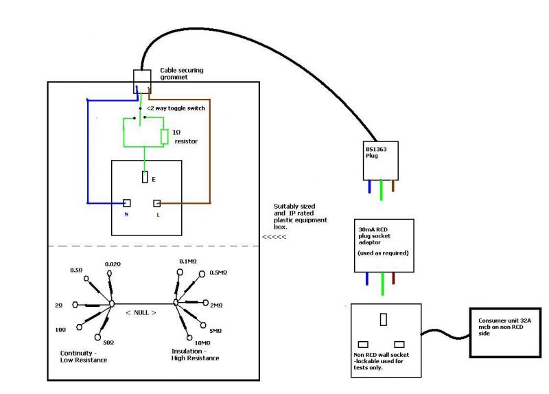

Hello,
Been giving this a little more thought and have come up with a little schematic/plan as illustrated below:
One of my problems is that i don't have any non RCD protected sockets in the house any more, however I do have a couple of spare ways on the non RCD side of my CU and so could set up a dedicated single socket outlet, possibly a lockable one so it only gets used by me just for test purposes. I do have a number of RCD plug adaptors still fitted to power tools, etc, so it would also be handy for testing these.
I know that you can buy commercial versions, but they seem to be just as expensive as the test instruments themselves. I plan to get my s/h testers calibrated once I've got a suitable check box either made or bought.
Any useful comments greaty appreciated, (especially regarding suitable resistor values/specification).
Looks good. IMO an RCD in the check box would be more elegant, but if you've got some plug in adaptors then that elegance comes at a price.
If you're going to use a dedicated socket you might as well use that for loop testing, and dispense with the socket & switchable resistor in the box - there's only any point in having that if you want to be able to use any old socket, and you therefore want to check that the 1ohm delta remains constant...
Resistor values - I'd try and get the high values up to 500M.
