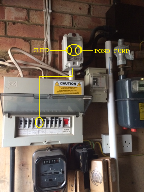

I have a shed at the end of my garden which I need to dismantle which has power going to it.
The previous owner wired up the garden and didn't label things all that clearly, so I have been testing trip switches to make sure I know what is powering what.
Below is the consumer unit in a brick building attached to the house.
The circled switch in the consumer unit below connects to the triple switch above it.
By flicking the switches, I have figured that the left switch connects to a small consumer unit in the shed at the end of the garden, the right switch connects to the pond pump.
Having checked and double-checked everything, the main consumer unit trip switch leading to the triple one will now not stay on - it won't remain in the 'on' position at all.
I am not sure if I have created a fault, or if the switch is faulty.
I have switched all switches to off (shed, pump and consumer unit in end shed), and still it won't stay on.
The switch immediately to the left of this one in the main consumer unit, when tripped, has definite movement on the small test button above it, the test button on the one that is now not working doesn't appear as obvious, but I can't believe I have damaged the test button from what I have been doing.
Any advice please - the pond pump is currently not working now!

It looks like an, rcd, have you checked everything connected to it is off or unplugged, if the truth is that you only turned it off and not tampered with anything, then it may just be a case of it dont like being turned on under load.
does it switch on ok with the switch above in the off position
That consumer unit is obsolete now so you wont get a new rcd to fit it if you wanted to

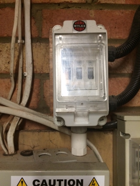

Can you post a closer pic of the smaller box above the CU

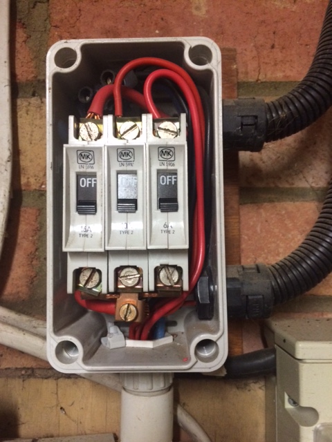

Do you feel competant to take the cover of the smaller box and get a pic of that
Turning off the main cu cuts the power, the rcd needs power to trip, so the rcd will reset ok, that indicates the problem is AFTER the rcd,or inside the rcd, so the circuits need breaking down within the smaller box to locate the cause
Pics attached.
As said, haven't touched anything, other than to trip these switches, the RCD on the House CU leading to this box and the CU in the shed.

The little 3-way wylex that has the shed and pond pump in it - what does the middle MCB control? The fault could be on this circuit and you're missing it by only assuming it's the shed/pump.
It's a neutral-earth fault if it won't reset with the MCBs off.

if so then its a possible neutral problem, that will be harder to locate as that small box looks quite compact to work in
the 3 mcbs only break the live conducters so although there off. the return neutral black wires are still connected to the rcd possibly stopping it resetting.
Does the water pump unplug, you say its switched off, but unless the switch is double pole, then it doesnt switch the neutral, if the pumps blown possibly by just stopping and restarting it, then that could stop the rcd resetting.

Power down the 3 mcb box and fish out the neutral terminal in the top.
Disconnect the outgoing neutrals from the incoming, then reconnect them one by one. You should find one that trips.

Just to elaborate on that last bit a touch - once you've disconnected all the neutrals - it should be clear which is the supply neutral, leave that in. Reconnect one, and attempt to power up. If it allows you to reset the RCBO, power down again. Remove that neutral, and move to the next one. You should find that one (or more) will not allow you to reset the RCBO. This is your faulty circuit and will require more investigation.
TBH my money is on the pond pump, or the unknown end of cable.
