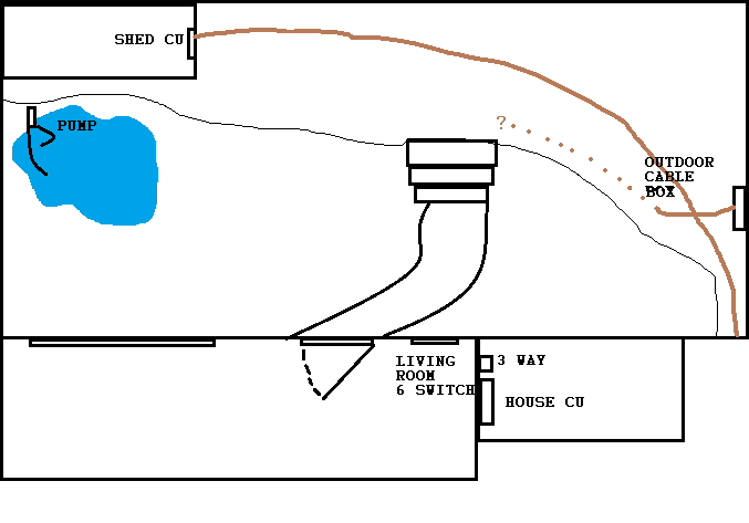

My mistake, it says out door lights NOT greenhouse (greenhouse is the rcd next to this one).
See picture below:
The shed CU goes back to the house CU. There is an outdoor box with an unterminated cable cable going to it which looks like it goes back to the shed CU from the direction it starts to go in, but can't tell for definite as it goes under ground.
The pump is where the pump is.
In the front room there is a six switch wall switch which controls a floodlight, some decorative lights, the pond pump...and the other three I don't know what else.

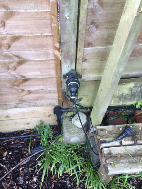

Pic attached of what looks like the external water pump socket. The loose socket on the bench has always just hung loose, the socket which is plugged in I have disconnected and still the RCD trips.
