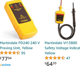

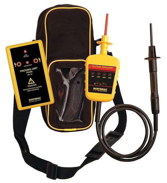

We see the testers, Tester and proving unit.jpgand we, or at least I, have been forced to use them, idea is can't be switched off, so not battery powered, and no switches, and the proving unit will show if it will not detect 50 volts AC or 75 volt DC.
But most of the proving units I have used, were well over 50 volts AC or 75 volt DC, so they did not prove the tester will detect over extra low voltage. About a good as a chocolate fireguard if they will not prove the tester will work on low voltage.
So if the proving unit is no good, is there any point using a tester with can't be switched, has no batteries, etc? Or if the proving unit is useless, may we just as well use our multi-meter?

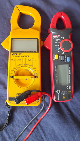

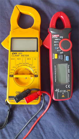

I have two multi-meters I use on a regular basis, Clamp-meter-small.jpg the yellow on will only measure AC current, the red one will do AC and DC current, and has non-contact voltage testing option, so between the two, can do most the testing I need, I have got a martindale tester as shown, and I have a battery pack with 230 volt AC output so could use it as proving unit, but why bother, using a neon screwdriver should an error be made, likely that will highlight error.
If I select wrong range it may damage the meter, but it will not damage me, I can't cause a short circuit with the meters even if on the wrong range.
So in real terms other than to satisfy some jobs worth safety officer, with low voltage supplies, is there really any need for the special proving for dead testers? I am sure, like the doctor's stethoscope around his neck, the volt tester around one's neck is more a badge of office than a tester which is really required.

I'm sure I've seen some proving units that step up through a series of voltages.
I also think that while "partial line" voltages are a potential threat, full line voltage is a far more common threat.
What worries me far more about "2 pole" testers is that they can't handle the "everything is live" situation. That is where tools like volt sticks and neon screwdrivers (where are IMO unfairly maligned by H&S types) shine.
and pretty much *NO* tester will tell you that a neutral wire will become live when you disconnect it!
I would have thought, if the clamp on shows no current in the neutral, then unlikely it will become line when disconnected, and using a neon screwdriver to disconnect with is also likely to give one a warning although not 100%.
I suspect that depends on the particular clamp meter. One of the ones suitable for RCD testing will probablly pick up any current that would give you a nasty shock. Some of the more oldschool models may not.
And not all wires can reasonably be clamped.
Since when disconnected, a neutral and was getting sparks from what should have been a dead cable, once bitten twice shy.
I understood your point, and the reasoning behind it, BUT, as I asked, since when was use of a clamp meter part of any guidance or teaching about how to #test for dead'?

I started using a neon screwdriver in the 70s after finding a socket live with the main switch off, it was feed from next door, and I have proved dead, only for the cable to become live, when a contactor pulled in, unless one spikes it, one can never be 100%. In the main, proving dead is done when one has no idea where the cable is fed from. In my case, removing the cables from an old batching plant, encrusted with concrete so no way to trace where fed from. After the incident, only done when new plant not running. All the testers and proving units in the world would not have identified that cable as live.
But most of us, I am sure, walk around with a multi-meter of some sort, in one's pocket, and most installations have more than one circuit, so easy enough to test the multi-meter. We start with the neon Martindale, but it gets damaged, so we replace it, we get a new LED version
but never even think about what happens if the batteries fail, so we get one with 0–400,000Ω Continuity and Continuity Test with Audible Results. And we have moved from the tester for testing dead, to a multi-meter. The rot has set in, next upgrade is

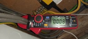

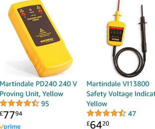

So I tend to use one meter for all, Diffrence line neutral 8 Feb 24 reduced.jpg OK next job I will need my VSWR meter, but we will always need the specials from time to time. But is using my clamp on really that much less safe as using the old testers? Voltage tester and proving unit.jpgThey were not that good anyway as it would not detect borrowed neutrals, and neons may not light with lower voltages, and it only delivers AC.
