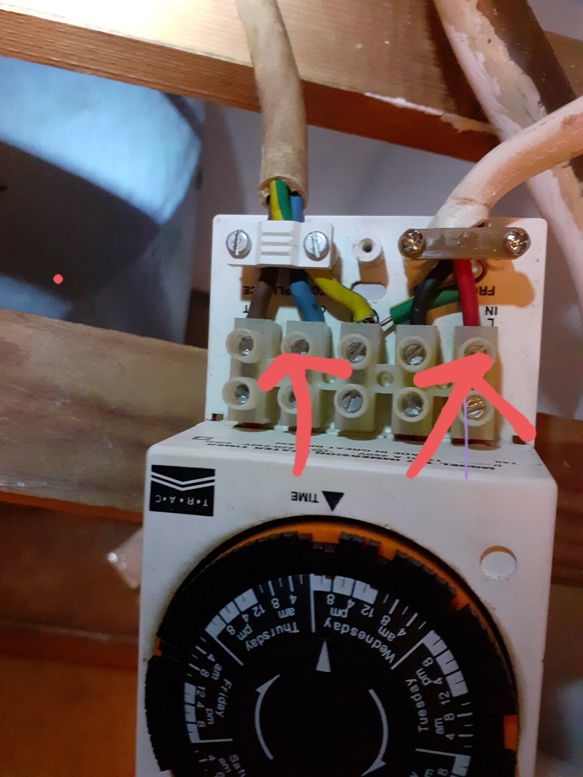

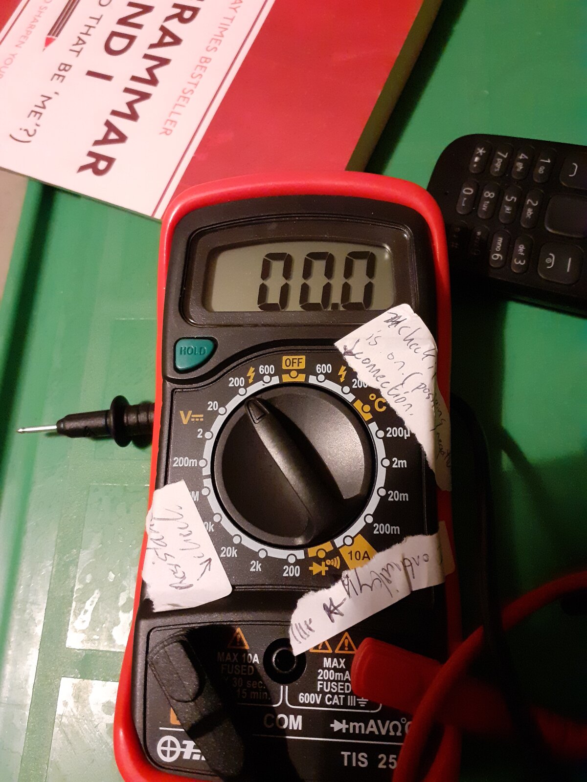

Using the multi meter on voltage setting (as in photo) dont you put the probes on positive and negative terminals to check it's live? Do you put them on the screws which hold wires in place (as in picture)to check? Trying to find out if the controller is live and also if it's working
Youve got it on a DC setting.
Why not just put a plug and socket on it, put the cover back on, plug in a table lamp, and rotate the dial to see if it turns on and off.
Surely the Red and Black are the input and the output is Brown and Blue
Positive and negative are terms used for direct current (DC). Your time switch works on alternating current (AC), so they are live and neutral.
Your meter is on a DC range, it should be on an AC range - turned clockwise to '600'. 600 and 100 are the AC ranges.
The live and neutral inputs to the time switch are on the right, the red and the black adjacent to it marked 'L in' and 'N in'.

As said wrong range, and leads in wrong holes, black and red in and blue and brown out.
Yes we did call it live and neutral, but today we call in line and neutral both are considered as live.
The cables need the clamps on them.
In the main the neutral is not switched, so likely a neon screwdriver would have worked better for you.

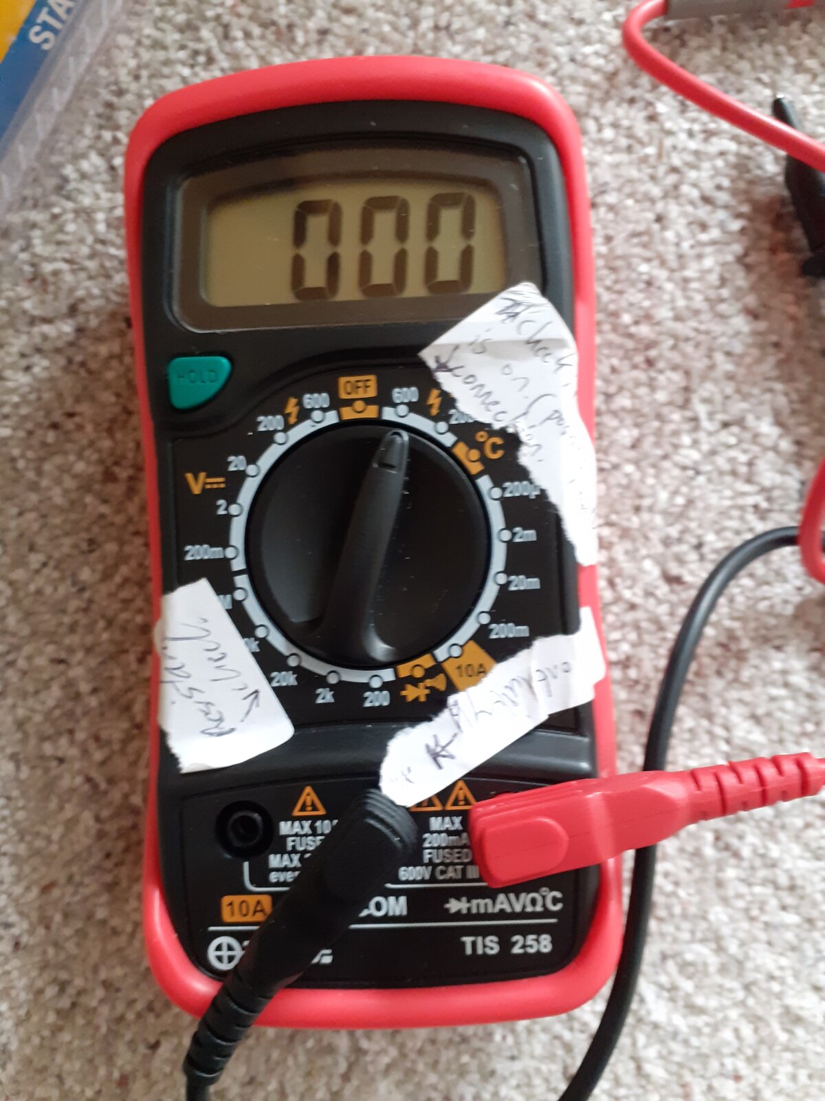

Is the meter set correctly now? And the black lead is in COM and red lead on the right outlet, is this correct? Is the red lead in the correct place?

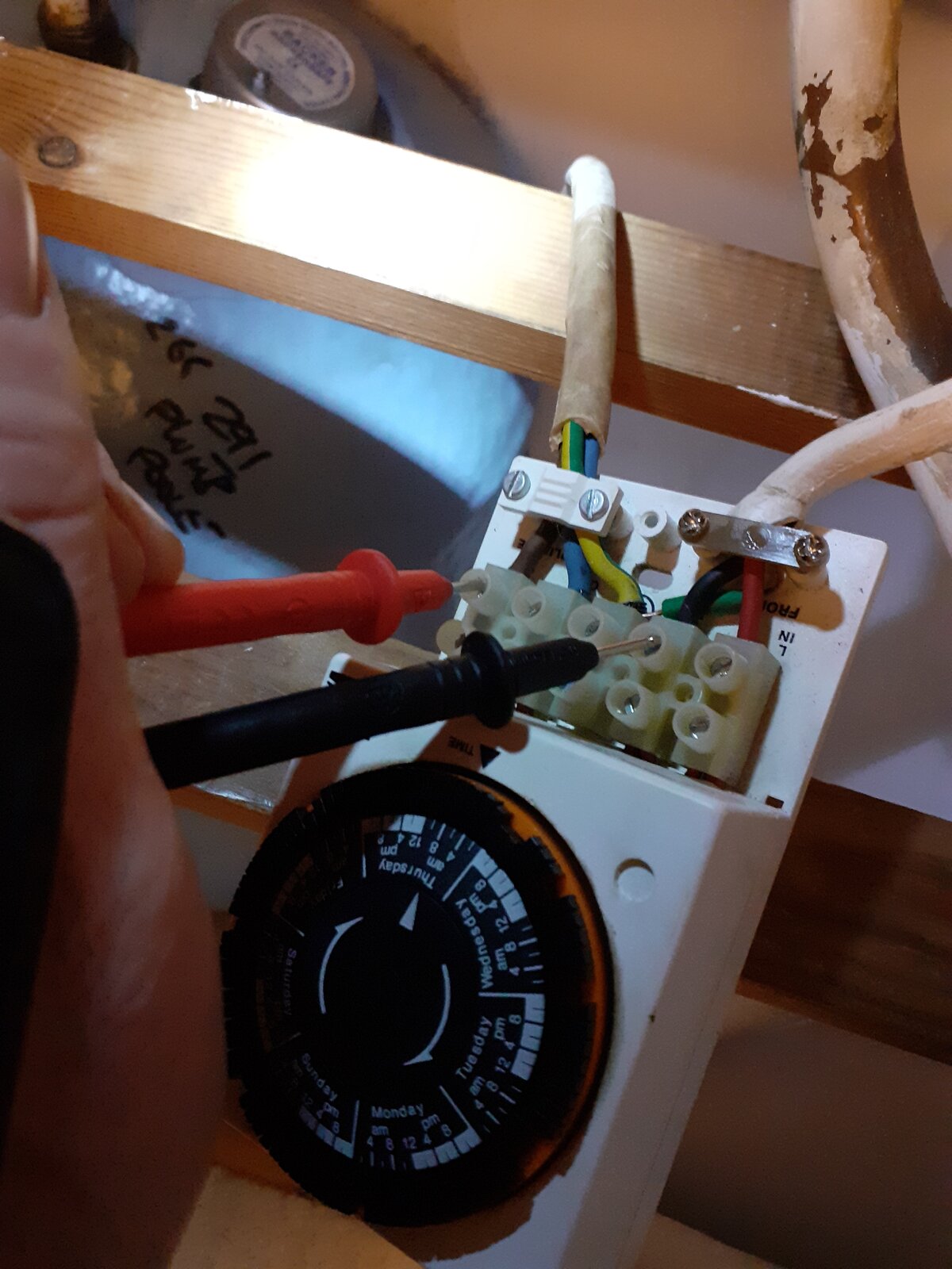

I think the controller might not be working. Using a voltage pen the inputting lead makes the pen light up but not output one. Where do i put probes on multi meter to check this inside controller to confirm ?
With the changed setting on meter I tried the multi meter on positive input and negative output on controller and got reading on multi meter BUT on neutral input and positive output ( as in picture ) there was no reading, does this mean the positive output isn't connected properly? I've found the wire too thick to fit in screw attachment u screw them into. Is it loose?
Black probe to black wire
Red probe to red wire.
Should be 230/240volts.
With timer in " on" position the following should give 230/240volts
Red probe to brown wire
Black probe to blue wire.
If the last reading doesn't give this voltage the timer is duff.
If the first reading doesn't ,it's a supply problem.

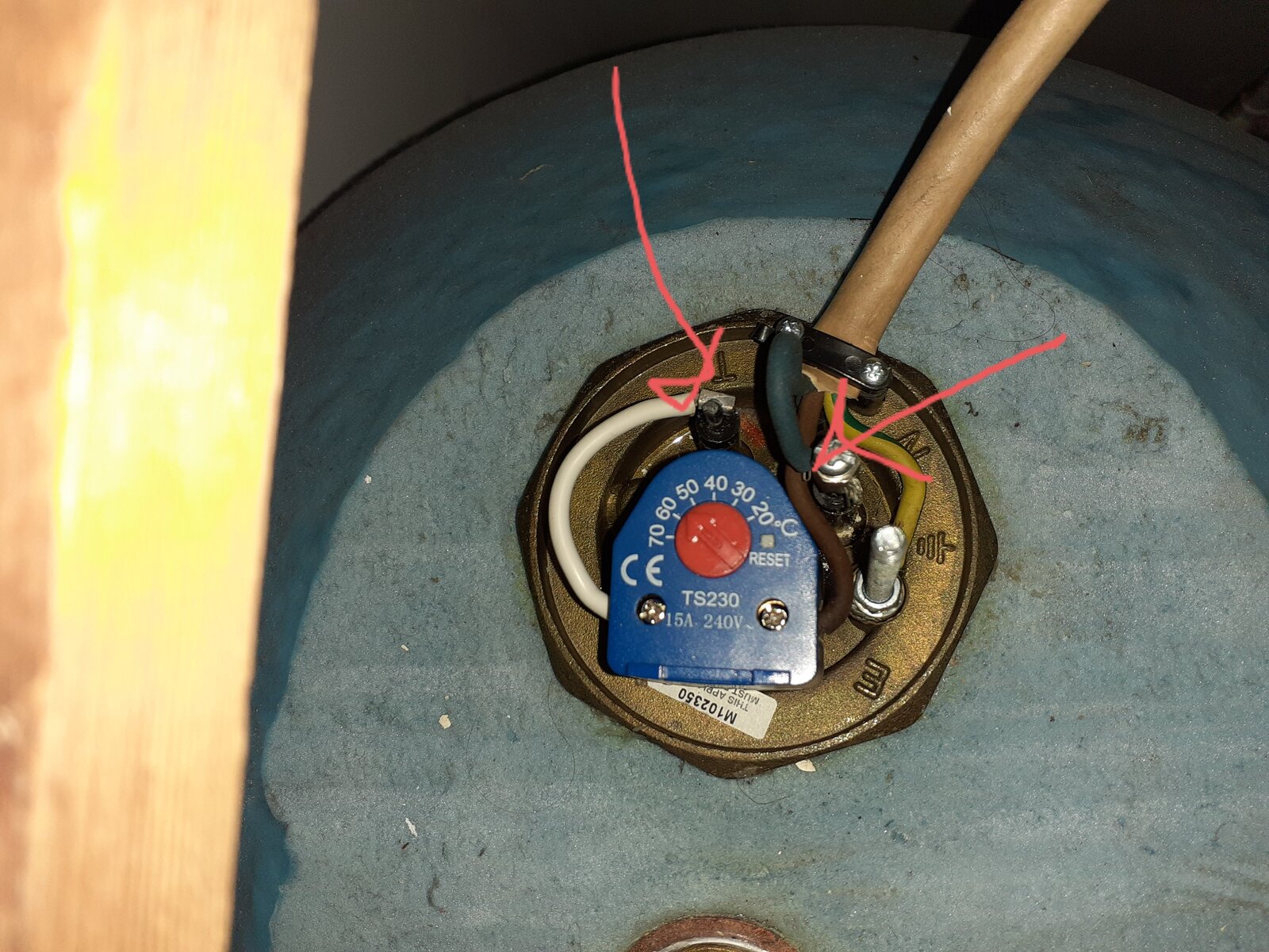

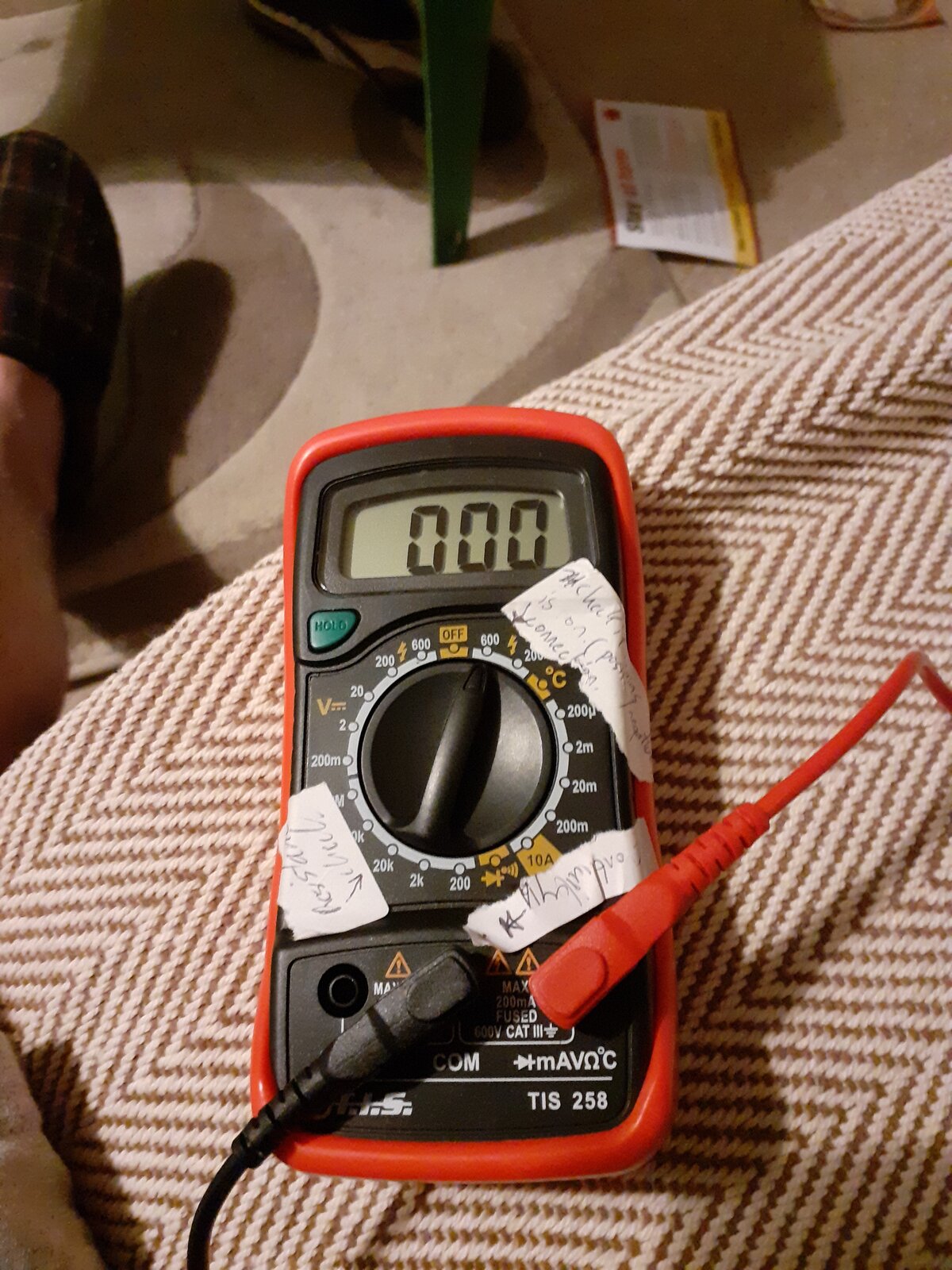

I did as you said on the controller and there was a voltage. I then went to the immersion and (with same settings) 600 AC (See picture) I believe have multi meter on correct setting I put red probe on white terminal and black probe on blue there was no voltage reading, does this mean the immersion needs changing?
With continuity setting the thermostat is working.
Test between that right hand terminal marked with your arrow and the right had terminal of the thermostat (that triangular blue thingummy). If you gets volts there, then the thermostat has probably tripped on over-heat. Turn the power off, then in your photo the thermostat has a grey reset button - try pressing that with a suitable implement.
If it clicks when pressed, it has been tripped.
