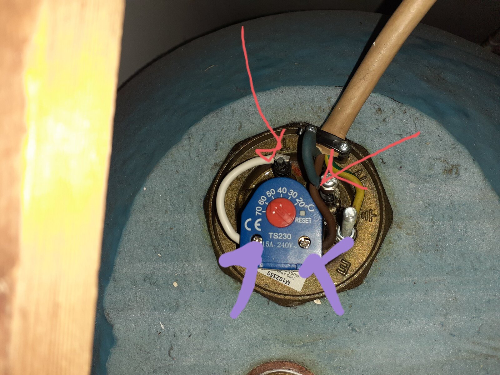

Is this done by setting multi meter to 600 ac as in previous picture on this thread then putting probes as in this picture (purple arrows- probes on thermostat's screws)? -
Using the multi meter on voltage setting (as in photo) dont you put the probes on positive and negative terminals to check it's live? Do you put them on the screws which hold wires in place (as in picture)to check? Trying to find out if the controller is live and also if it's working
Your above photo is so over size, I am unable to reply directly to it, but...
Yes on the 600volt range as before, black probe on top right terminal marked in the casting as 'N', red probe on the right thermostat terminal you marked with a blue arrow. With power on you should see around 240v on the meter..
Moving the probe to the left thermostat terminal, if you see 0v then it is not getting through the thermostat - which means it has tripped or is faulty. Try resetting it by poking the grey button in, maybe with you meter robe tip.
Yes to multimeter set to AC 600 volt range.
Black probe to the terminal on right side of pic,red arrow, ( this has the blue wire connected to it ) ,and red probe to left , red arrow,terminal with the white wire connected to it.
You should get 230/240 volts.
If you don't ,leave the black probe on the terminal quoted above ,and put the red probe on one of the terminals with blue arrow pointing to it ,the right hand one. you should get 230/240 volts there .
Did all that and got a reading - 16 on multi meter. I guess the emersion is working? The water is not heating up though!
The thermostat worked on continuity as well
