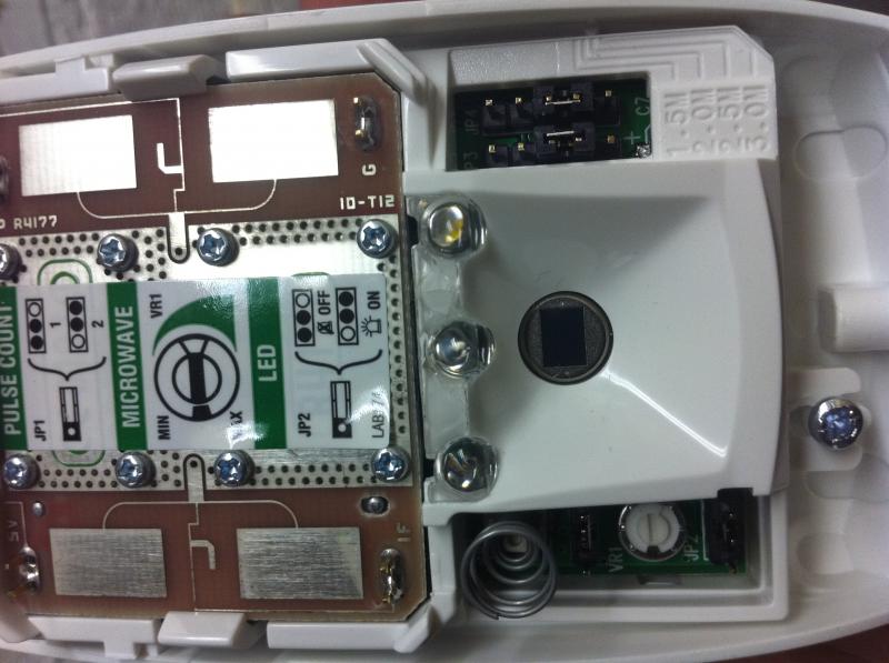

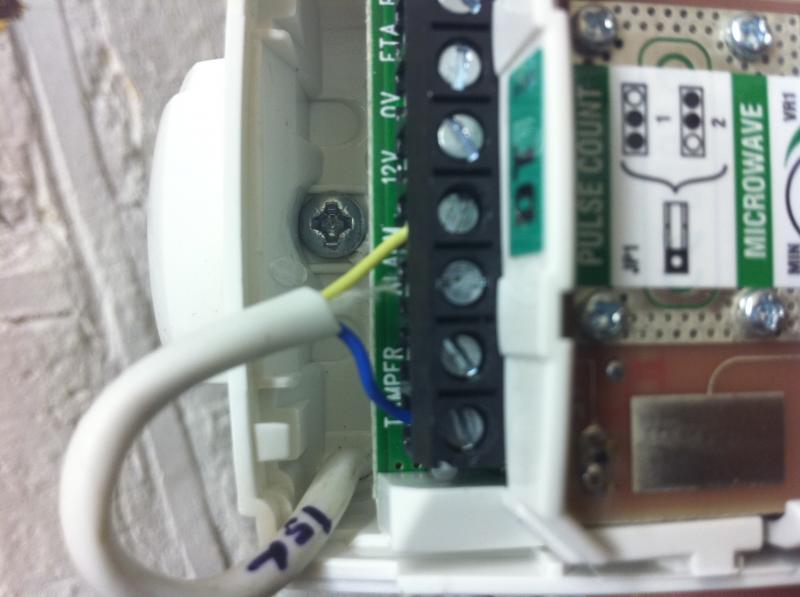

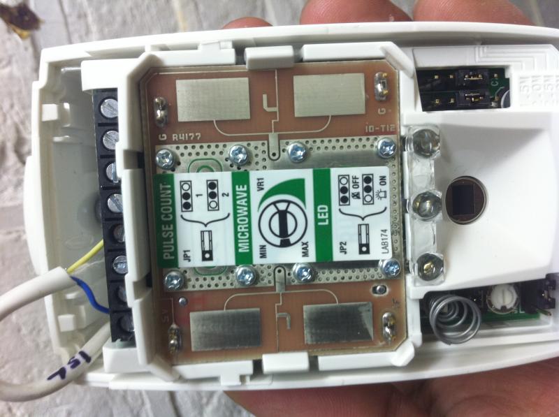

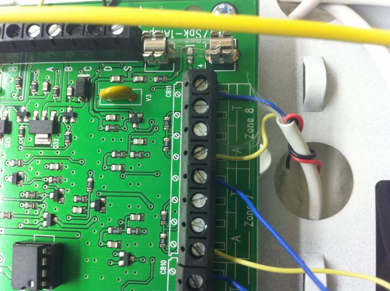

I get a reading from the PIR but when I do the walk test, it says nothing detected. Ive taken some pictures below on how the wiring is
Also still cant seem to get the wirelss expander working, sorry previously I meant to say all on Network 1 but RKP 3 as the other two keypads have taken RKP1 and RKP2
Im trying to do most of the configuring using Wintex, as you said its so much easier
dont really know texecom detection equipment, where are your resistors, or does the dtec have them onboard?? (if you're using eol which i assume yoy are)
where is the power for the dtec??
ok just read the whole thread, on board eol :confused: sorry
still dont see any power tho??
