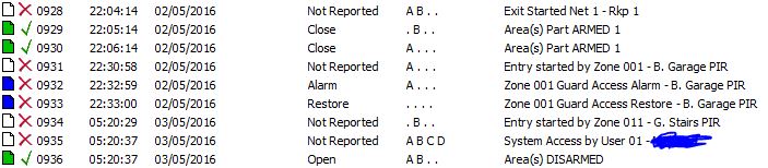

Premier 48 system - I have the garage set as zone A, house B.
A few days ago I set a part arm (downstairs of house plus garage).
A PIR in the garage triggered (there is a boiler etc in there, so maybe from the heat or something).
When I woke up the following morning, I could hear one of the keypads in the house was already beeping. Also once I got downstairs I received SMS from Text/Speech Dialler saying there was an intruder. Disarmed the alarm as usual.
So looking at the logs (posted below)
- shouldn't the garage trigger have put the alarm siren on? I definitely didn't sleep through it!
- why are the keypads beeping
- why would I only get the intruder SMS message when I walked downstairs in the morning, and not when the garage pir triggered

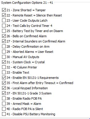

sounds like external bell on confirmed internal sounders on 1st alarm.
hi there
had an issue a few days ago where one of the PIRs in a garage was triggered by something moving in the garage, which caused the alarm to go off. The garage door, which has a door contact on it, remained closed. Both the PIR and the door contact are set to guard access.
I was expecting the alarm to only go off if both of them are activated (since this qualifies as the two zones), because I have global setting "26 - Bells on Confirmed Alarm" set.
I did not get an SMS (which I have set to send on "confirmed alarm" only)
does this make sense? do I somehow set bells on confirmed alarm per Area?

interesting, the same zone started the entry and then subsequently activated the same zone a few minutes later as a guard access.as the system was part set, I would have to check with Texecom the behaviour expected/desired.
I am not sure that the zone was a confirmed alarm in the sense of two separate zones being involved.
However we can see that the same zone started the entry and a few minutes later it was activated again but as a guard access zone, this would have been after the entry timed out.
what we can see is azone is creating a 2 minute window between first and second activations.which is probably your timer + the time required before it can be treated as an intruder and as I cant tell you the exact standards and how Texecom have interpreted them.
I suspect it shouldn't behave that way in that one zone giving bells on confirmed, even though there has been effectively 2 zone types violated.

I take it's nothing to do with option 35 being checked?
doh didnt see that last night, but you didn't get a text?
so still needs clarifying why it didn't send and why the confirmed didn't show and why it did confirmed on the same zone.
Yep I have set the digi output for thee text/speech dialler to trigger on Confirmed Alarm, and I didn't get a text. I doubt I got to the keypad before it managed to dial and connect to the SMS centre too.
Option 35 is worded like this in the manual (it's not clear if you tick it which on of the two options becomes active?):
35 - 1st Zone = Confirm
After the entry timer has expired, activation of 1 more zone is required to generate a Confirmed alarm.
2nd Zone = Confirm After the entry timer has expired, activation of 2 more zones is required to generate a Confirmed alarm​
So by ticking 35 does that mean a Guard Access zone can cause a Confirmed alarm, even though it is only one zone that has been triggered?
that's what I am saying needs clarifying.

So reply from Texecom (very promptly I must say, excellent service):
Configuration 26 and 27 only apply to full set operation, part sets will operate as normal even with these options enabled. As a workaround for this you could either turn your part set into an area or use the beam pair attribute on these zones, that way no alarm will be generated unless both are triggered.​
I'm tempted to just set all the zones in the house on Beam Pair... is there any obvious downside to this that I am missing? On full arm if I understand correctly it won't make any difference given I have options 26/27 set already, and on Part Arm it effectively forces two zones to be triggered for a confirmed alarm.
