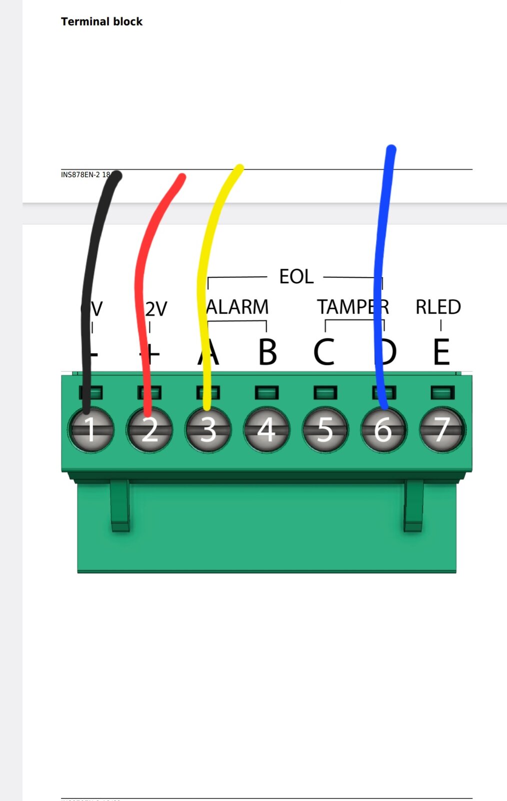

I’ve recently installed a premier elite 24 system and upon entry to the property there is no entry tone and the alarm won’t sound.
I get an exit tone, and when entering it says Area A arm etc but there is no sound on entry.
I have no door contacts and have the PIR on the entry hallway as entry/exit.
I have programmed via the keypad.
All PIRs pass a walk test, with a bell test also successful.
Could anyone give any advice on this issue
All active zones just have Area as A. in zone setup via the keypad.
Any other advice?
A correction to my original post - when I do the walk test via Engineer Utils it comes up with an error message of *NONE* but they have an LED on the PIR when walking past.
Capture P15 PIRs. When I activate the PIR, and review zone status it goes from 000R to 04K680 so believe it is resistors?
I’ll have to look at the jumpers on one of the PIR tomorrow but don’t think I changed any from the box.
Is there any other cause of why I wouldn’t be getting any resistance when closed?
Should be like this
