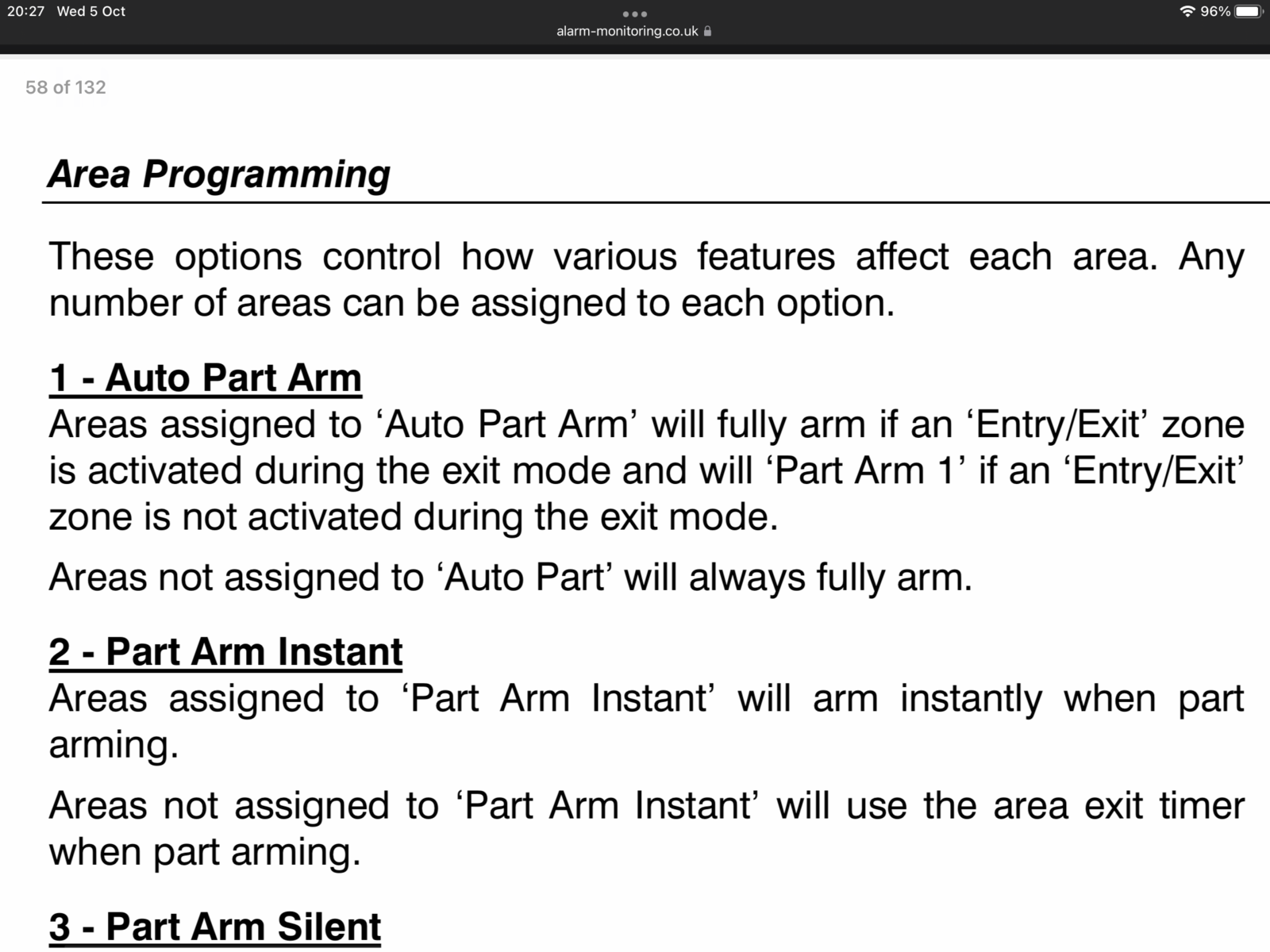

OK, I'll remove the area B text and panel sync.

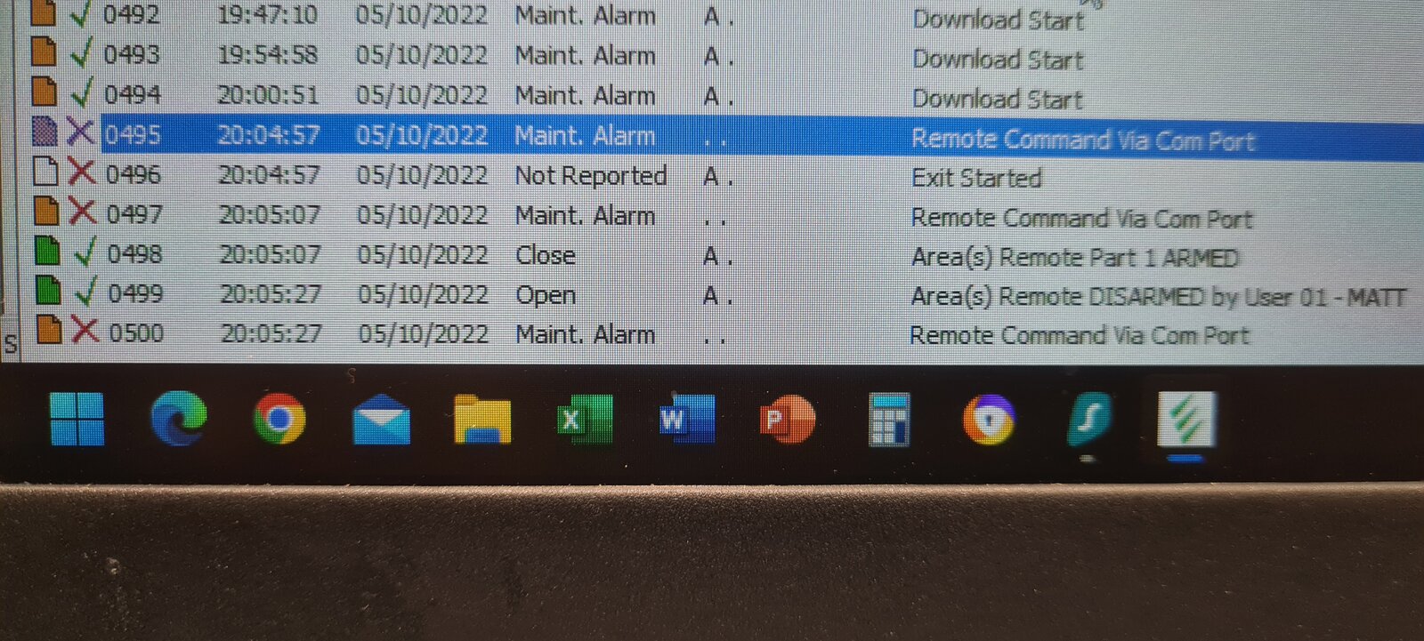

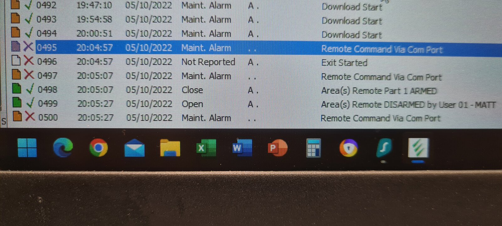

Meantime, here's a pic of the log from the full arm set I've just tried from the App. It does show exit started, but obviously it won't see that exit activate as I'm using the app and may not be at home at the time.
Full arm/red on the app clock display is from prox tag on exit.
"What is the button programmed for" - sorry I wasn't aware it could be programmed amd assumed the App always used the red button for full arm.

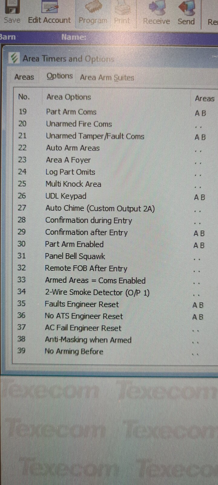

Any red indications your seeing are from prox tag sets only.
Area B text removed and panel sync carried out. It's tidied the App up, to only have one page/screen - thanks
Ta

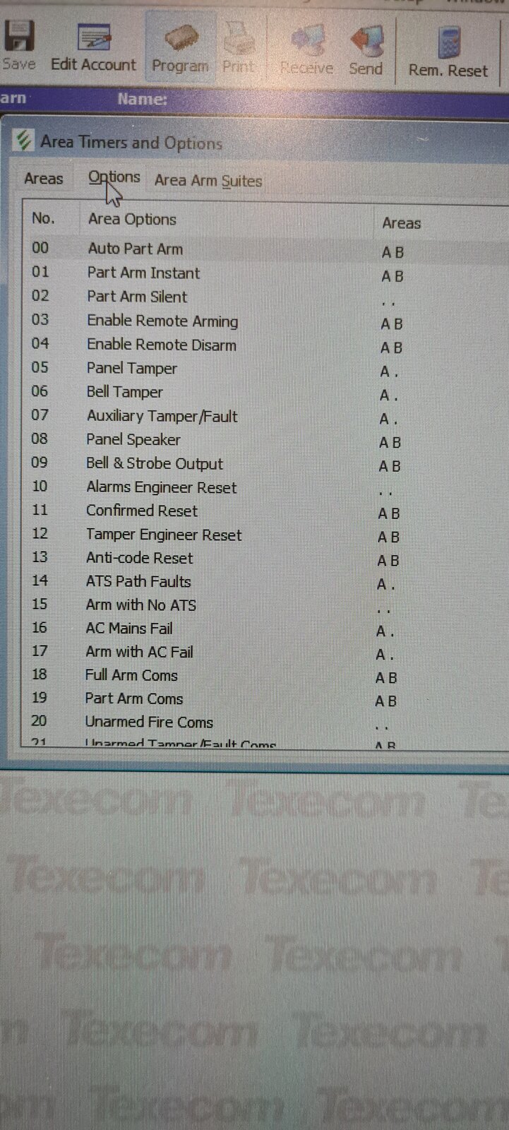

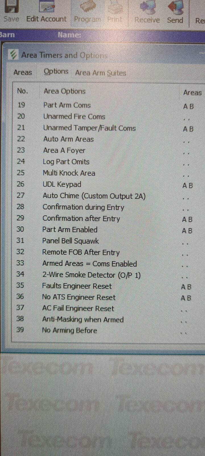

Hadn't noticed that until taking the pic lol. I have no experience of auto part arm and don't think I want it - if its what it says on the can.
We would only want to manually set part or full arms.
Should I deselect area B from all options and deselect auto part arm from area A?

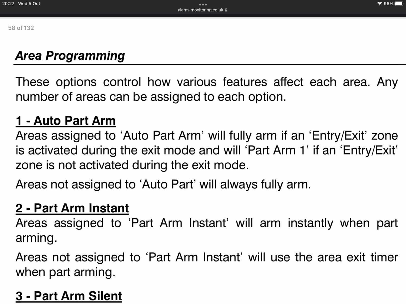

Is it easy to explain what auto part arm is please?
Ta
Read above …..but as described before …..if the alarm does NOT see the final entry exit door or device open then close it defaults to part set…. So for example a fob can be used to full or part set without further key presses …
Deselected, tested and obviously works as it should.
