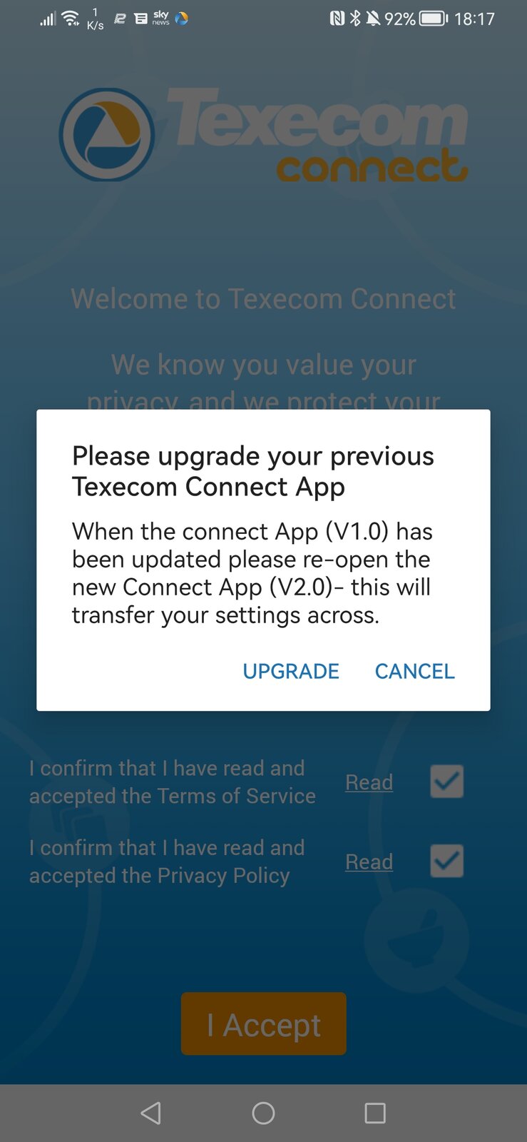

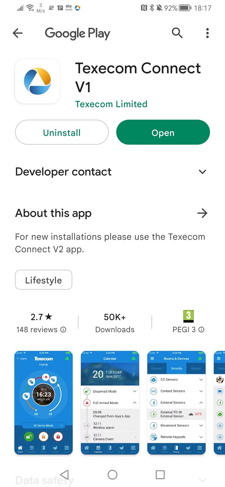

Apologies for jumping onto this post but I too have the handshake error on my Huawei P30 pro. It's only recently since having the error. My panel is Elite 24 with 5.02.01 and smartcom is 2.01 firmware I've downloaded the V2 app but cannot get any further than the attached pic. When I do click on 'upgrade' it just sends me to Google play store page. I'm unsure what to do as now I can't even log into the V1 app to transfer the settings. Any advice is welcome.

Firstly, I would set up a Texecom cloud account, add your panel to the system and then upgrade your firmware of the smart com to the latest version and we should be able to do this as your on version 2 of the smart com firmware.
if your unsure and free in the next 5-10 minutes I can look at this for you.
PM me, will need an app code less than 60 minutes old and the engineers ode

I can't set up a cloud account as it's asking for company name, company number and vat number which doesn't apply as I'm just an end user
